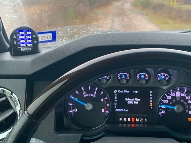

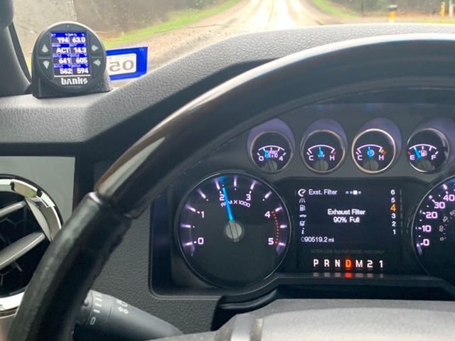

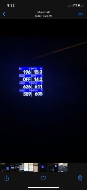

Well, I have some interesting info today. I made a quick trip from East Texas to Fort Worth around 3 this morning, then back around noon. Right around 5 hours and 15 minutes total drive time, running 85 mph there, and around 75-80 on the way back due to traffic. I took the first pic about 20 minutes after I hit the highway so everything would be at operating temp. The second pic was taken just before I pulled into my driveway. 2 1/2 hours of driving at 85 mph and my soot load increased by 16.5%. After making the same trip back, my Soot Load was up to 63%. That is an increase of 31.2%. The only difference was me running at a little lower speed. My truck sat parked at the house until I left. No idling whatsoever. One thing I now know, is that I get no passive regen at highway speeds. I was running empty though.
Upon my return, my mileage triggered a regen since it had been 519 miles since the last. My ghost screen showed my Exhaust Filter at 90% Full. My DPF Soot Load% on the Derringer only showed 63% though. 3 miles after it went into a regen, I had to turn off the road and onto a long lease road. I kept my speed between 10-20 mph the entire way down the lease road. My Soot Load % was at 43% when I first turned onto the lease road. After 10 minutes, it was all the way down to 0.0%. Definitely saw lower temps, but you guys were right about the length of time it takes and not needing to lock out 6th gear ever again. The peculiar part is that the regen stayed active for about 20 minutes after the DPF Soot Load hit 0%. My ghost screen only showed that the Exhaust Filter came down to 60% though. Now I'm curious as to whether or not it's going to trigger another regen when my ghost screen hits 100% Full.

My guess is when you hit 100% on the ghost screen it will regen again.
EGT's bring on the passive regens. Likely with the speed you were running the EGT's were probably there but the soot being produced out ran the passive regens.

Jsukey, any hills at all, some or otherwise on that trip on the highway? Texas is fairly flat, correct? I always see soot build up some on my way in to work as altitude decreases. Like a down hill run. The way home back up I see the passive regens happening. Interesting though.

I never noticed temps over 650 on any of the 4 EGT sensors. I just find it odd that the Derringer now shows my Soot Load% at 0.0% while the ghost screen still shows 60%.

Passive regens can be had around 550f. But likely you were or are always producing more soot than you can passive regen due to speed and not towing.
Towing would increase egts enough to over come the soot.
Good news is you went past the mandatory regen miles.
