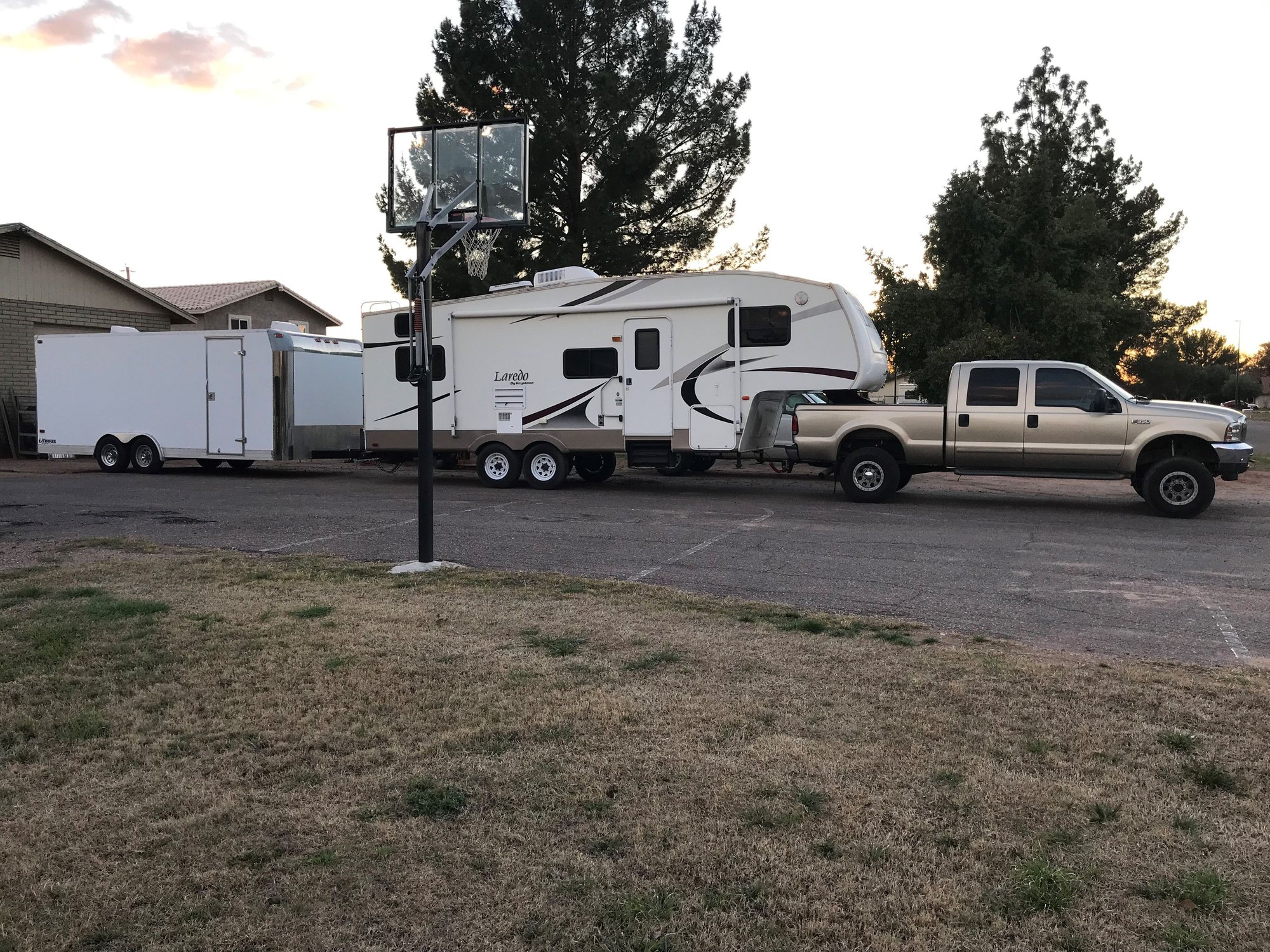

Has anyone added a second brake controller to their truck with the factory brake controller? I am setting up my new 2020 F450 to pull doubles like I did with my previous truck and I am concerned on how to go about this and not mess up the factory brake controller.
On my last truck I split all of the wiring other than the brake wire at the controller and shared the wires with the second controller. I ran a separate Blue 12 Gauge wire to the bumper 7 way plug and disconnected the factory brake wire from that plug so that plug was controlled by the second brake controller and the 5th wheel plug in the bed was controlled by the factory controller (in my 2001 that was an aftermarket brake controller).
So my concern is if I wire the new controller this way will this in any way mess up the factory sway control or ABS that is built into the factory brake controller? I was thinking I would make the factory brake wire going to the bumper 7 way a quick disconnect so when I am not pulling doubles and wanted to just bumper pull I could re-plugin the factory brake wire and then use the factory brake controller.
My setup is a 5th wheel travel trailer pulling a enclosed box trailer. Where my 5th wheel has a separate wiring harness that allows the secondary trailer wiring to be output at the end of the 5th wheel trailer then the enclosed trailer is plugged into that harness.

The reason I have to run 2 brake controllers is because I am towing 2 trailers. Since each trailer has a different weight I have to adjust each brake controller's gain to each trailer. If I used only one controller and had one gain setting for both trailers then I would either have to much or to little breaking for either trailer and could possibly have a jack knife issue during a panic stop.

I have done it a couple of times, farthest I have had to backup was about the length of a football field. My last truck was a 6 speed manual now that made it worse. I was out at a race track and the only place their was to park and camp was down a narrow dead end that I had to back out or drop one trailer and back each one out individually, I took the challenge and did without unhooking.

Old Jan 21, 2020 | 07:57 AM
