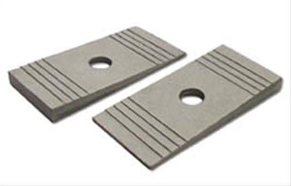

Since you have leaf springs, this is the easiest and best way to get caster. Every straight axle big truck uses these and you can get about any degree you want. If you are off so far these won't do it alone, use them and the adjustable ones at the upper ball joint.
He's asking about camber, not caster. Those shims won't help him at all.
