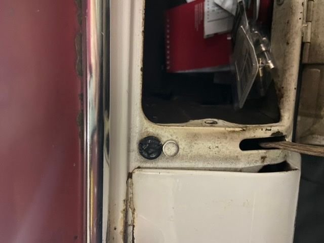

These are working very nicely.

no problem. If you change your mind, they are yours for the taking. These are what I have that work beautifully. Sorry the pics are sideways.
