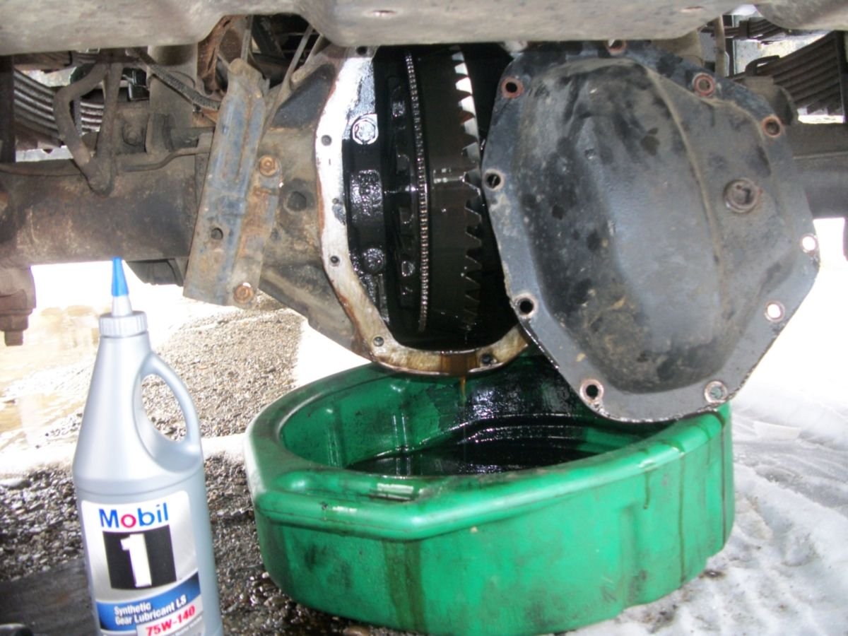

Here's the dually axle I put under her.Measured between the backing plates.
That applies to F250HD and F350 SRW (as they are the basic truck/same platform) to convert either to a dually.If the "dually rear" you find is not even close to that measurement then it came from a narrow f350 C&C dually truck and it's not going to work.
