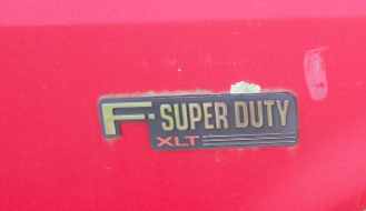

That's a different term. The term your thinking of is "F-series".
"F-Super Duty" was a unique truck,larger than an F350 but smaller than today's F-550. "F-Super Duty" was built from '87 though '97 and it was a 15k GVW rated truck.In '99 Ford would start calling their 15k GVW class "F-450" and drop the oddball "F-Super Duty" term.
It's a stupid term that just causes confusion today, even more so as Ford would go on to use the term "Super Duty" (dropping the F) to describe their '99+ HD F-series pickup line of trucks.I wish Ford never used it and stuck with F-450.

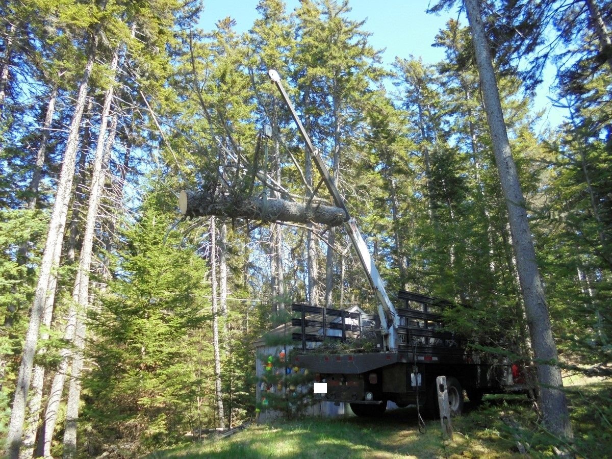

Here's mine;
Though they come in various wheelbases,mines the longest one plus it's been custom stretched an extra 3' so none of them were this long from Ford.That part of the truck is a bit outside factory but otherwise the same.

These trucks are easy to identify with their pickup size cabs,yet unique F-Super Duty fender emblems & 10 lug 16" wheels.
