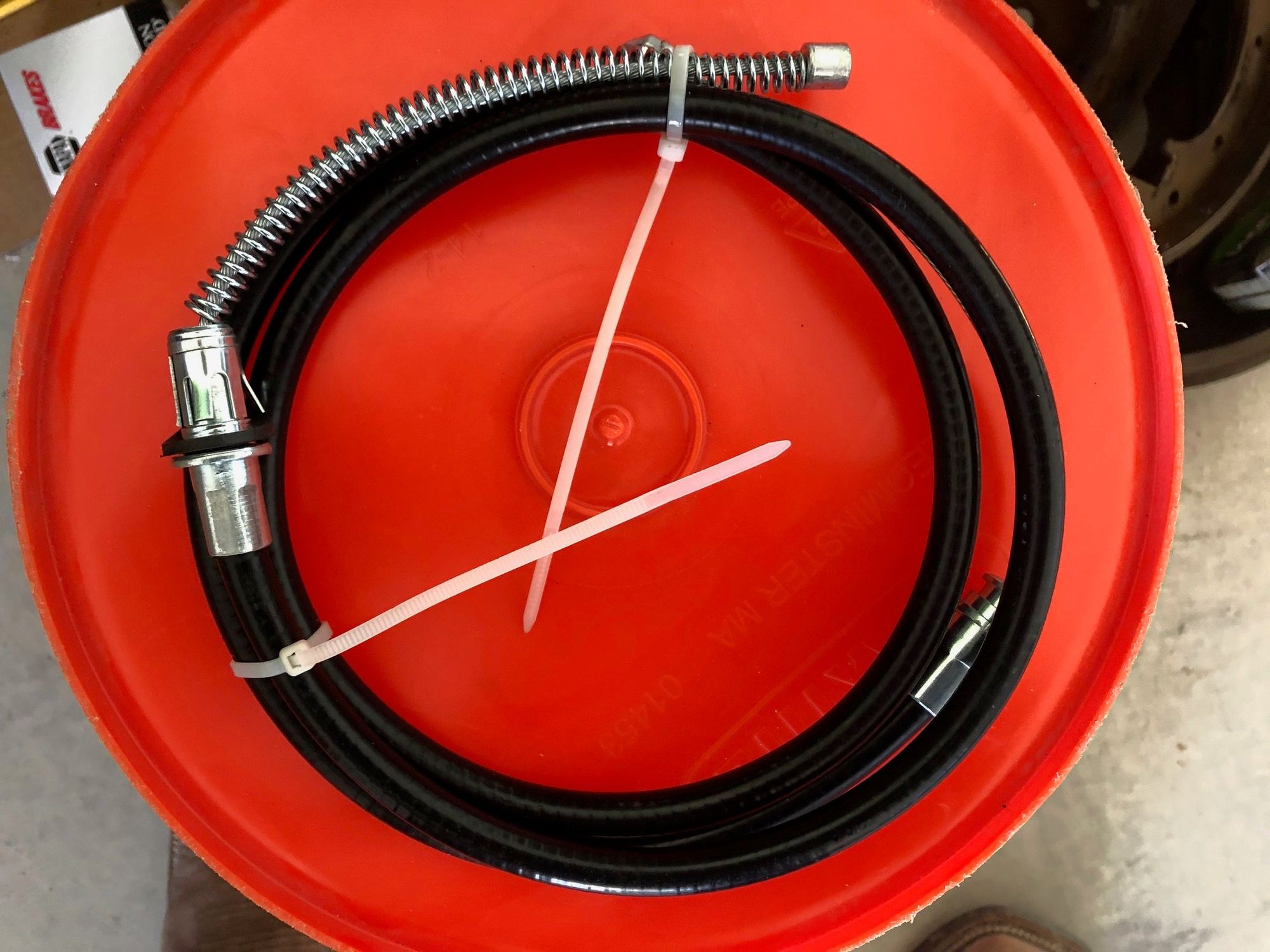

I'm replacing the e-brake cables on a 66 F-100. I purchased the Doorman parts from Speedway that were noted to be the correct application. They look slightly different.
The original cable appears to have a wire wrapping around the plastic sheath between the backing plate and where the balancer bar is located ahead of the rear axle. The doorman part appears to have some wrapping embedded within the plastic sheathing.
Has anyone used a similar part? Just wondering if they are correct.

It’s an aftermarket part built more cheaply than the original. If the overall length is correct and the length on the inner side of the backing plate is the same, it should work fine. In my experience Dorman parts usually fit, but are not as robust as the originals. Just make sure it is routed so as not to rub since it doesn’t have the very tough outer metal wrap of the original.

So overall length needs to be the same, and the length between the rubber washer and end needs to be same. Then just route to avoid any rubbing....
