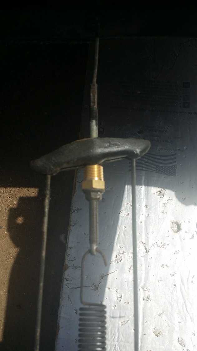

I recently adjusted my parking brake. My issue was the adjuster rod had some ground down threads and I didn't want to risk breaking the rod trying to force the nut cutting new threads. So here is my redneck fix, I used a brass fitting to get the nut back to the good thread section:
Not sure if this would help your situation.
Mike
Mike
I considered doing something like this, since I don't have a die hanging around to cut more threads. Seems a little iffy so I wanted to see if there was another option first.

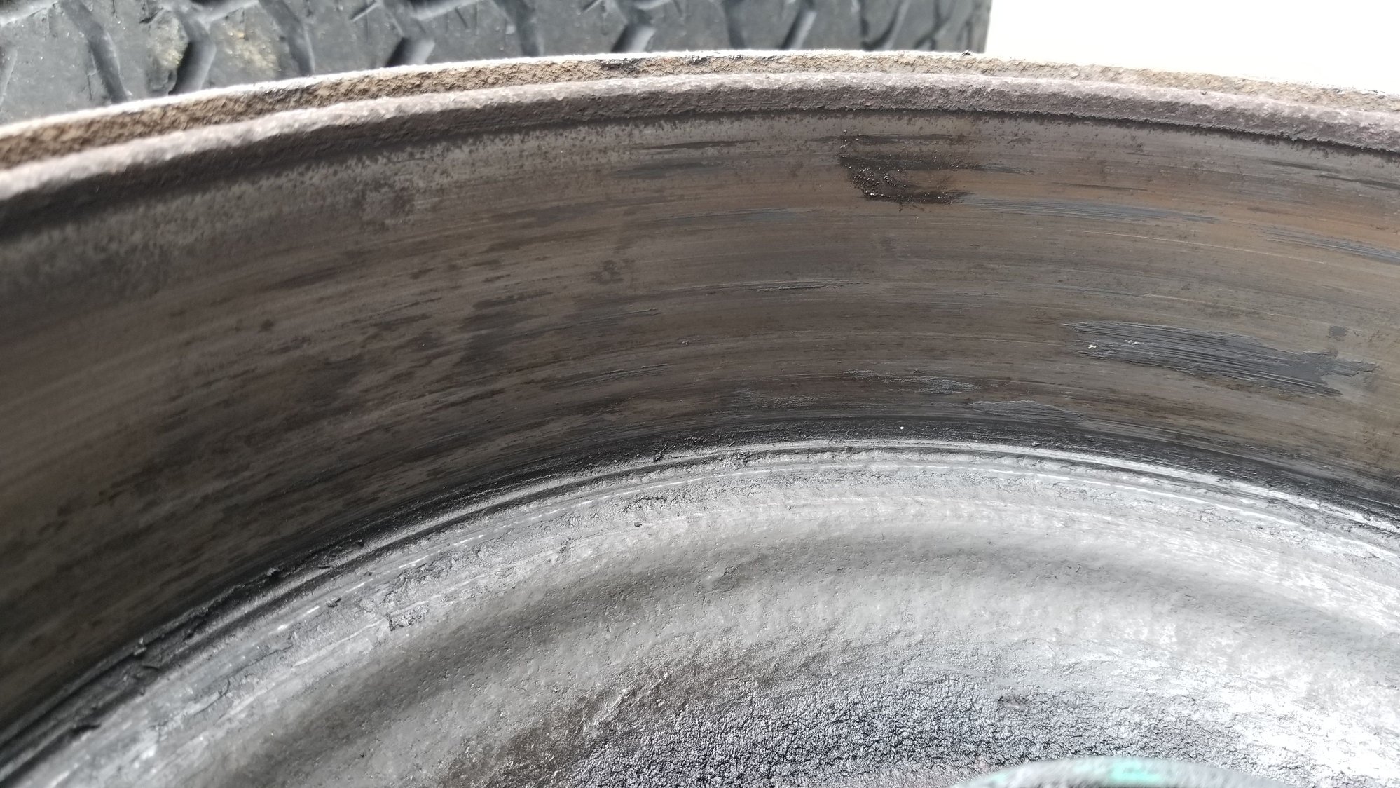

Well I'm glad I tore into the brakes, turns out the cable inside the drum came unhooked from the parking brake lever on the passenger side, which makes sense because whenever I applied the brake I noticed the balance bar would be tilted towards the drivers side (indicating the passenger side was loose)
​​​​​​While I was in there though, I noticed the brakes on the pass side didn't look like they're in too hot of shape. I did the whole rear end brakes probably 2000 miles ago, but I noticed weird wear patterns in the drum and shoe.
Any ideas to what might be causing this on a single side??
