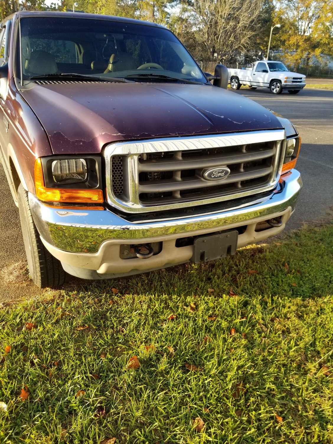

I tried several LED's in the stock headlamp and the pattern was horrible. These headlamps depend on a reflected flood of light from a 360* bulb. All the LED's I see out there are one sided. I tried flipping them in the lamp and it was worse. I got a better pattern and more light from a standard bulb. The stock reflectors are not made for a point type of light.

You don't state what year model your Excursion is in your signature, so I went to your profile page and saw that your headlights are the 2000-2002 oem style that have all the diffusers on them, unlike the 2003-2004 style that are a clear lens. I upgraded our 2000 Excursion to the 2003-2004 clear style headlight units in conjunction with the LED bulbs and it made a huge difference. So maybe that's your issue with not being able to get them to work satisfactory.
The only thing I don't really like about the LED bulbs...I have the units that have a flat blade which have 2 LED on each side...is the high beams are more to be desired. I haven't been concerned given the low beams light up way more area that the incandescent bulbs. Installing them I noticed one pair of the LED comes on for low beams and the other second pair LED comes on for high beam, and I would think all four would come on for high beams.

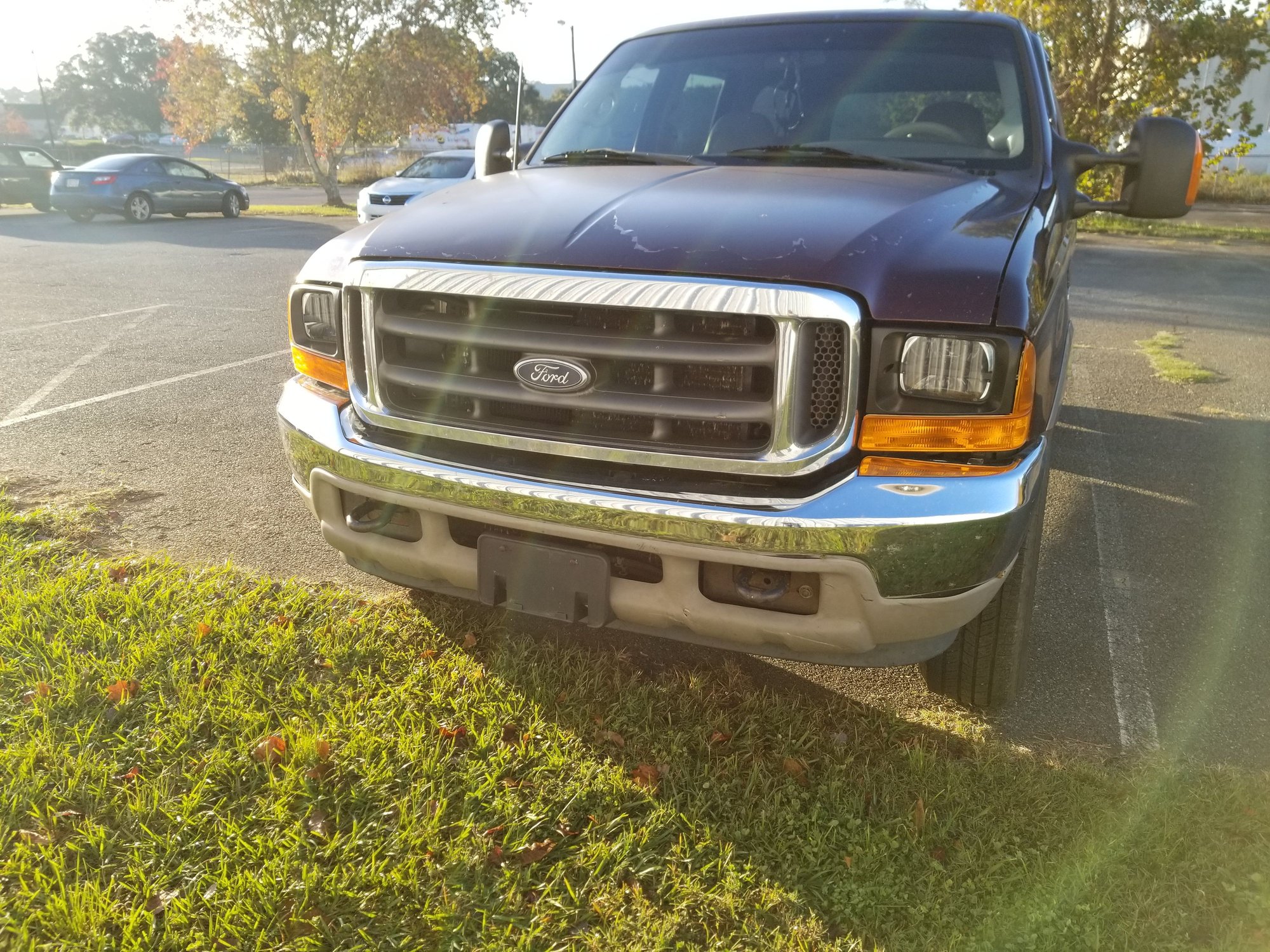

I did a sealed beam swap on my excursion. (look at my excursion build thread) and put truck lite 5x7 sealed beam replacements and they are worth every penny. you can see street signs a mile away on brights. But they go for 300 for the pair so might be out of budget. but I Love my new lights.

Plug and play bolt on swap. did it in 1 hour, could have done it quicker if i didn't have to paint everything, its my ocd.

I didn't get those so I Don't know the performance. but the truck lite part number HL11 are AMAZING. like having a light bar for headlights.
