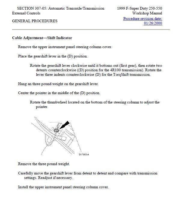

Yes, Here is the 99 model year manual on how to adjust. It looks the same as my 2002 manual as well.

Nope, looks a lot like a ranger/explorer cable ATP Y-1309 but I doubt it would fit in that bracket if it wasn't stock. The videos I've found for adjusting them have the wheel too...
My cable is different.
