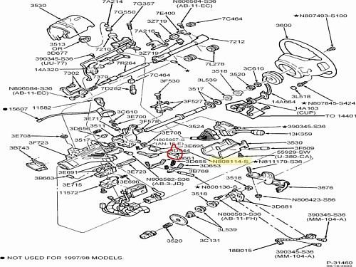

This same thing happened to my cousin's van. This mild steel pin will get distorted and not track properly when under any load.
Pin is 75 cents.

This is great info, Thanks so much, but I cannot see the pin clearly on your illustration... do you happen to have a link to it, or a higher rez image?

The link I posted for you has that same diagram a little bit larger along with one that has the parts list.
here is another from that page.
Tilt Parts For Steering Columns | Steering Column Services
