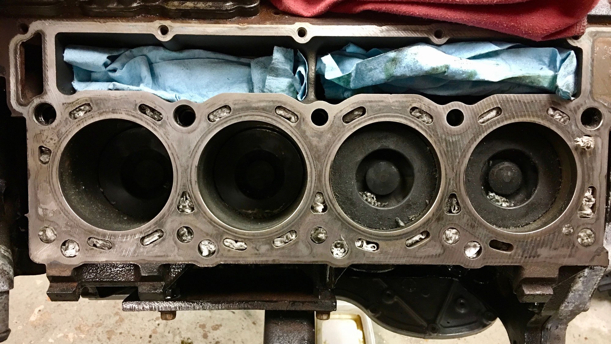

I just pulled my 6.0 yesterday and took a photo of the belt route before I removed it.

I pulled it and had it stripped down to the block in 12 hours, I’m getting fast...haha
I have some interesting photos of the decks after 5200 miles. I might start a new thread.

I had my engine out 6 months ago to lap the block and install “new” UCF o-ringed heads because I had been nursing compromised head gaskets for a long time. Did the first oil change since the work at 5200 miles and noticed diesel in my degas bottle which can mean one of two things. Cracked head inside injector bore or compromised injector cup. Sending the heads back to UCF today for inspection and replacement.
These aren't bad as long as your not trying to take a video of everything and don't walk away from the project.....often.
Look forward to the images.
After I did the cam piston to valve clearance checks with FelPro HGs moderately tightened down, you can see the traces in the right light and camera settings. They are different from the Ford gasket depressions.
And the OP is trying to figure out what the hell this has to do with putting on a drive belt .....
I'll delete this tonight.
They look like they cover more around the perimeter of the cylinder for sure! I may see if UCF will send me some Fel-Pro head gaskets.
