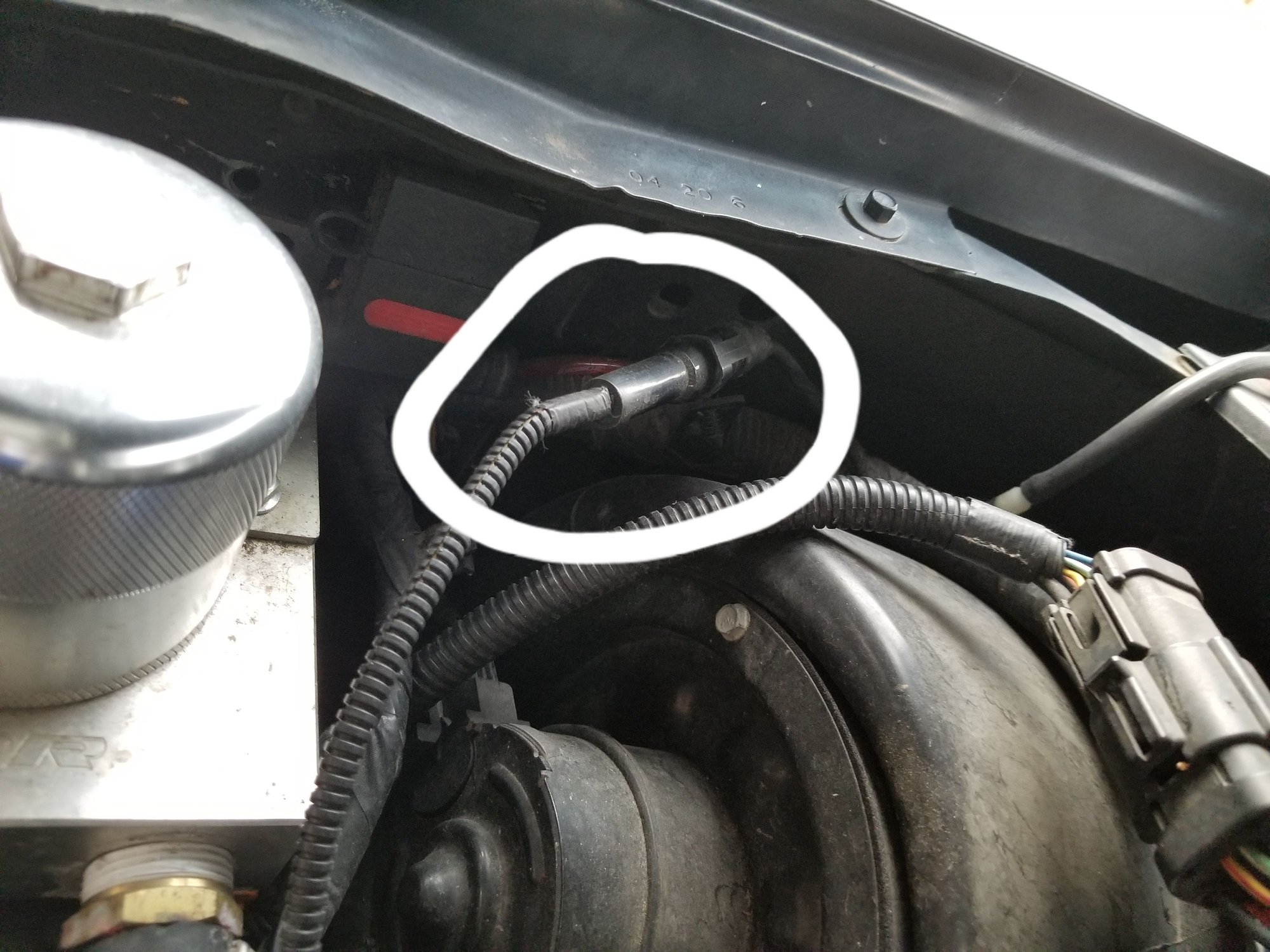

How does one crank the motor without starting? I need to fill the oil rails and don’t want to stress the FICM. Changed out the dummy plugs.

Disconnect that wire by pinching the outside center. Hold the connector terminal on the positive battery post.
Additionally: that's on the passenger side fender.

Or pull the FICM relay and fuel pump fuse, and crank with the key... I don't know if that cranking wire will command the IPR valve to flow oil.

You can either pull the FICM relay and crank with the key or use that starter solenoid wire. By using the key and yanking the relay, the IPR valve will remain energized and put the maximum flow of oil to the oil rail to purge the air out sooner (thus minimizing wear on the starter if nothing else).
