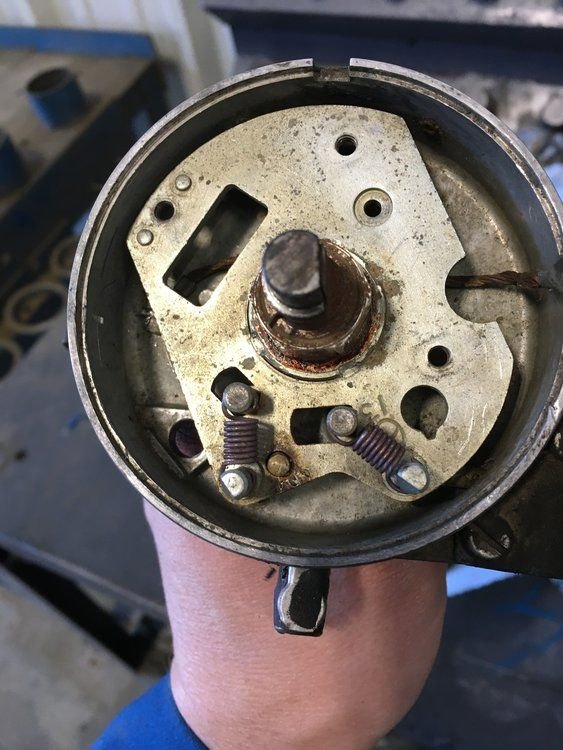

Oh my....I think I figured out the issue. Was talking to a Co worker and was showing him pictures and noticed something....
I'll update tonight

Bet it is this one with the ground lead to the breaker plate, screwed to the body of the distributor, and the other end just hanging in air.
Left end screwed to body, right end with no connection.

It can't be that, I mentioned this three days ago in post #4

So it was the bare ground wire inside dizzy, I had it hooked up to the points stud vs the points hold down bolt..... Man what a silly thing to miss.
Ah well, i appreciate all the help!
Time to move on to the next step in the project
