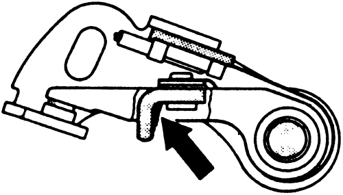

IMHO what ever fried your coil also hurt the points eliminator kit. Or vise-versa. In the past few years there has been a few bad Accel brand ones. If it were me I'd buy GENUINE FORD (MOTORCRAFT) points and condenser and install them. NOT AFTERMARKET! The aftermarket condensers are JUNK. Along with an aftermarket new cap and rotor. I bet the truck will fire right up as long as the points are adjusted and greased correctly. If this does prove the Accel kit is bad I'd order a Pertronix brand one. The truck is running with the points so you would have time to get in the Pertronix.
Ford (Motorcraft) part numbers still available.
B8Q12171A (DP12)...points.
C9AZ12300A (DC13A)....condenser.
Area on the new points to put a dab of dielectric silicone grease (same as disc brake caliper slide grease).
