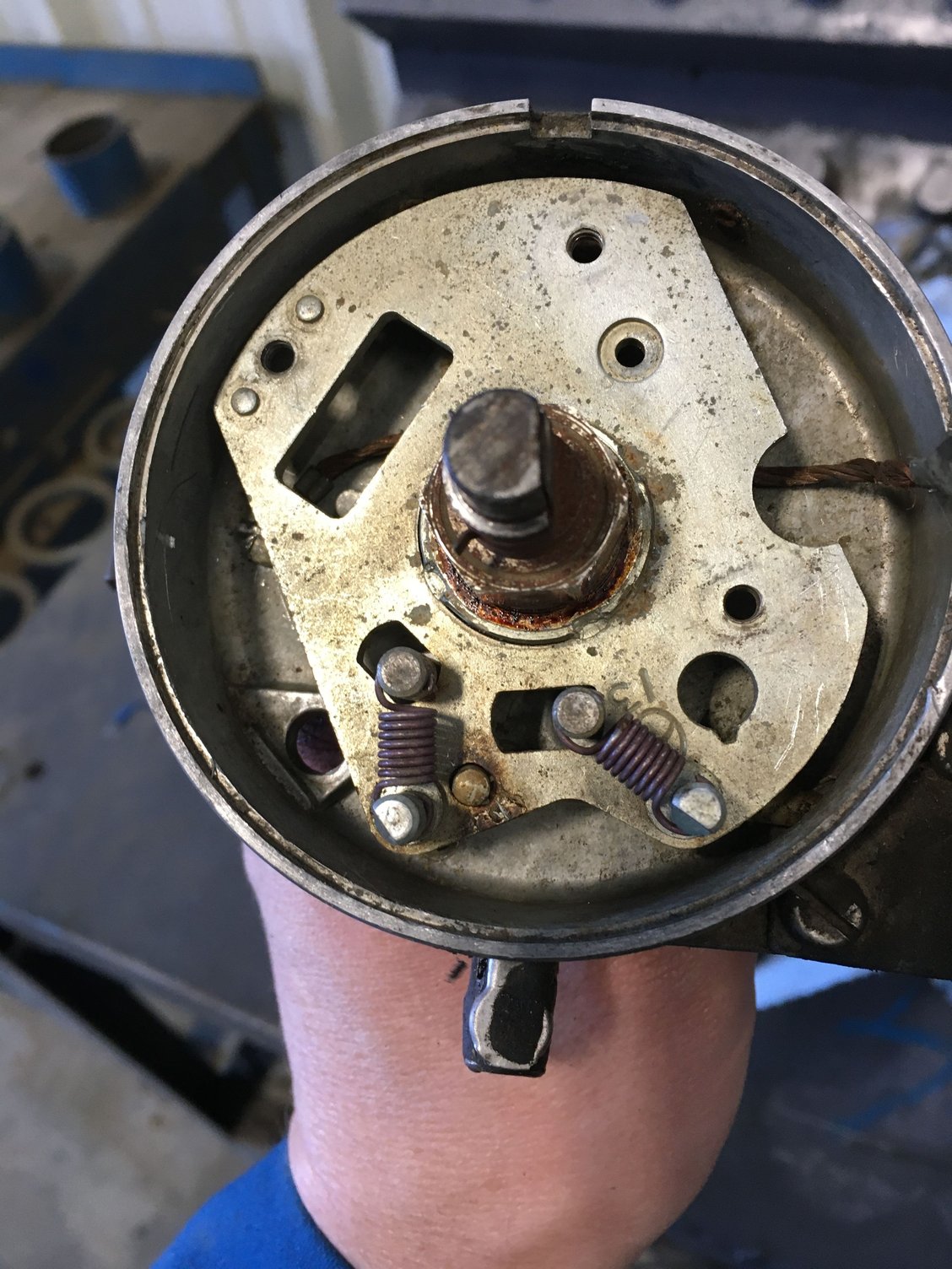

Back to the OP’s issue: Is the ground from the breaker plate to the distributor body good? If it isn’t the points don’t have any way to ground, and opening and closing them doesn’t do anything.
Old Nov 11, 2019 | 12:27 PM
longview1's Avatar
longview1
Banned
Joined: Jan 2003
Posts: 1,457
From: Grande Prairie, AB
Thanks.
Yes it is. Clean and connected.

Test light clip on ground and probe touching anywhere in/on distributor (ign on) = light on.
With the clip grounded, you have voltage anywhere on the distributor? That seems odd. I just went through this with the 67 Im working on. You need the body of the distributor to be grounded (there is a ground wire, it should be close to .00 ohms, I had .03) and with the key on, and the points open, there should be voltage on the tip of the points. I think I had the wires spun and mine was grounded. It works better with a multimeter. You can check continuity.
Im sure this is right, at least thats what I had, and it worked. I chased the same issue. Went through 3 condensors and 3 sets of points, although 2 sets were used. I finally used a new coil condensor and points and it worked, after I spun the wiring.
