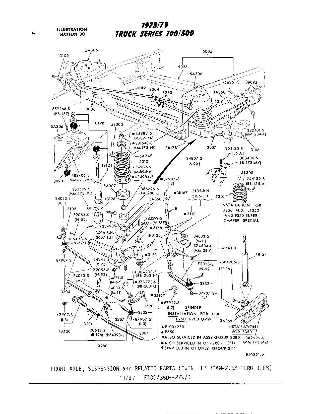

You do not have per say "struts" like "McPherson Struts" like what cars have. You have a coil spring and a shock absorber. And rubber bushings that are around the radius arm end studs. I'd check for a broken coil spring (should be obvious) and or a bad shock absorber.

Front coil springs bowed or bent? Some times that have a little bow angle to them? Is the bottom spring cup secure and are the coil spring retaining brackets there? Are your bump stops there? Are the shock mount rubber bushings there and secure?

I did not look too long, but it looks like the bottom of the spring is just resting on the metal..I was going to ask if there should be a rubber piece it should be setting in...I wouldn't be surprised if the springs are the stock one son this truck.

No rubber there, there just metal to metal contact.
