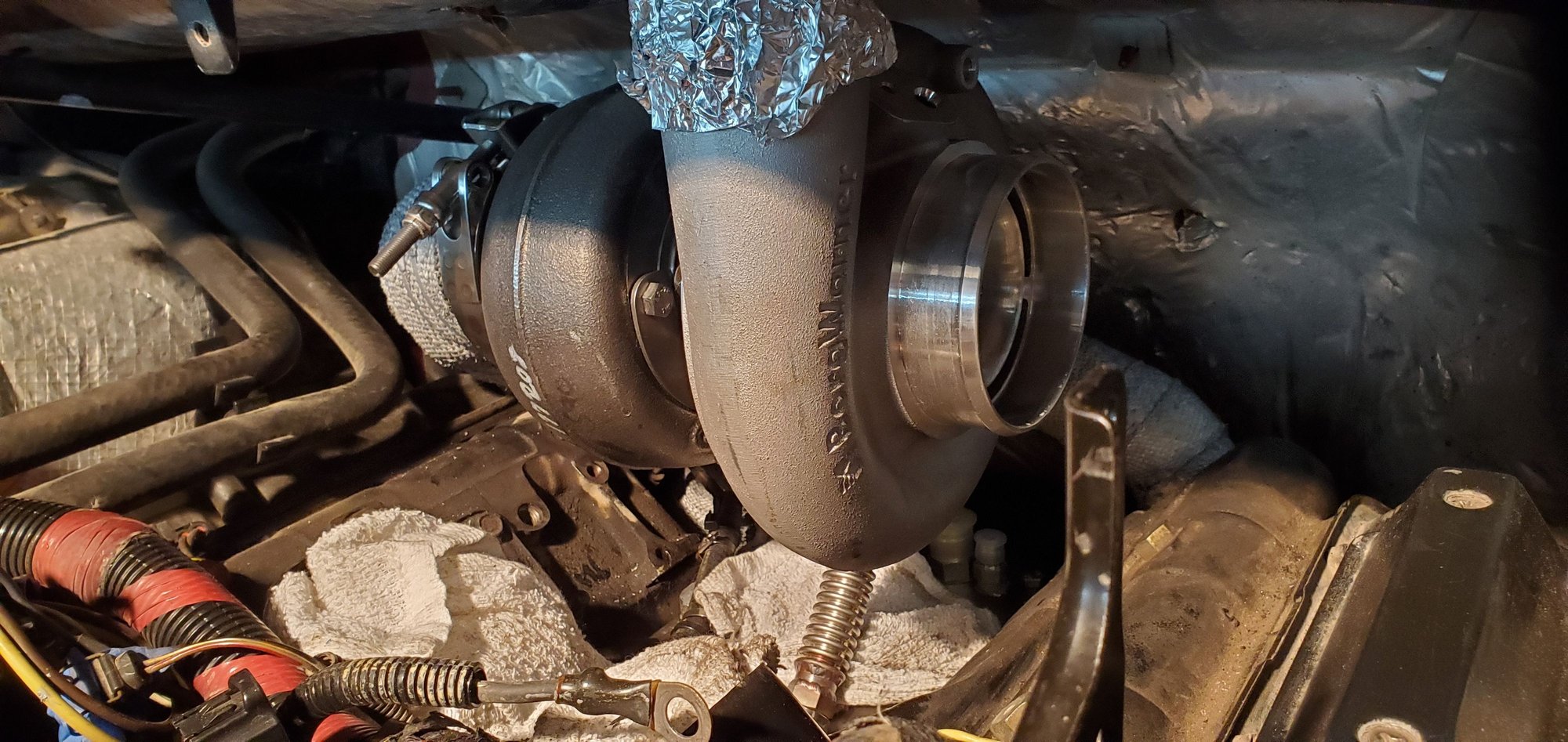

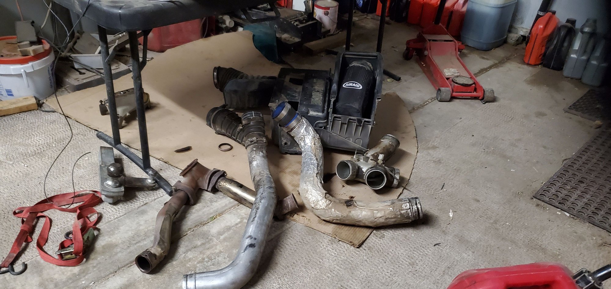

I'm done hunting for a little bit so I have some time to finally start my install before my next hunting trip. Got the old turbo out yesterday.
Lots of stuff now it's time to remove the down pipe.

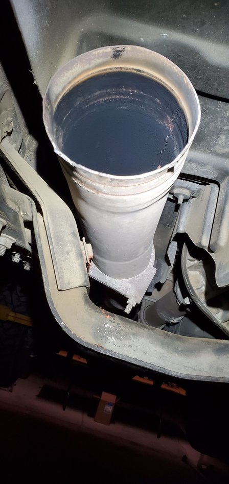

Down pipe

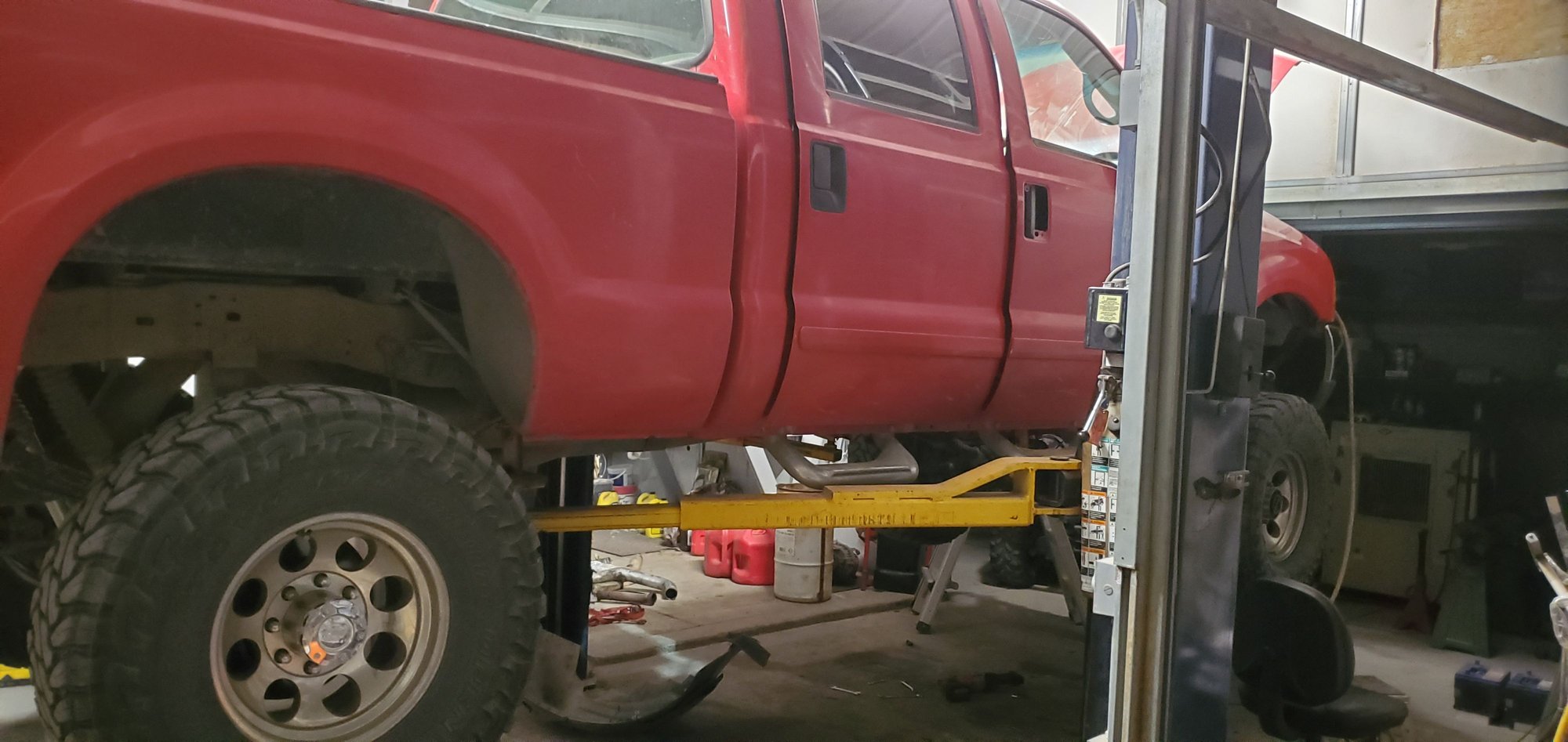

It's nice having access to a garage and lift.
Its nice having access to a garage and lift but finding tools in a friends garage is tuff and time consuming sometimes.

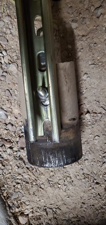

I cut the old down pipe and it slid down easy once unbolted
I drilled a hole in the remaining piece and bolted a piece of metal to have something to bang on. This was definitely not fun but I got it out finally. 😫😖
I wonder how close the new down pipe will mate up? I saw Sous modification and others as well.

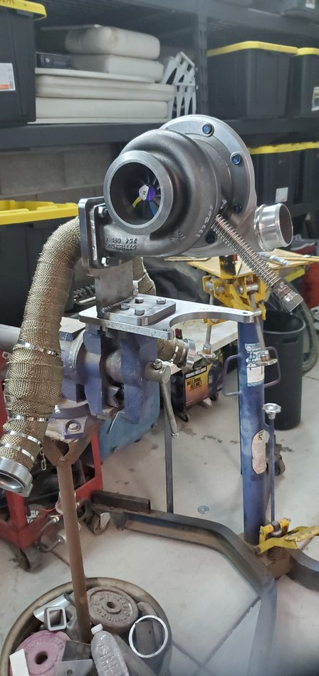

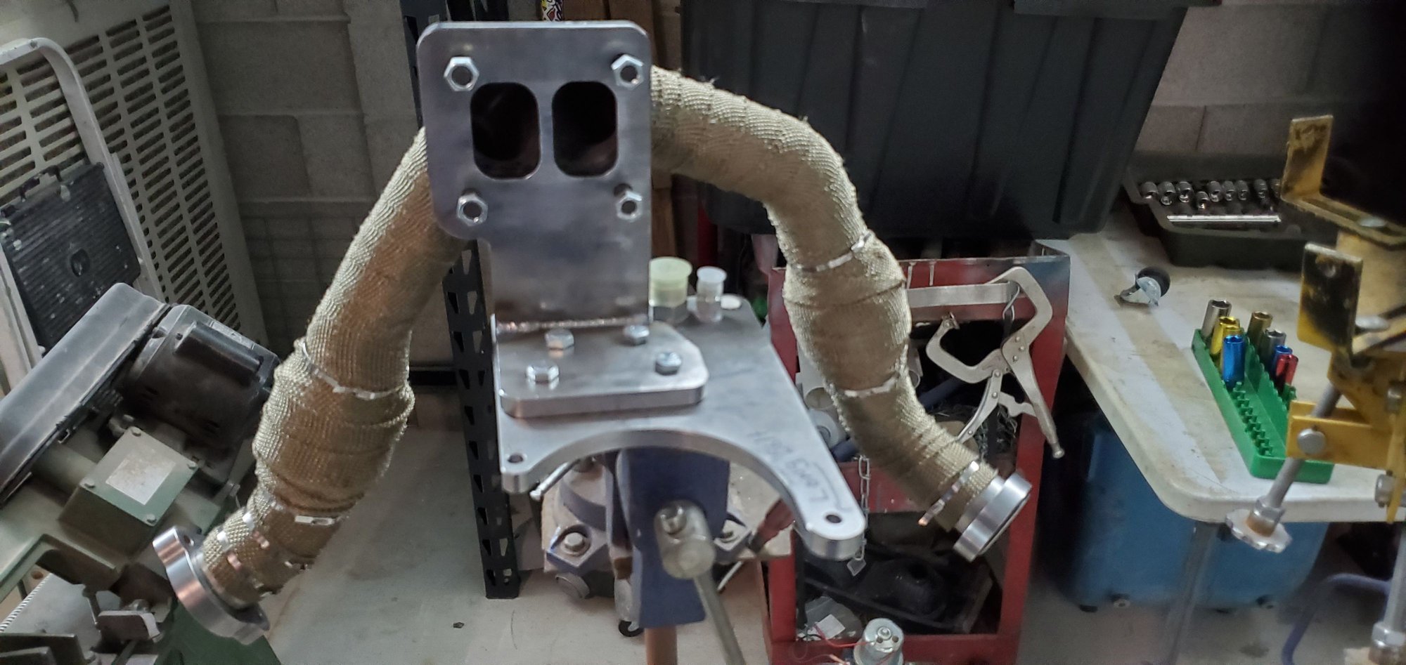

Titanium wrapped both the up and some of the down pipe.
Mounted in a vise and clocked the turbo.

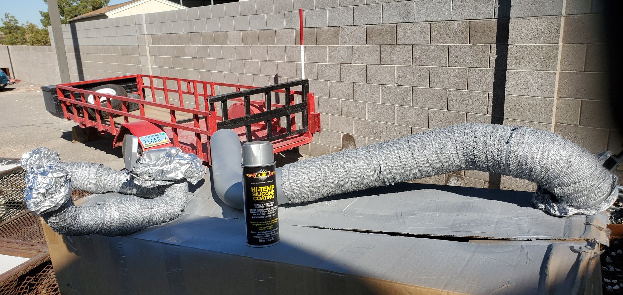

Now take it all apart so I can spray the titanium wrap with high temperature silicone spray as advised in the wrap instructions.

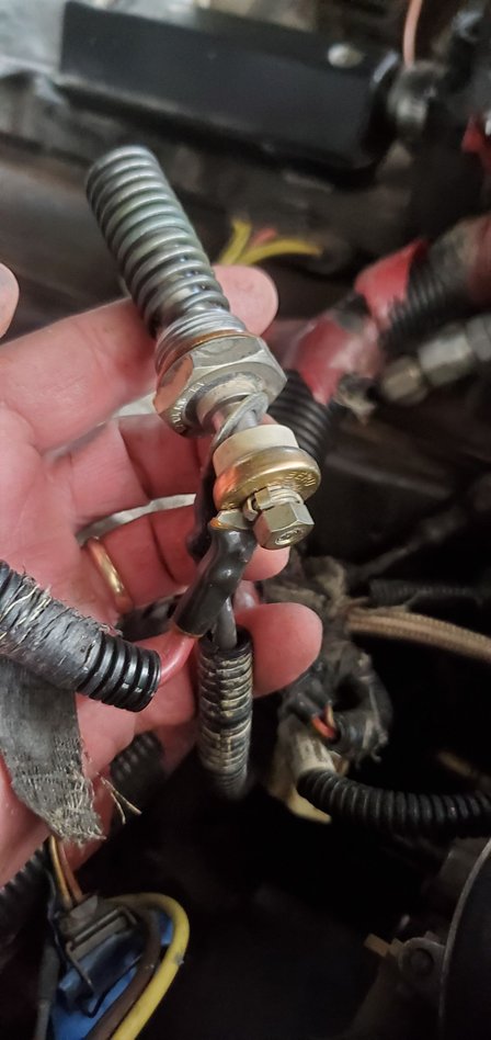

No place to mount this on the new Y so what have others done with this?
And this also?

The thing with red/green lines is waste gate solenoid, it goes in the trash as you no longer have a waste gate. The other thing maybe is the air intake heater? Don’t know what to do with it as my E99 didn’t have one to start with.

Thanks for info on the waste gate solenoid. And now I know what the air intake heater plug is after I googled it and people are deleting it so thats what I'll do also.
I'm glad it's not needed because I really didn't want to drill and tap my new Y.

I guess this could keep the titanium wrap from getting nasty?
Drinken a beer watching pipes dry.😆
