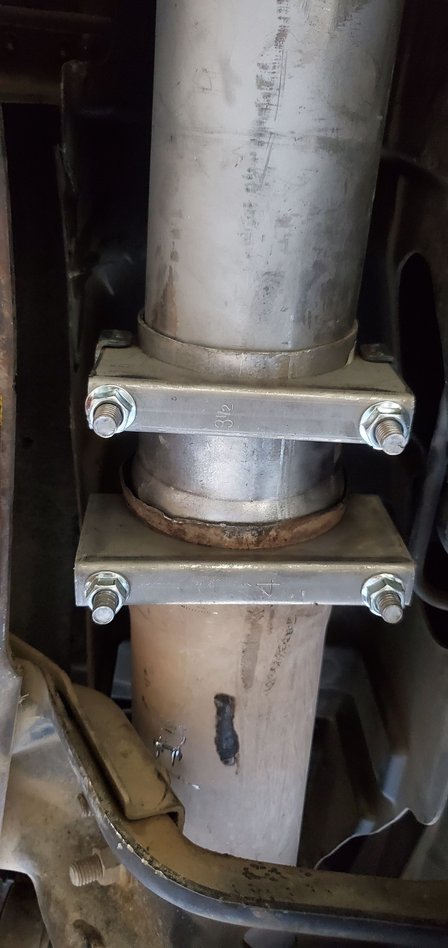

A local Napa may be open on Sunday. That is where I purchased my adapter. Don’t have the part number handy, be prepared to get gouged as usual at Napa. Don’t forget the clamps unless your welding it up.

That's a much better fit than what I initially rec'd from CSD. Even the second version isn't that good I think, but yes, you'll have an easy connection to make there

Also, I agree with SRBF150 that CSD seems to have ironed out even the smallest of issues. My down pipe lined up with the exhaust really well, but from that angle yours appears to be perfect.

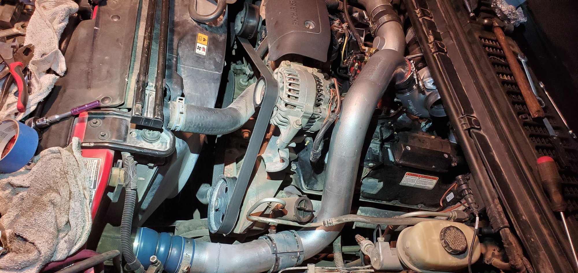

A piece of old wet exhaust tube from a boat will work as a drivers side intercooler protector.
Drivers side intercooler protection installed.
Backed out picture of the protective sleeve location.

My IC pipe on the driver side had about 3/8" clearance at that part, but I put a protector on to make me feel better about it.

Mine actually was touching it but not a lot of pressure.

You should get the upper radiator hose that goes around the outside of the belt.
