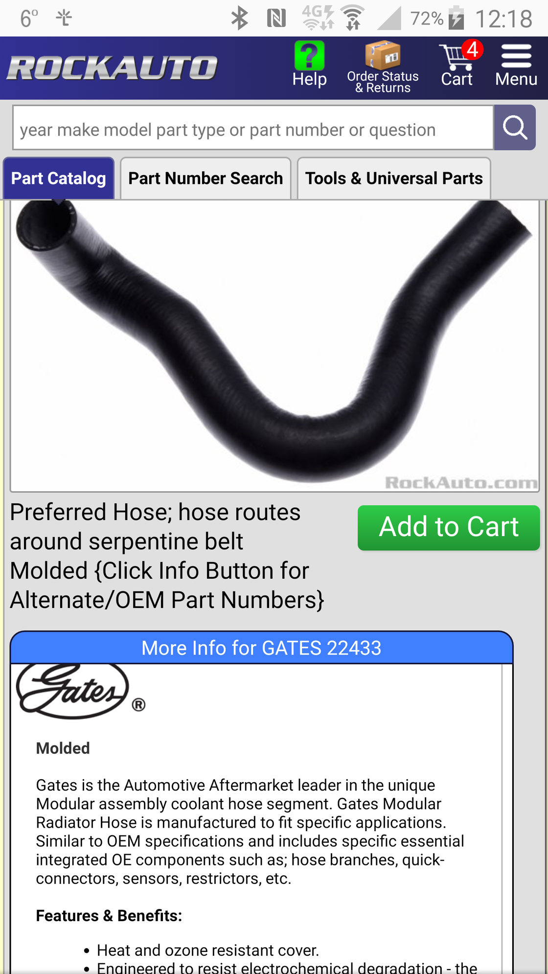

Originally Posted by Dan V
You should get the upper radiator hose that goes around the outside of the belt.
What radiator hose is that and where can I get it?

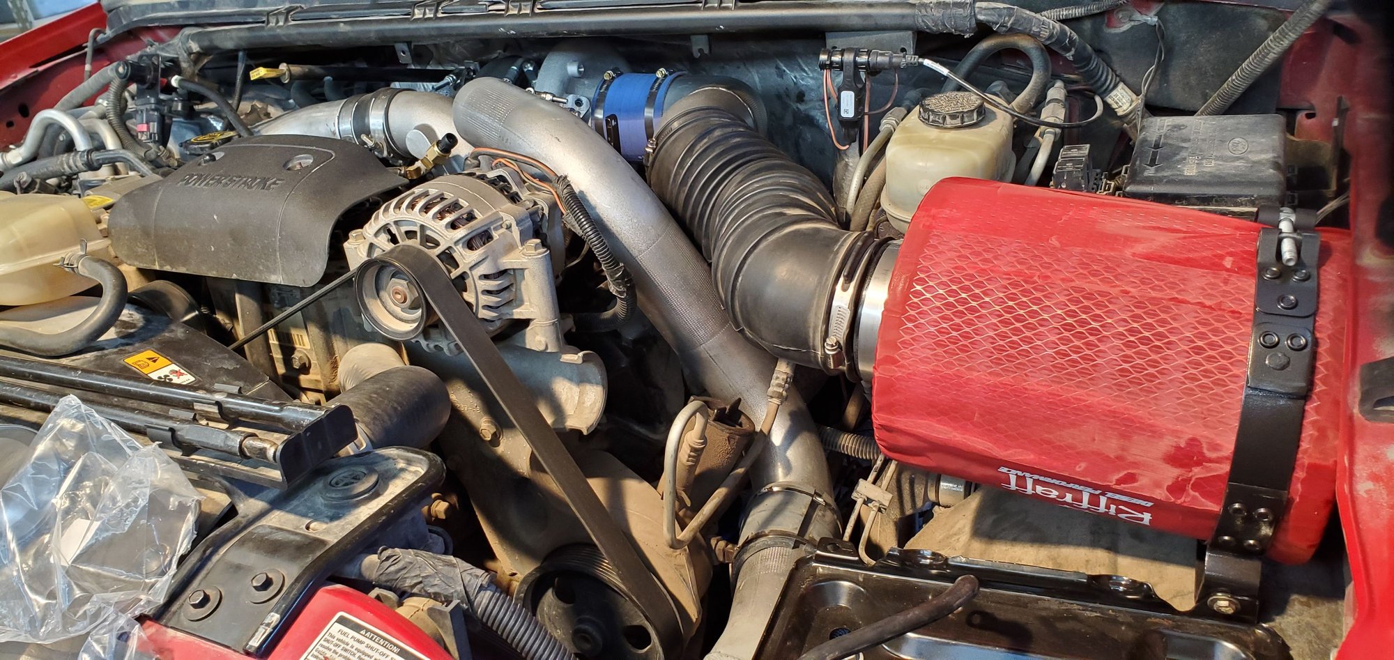

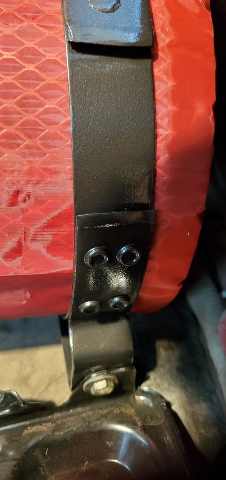

Not a lot of room to play in here but enough.
Cutting the portion of the bracket not needed.
A little paint on the bracket and all is good.
I might get a black protective filter cover instead of the the red. I think red is a little loud. 🤦*♂️

looking good man! That last photo reminds me, my air cleaner is still held in place with the bungee cord I used to hold it up while the inner fender was out. I will make that bracket over the winter to hold the filter securely in place.

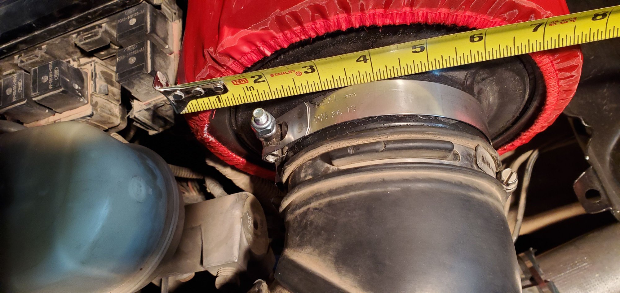

Originally Posted by z31freakify
Why do most of you remove the old filter housing, Ive installed the 6637 on the ones at work using the OEM dust inhaler (air filter housing) with little to no modification.
Almost 8" across.
I thought about it but 7" side to side so the 6637 would've been jammed up agaist the plastic air filter housing and I wanted the entire filter sucking air not just 80%. The smaller airaid filter would have fit but I wanted the larger 6637. Plus I just copied Sous. 😆
I got mine from Rockauto.com, but you should be able to pick one up at your local auto parts store.

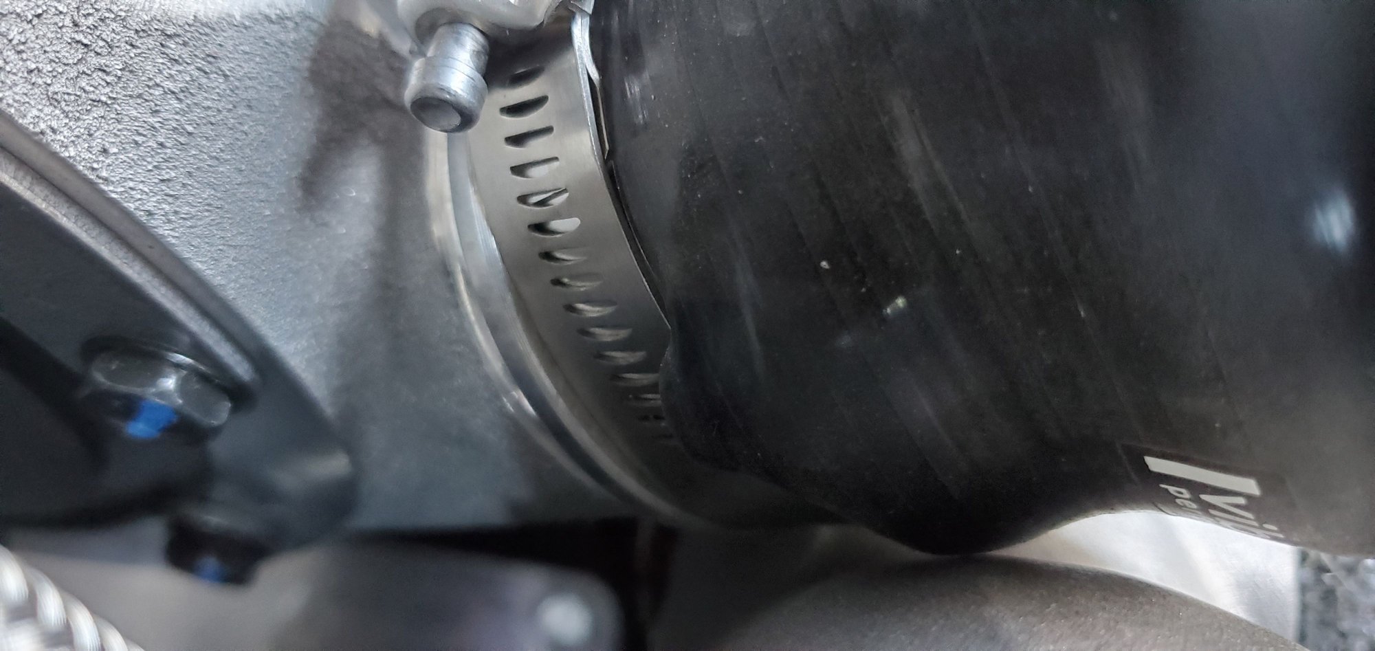

I've only did two short trips in town to autoparts stores. Last night was the first time I accelerated over 15-20,000 rpm and the stock boot CSD sent with T4 kit didn't totally blow off but a section popped out. I heard a dull pop and knew what happened. New part should be in before my next trip. I wanted to tow my camper for a bit before I comment on it. So far ran and sounds great until I sprung a leak .
