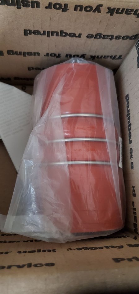

Bought all six new boots. I can't believe I tried using the 18 year old boots. I recommend anyone doing this project if you've never replaced or upgraded buy new. 😉 I bought HPS boots from Amazon to get them quick and they are great quality. No more issues on little test runs.
