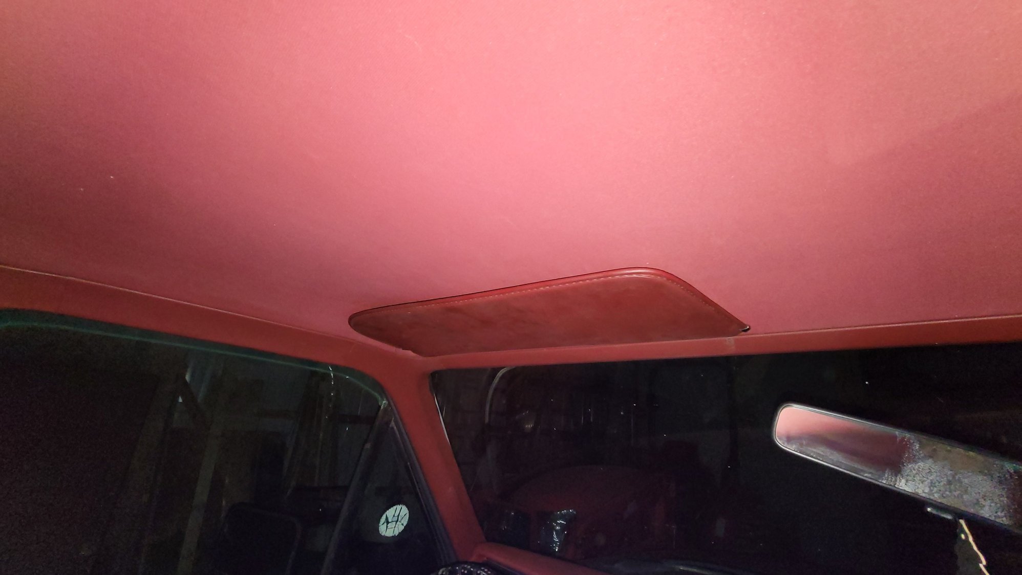

Had previously removed the bracket, unfolded the petals that held the bracket spring in place, added a spring, semi-crimped the unfolded petals together, and reassembled by threading a sheet metal screw into the re-folded petals. I removed the bracket from the headliner, disassembled my previously assembled attempt, supported the portion of the rod that runs through the visor with 1x2's clamped in a vise then used a large pair of needle-nose vice-grip pliers to grip the portion of the rod that goes through the bracket and bend it into a sharper angle to effectively raise the visor closer to the headliner. Reassembled the unit and put it back in the truck. Looks like this:
Don't know if it will last but at least it is no longer in my line of vision.
Thanks for the help.
