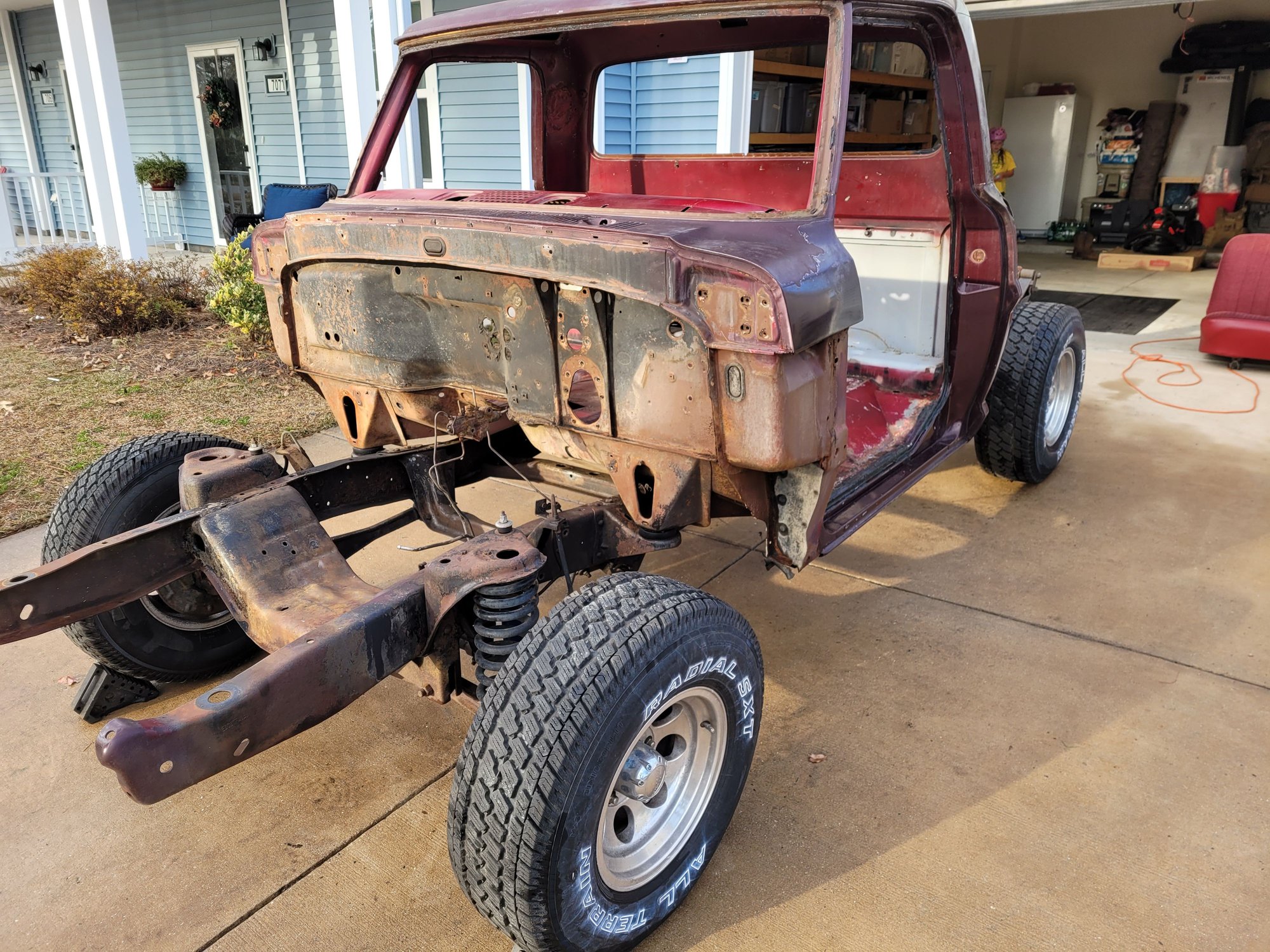

Those I beams are original to the 1968. They fit 65/70 F100 4X2. Note, no Bumpside came with disc brakes from the factory. Grandpa must have gotten cagey. The pin that came in Ford's king pin set was 6.35" long and had an O.D of .85". I dunno if you need longer pins for your non-factory for 1968 spindles.
