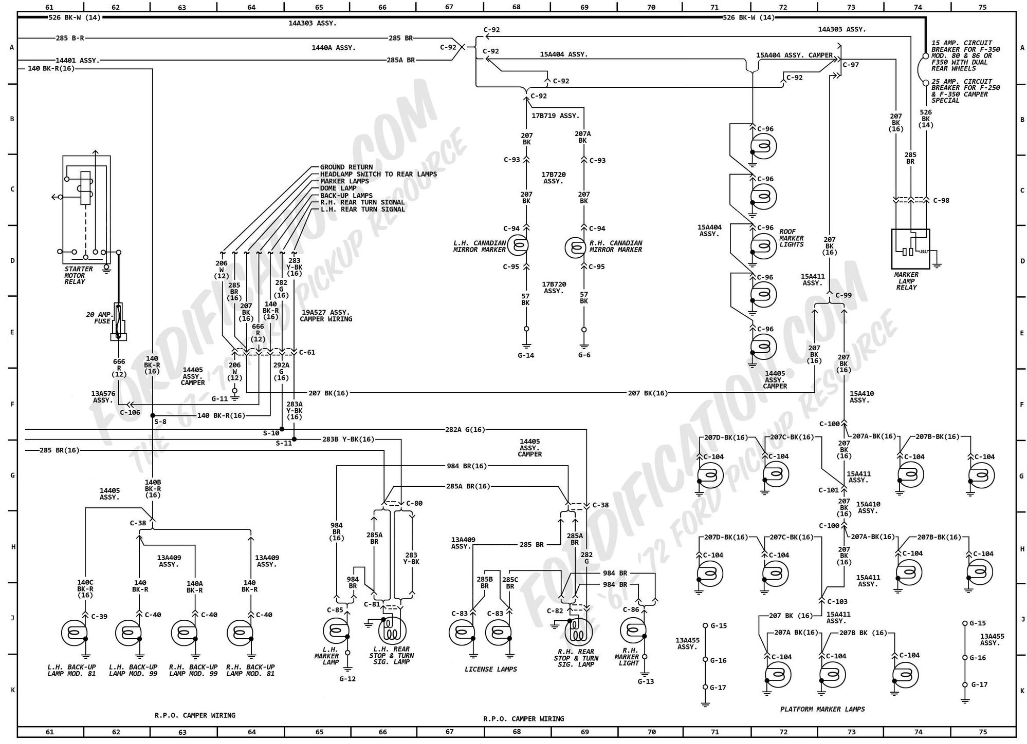

Ford Truck Technical Drawings and Schematics - Section H - Wiring Diagrams
And there is. Check this one out:
http://www.fordification.com/tech/wi...350markers.jpg

I took the headlight switch out today. The cab lights are wired straight into the switch. I think my problem may be in the "Marker Lamp Relay" which was mounted on the pass side next to a circuit breaker. The breaker was burnt. I replaced it, but the relay doesn't do anything. The number on the relay case is: C8TB-13A435-A. I can't find the relay even listed in the catalog for :NPD, LMC, MAC, Dennis C., or restorations specialty. I looked at the NAPA, O'reilieys, and PEP boys too. So maybe Jeffefa, or Number Dummy can find a part number for it. I don't know if a horn relay is the same or not. I might give that a try next.

Originally Posted by Rasputin53
That's the switch to blink the markers as in 'you are clear to merge.' Mine were just wired straight to the running lights, IIRC. I can check tomorrow when it's light again. I found a blink marker light switch so I can do the marker flash, but that is a F500+ item it seems. From the diagram, it comes off of wire 984, Brown, straight off the Light Switch. this does the front fender running lights. Might also be a breaker for the clearance lights.
That wiring diagram shows the "Marker Lamp Relay" that I think is bad.
