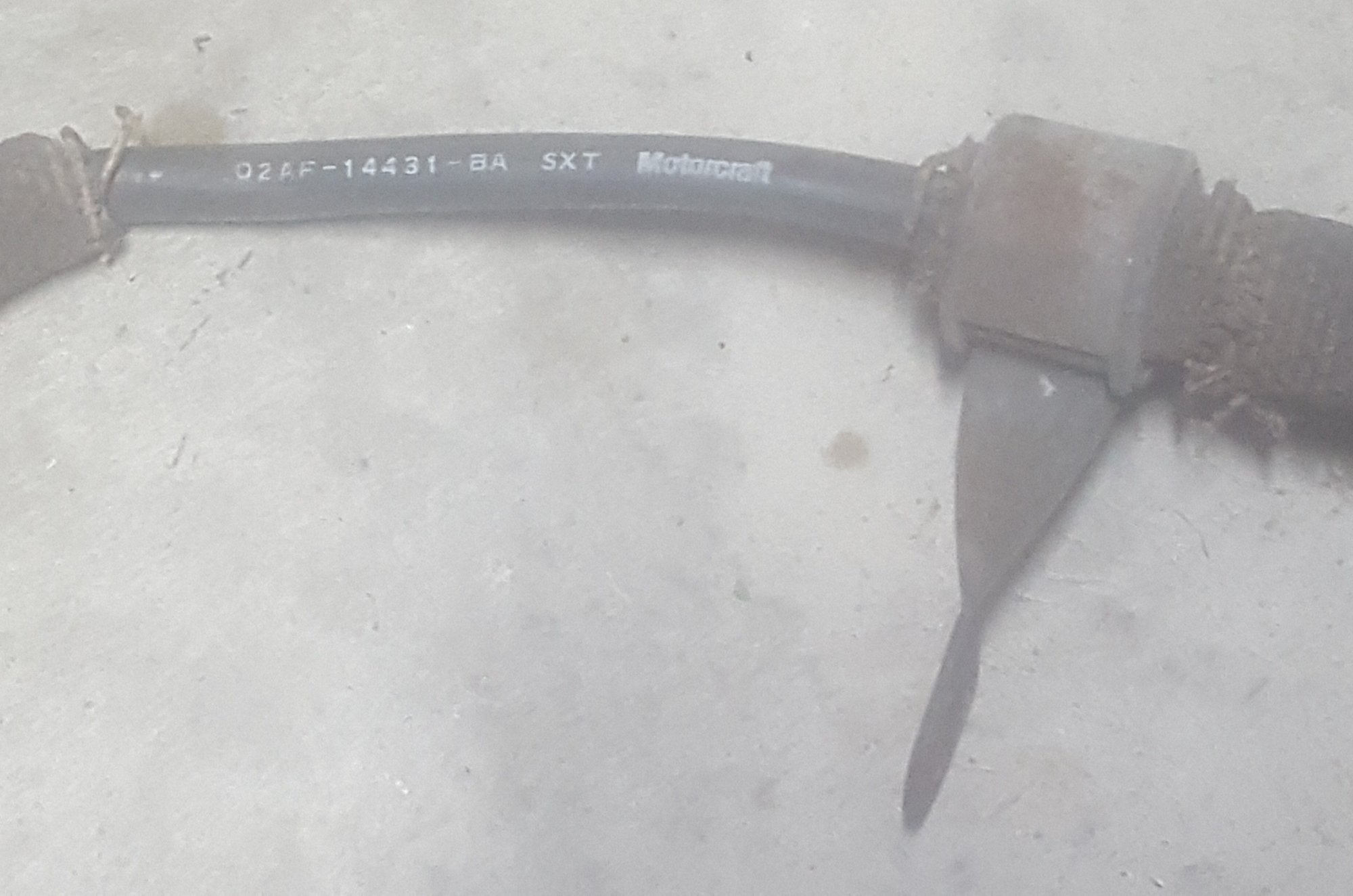

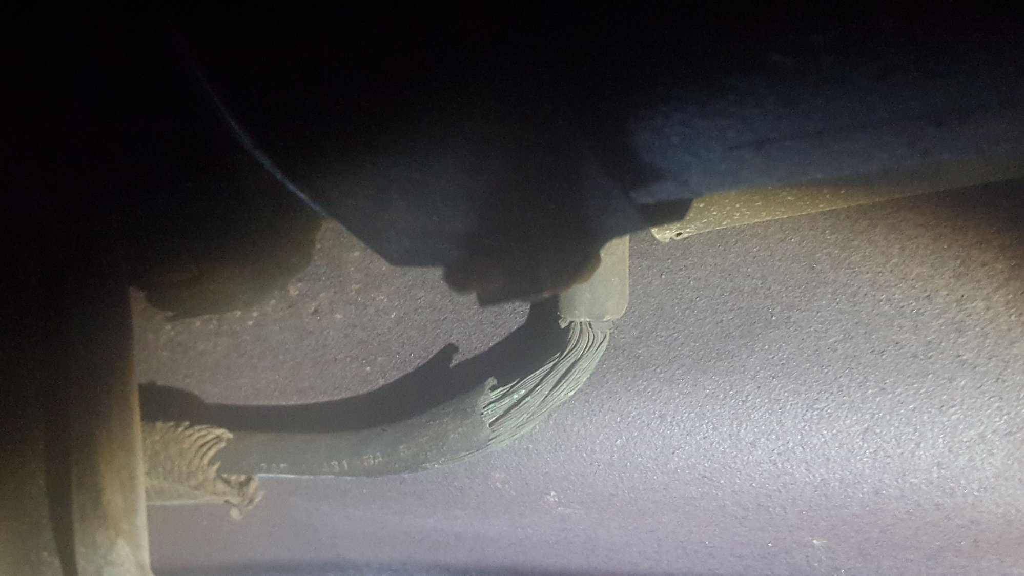

battery cables
After spending many hours under the truck I have found that the Starter to Solenoid cable is in the process of falling apart in place and the exposed cable is green. I took all 3 cables off and measured them to get the closest cable length for replacement.
Positive to Starter Solenoid- 12 inches
Negative to Engine Block- 33 inches
Negative from Solenoid to Starter 42 inches
The Cable that ran from the Solenoid to Starter also had a cable bracket that was bolted to the block and the length of the cable was covered in a heat wrap. The part number on the cable read D2AF- 14431-BA SXT.
Not sure if the 3 cables are F100 specific or if they came off of the 72 LTD when my grandpa did the engine swap. NumberDummy can you help on this for insight.

The "D2" indicates it's a '72 or later part (engineered and started it's use in '72), so sounds like it came with the engine. And appears to be original by it's condition. I'd say it's given 47 years of service so can be well retired!
You don't have to match lengths exactly to a swap either. If a shorter cable (shorter is better) will fit with clean routing around obstacles and moving parts, shorter is better and cleaner.
But hey, if it takes 33" or 42" or even 60" to snake around things and get there cleanly, that's what it takes.
But that's also why bigger is better. That 33 inches is better suited to a larger gauge cable than the typical 6ga that Ford might have used from the factory. Besides, you're trying to get rid of a hard start when hot issue anyway, so bigger might actually be called for in this case.
What gauge cables did you get to replace the old ones? I usually say 4ga is the minimum, with 2ga being even better at least for the longer runs. The 12" one can get away with being smaller, but the 33 and 42 inchers should be as big as you can get.
The cable that ran from the Solenoid to Starter also had a cable bracket that was bolted to the block and the length of the cable was covered in a heat wrap.
The ID engineering number on the cable is: D2AF-14431-BA = Ford part number: D2AZ-14431-B
The following are Motorcraft "universal fitz-alls" that were used on other vehicle applications besides what I listed.
D1PZ-14300-AG .. Positive Battery Cable - 10" long (Motorcraft WC-8118): 1972 LTD 351C/400/429.
D1PZ-14300-H .. Negative Battery Cable - 30" long (Motorcraft 7304): 1969/72 LTD 302/351W/400/429.
D1PZ-14431-K .. Starter Relay to Starter Cable - 43" long (Motorcraft WC-8096): 1970/71 LTD all V8's; 1972 LTD all V8's except 429 4V Police Cruiser.
What engine did the truck come with originally? 4th digit of the VIN is the engine code: 1968 F100: A = 240 1-6 / B = 300 I-6 / H = 390 2V / Y = 360 2V

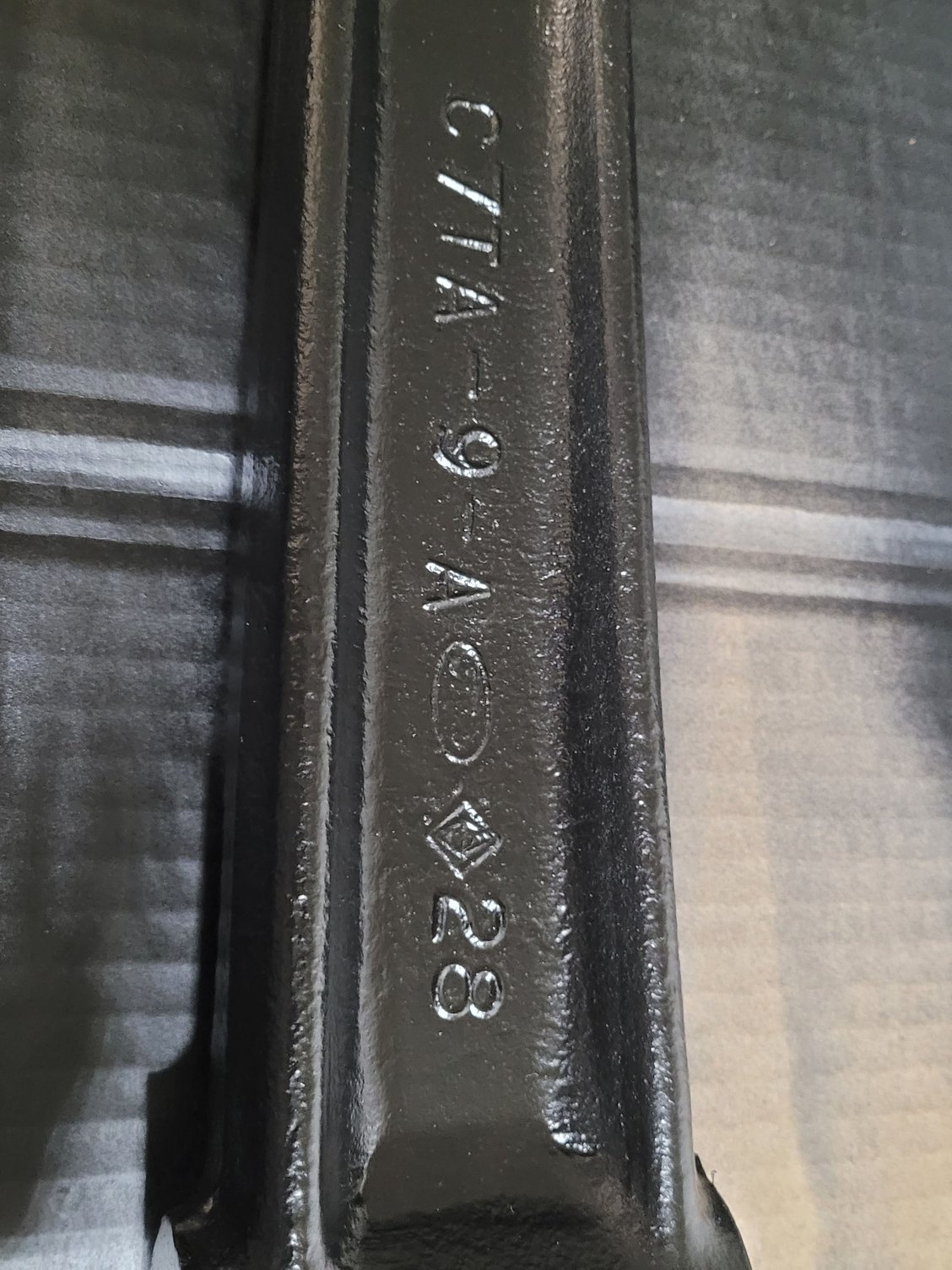

I-beam question
I hope all is well during this crazy time we are living in.
Truck is coming along great. Have since moved back to NC and tore it to the frame and starting g the rebuild.
Question. After many hours searching Fordification and the world wide web, I am still unsure of the year of I-beams that are on the truck. The spindles are disk not drum. Needing the year so I buy the right kingpins.
Numbers are
C7TA-8-A (fomoco) 30 and C7TA -9-A (fomoco) 28
Asking because I haven't found a year with 28 or 30 with the first part of 8 or 9 A. Have seen postings that have C7TA with the year 1968 or 1971 next to it. Depending on the website.
