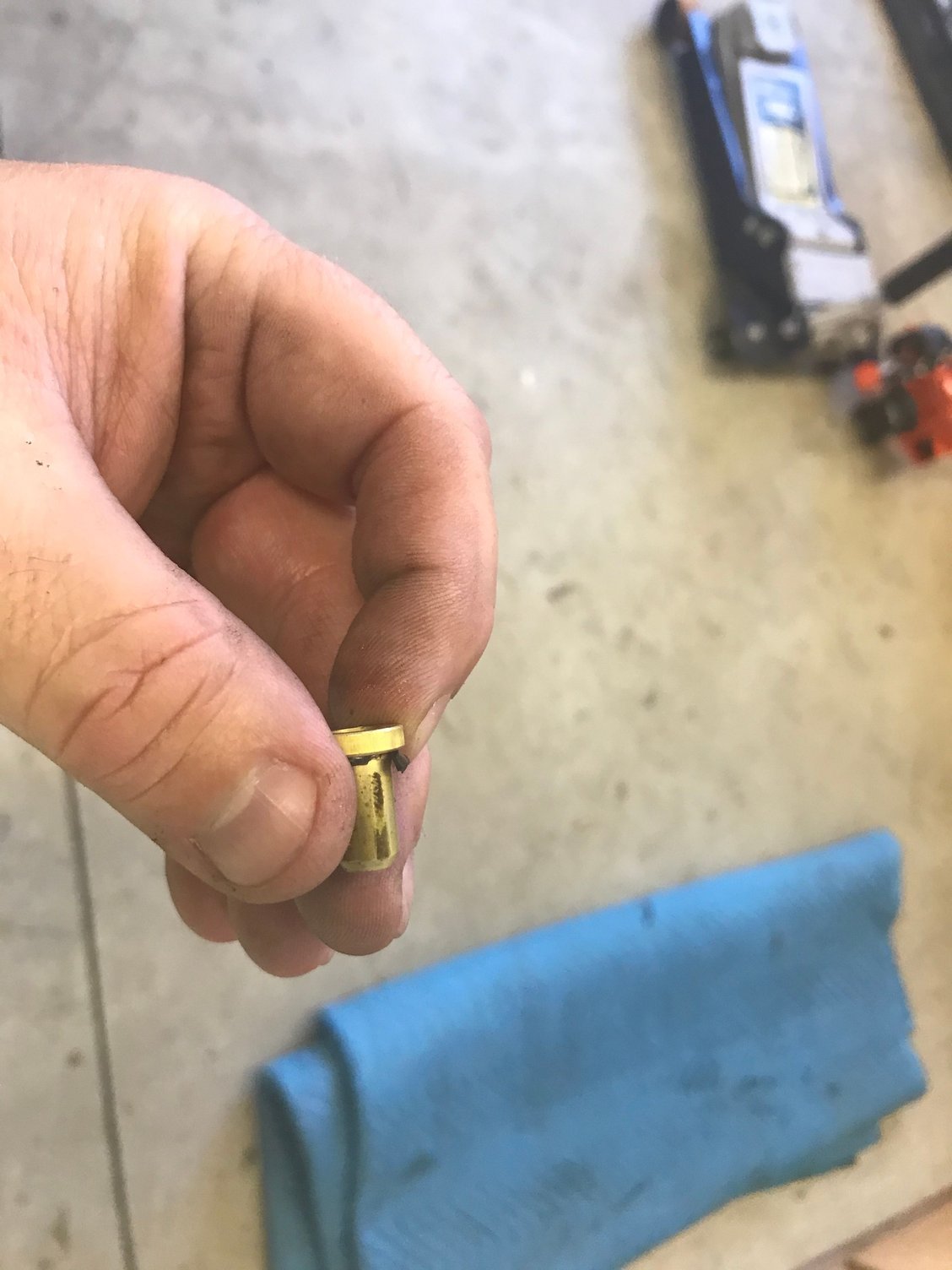

Here is the culprit. Fuel no longer draining off and the rough idle is gone. The only question now is what if any damage has been done to the injectors??

I would just keep an eye on things for a while.

So if I may review (not trying to be the *** some may see me as).
  • Poor running motor.
  • A quick drain of the fuel filter reservoir.
  • No fuel pressure reading because the sensor failed.
  • Misdirections and HFCM pump change SWAG did not fix the issue.
  • Failure was an o-ring of the pressure regulator, part of the blue spring kit.
  • Concern over injector damage due to unknown fuel pressure.
Conclusions
  • An operating fuel pressure gauge is an essential part of the operational monitoring of a 6.0. Every truck needs to have one and it is imperative to fix any that are not working correctly.
  • Changing out the fuel pressure regulator has potential issues, both potentially with the assembly method and source of the product (unknown).
  • Fuel pressure o-rings may have a service life, depending on the source: assembly line; Motorcraft; or aftermarket.
  • Key tell without a fuel pressure gauge was the fuel draining out of the fuel filter reservoir quickly.
Some here who I consider being excellent mechanics and diagnosticians have had issues with this o-ring. Maybe a little more care, lubrication on install or just routine change-out of this ring may be necessary, depending on the source of the multitude of o-ring piston blue spring failures the community has seen.
    • Correct
    • Correct
    • That or it wasn’t building pressure. I remove the sensor and installed a new plug to remove this from the equation. This was a Dashboss kit, which I will be transitioning to a pillar mount gauge soon.
    • The symptoms arose AFTER I performed a routine 10k filter change. I assumed that I caused the issue some how. I have an extra HFCM so, I took a SWAG, yes.
    • I installed the Motorcraft blue spring kit back in 2016. Pretty straight forward to replace.
    • Yep
Conclusions
    • Agreed
    • Motorcraft, installed by me in 2016. I’ve installed them on 3 different trucks and this is the first time I’ve had an issue. Could I have damaged it, it is possible.
    • Agreed.
I combed through a ton of threads with the exact same symptoms as mine, and couldn’t find any with a resolution. Well there is one now.
