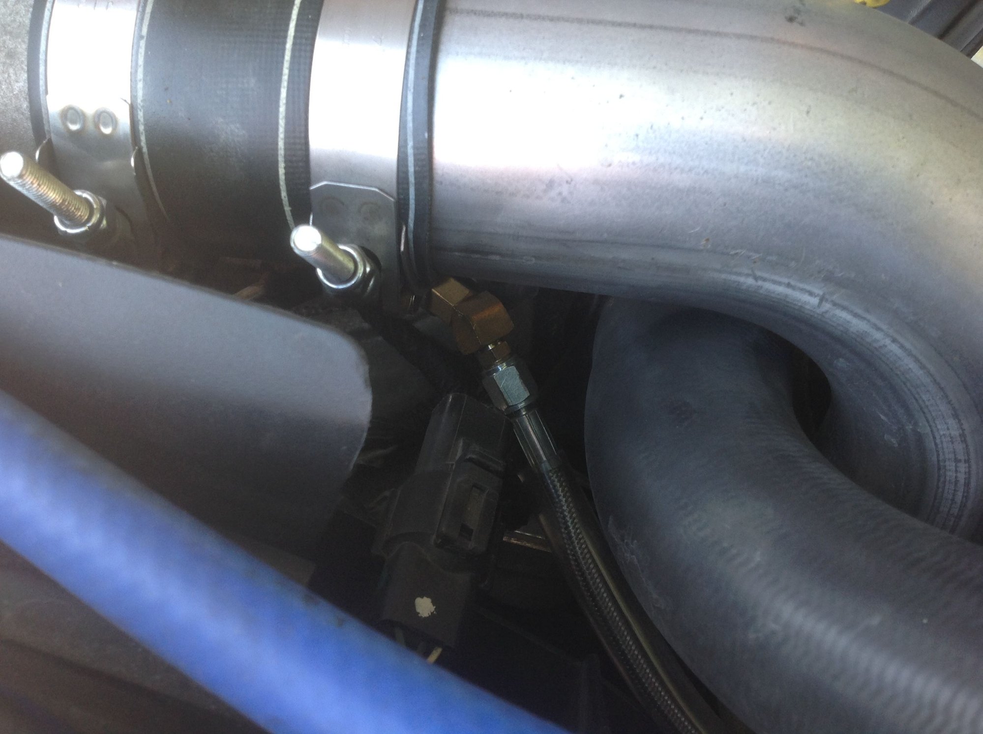

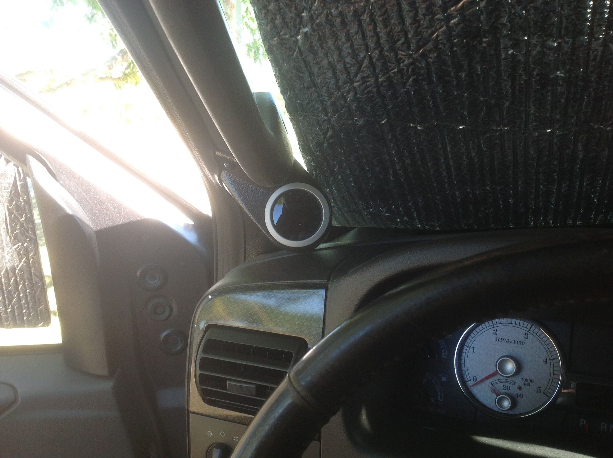

Single pod. Wired to headlight switch to provide dimming when lights are switched on. Wish it dimmed more.
45*fitting for clearance and pvc hose for chaffing
Wired to upfitter switch
Here is my Glowshift setup for comparison.
Thanks for posting pics. Nice to know I can keep my Oh Scat handle with the single Pod.
