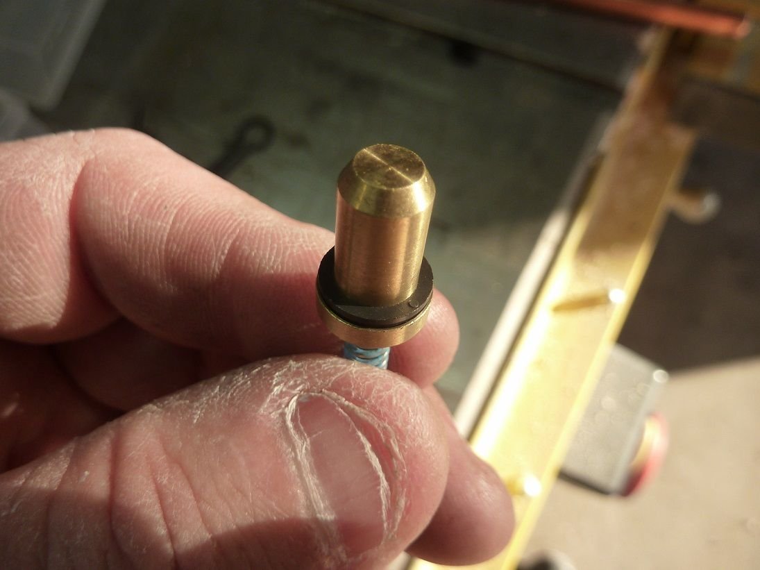

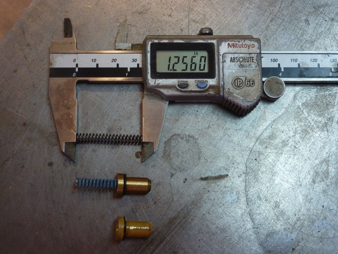

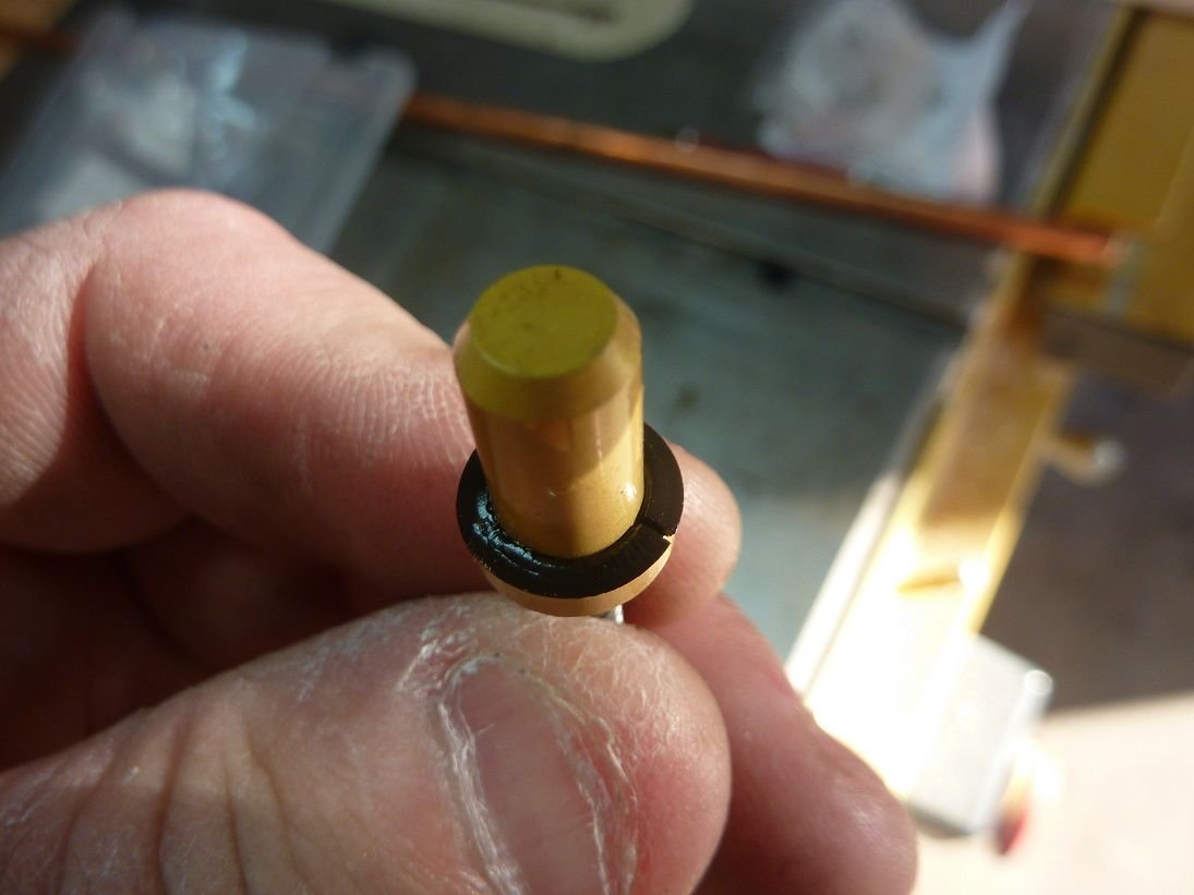

Here's my findings:
Fuel pressure is up to 64psi at idle from 58psi since replacing the kit. I'm guessing it's mostly to do with the crack in the plunger seal, but I'm sure the weaker spring wasn't helping.
Not to self: Replace regulator in three years as preventative maintenance. Or spring for a return regulator and never worry about it again.

So your old spring has compressed a bit, but am I seeing a split in the o-ring?
Old Nov 4, 2019 | 06:41 PM
  #43
Yahiko's Avatar
Yahiko
Joined: Apr 2012
Posts: 27,307
Likes: 549
From: Spanaway
Odd thing about springs. they are rated at a given compressed state.
So you can have two that look different but if both when compressed
to x length and give the same force at that length. Both could be good.
The crack in the seal I think is more the issue that anything else.
I would call it a seal rather than an o-ring, but yeah, that' absolutely a crack.
And Sean, I wouldn't say it's my issue anymore!
x2
The same situation that Pete and a few others have had.
Compressed length tension, other factors are winds per inch and wire size.
When I did my heads I bought a set of aftermarket valve springs that a few known rebuilders use. At valve close height they were the same as OE, valve open height, below spec. Wire size was a few thousand less smaller and they weighed less.
Return regulators have issues too. It certainly seems that the service side parts are not holding up as well as the OE assembly line parts did.
