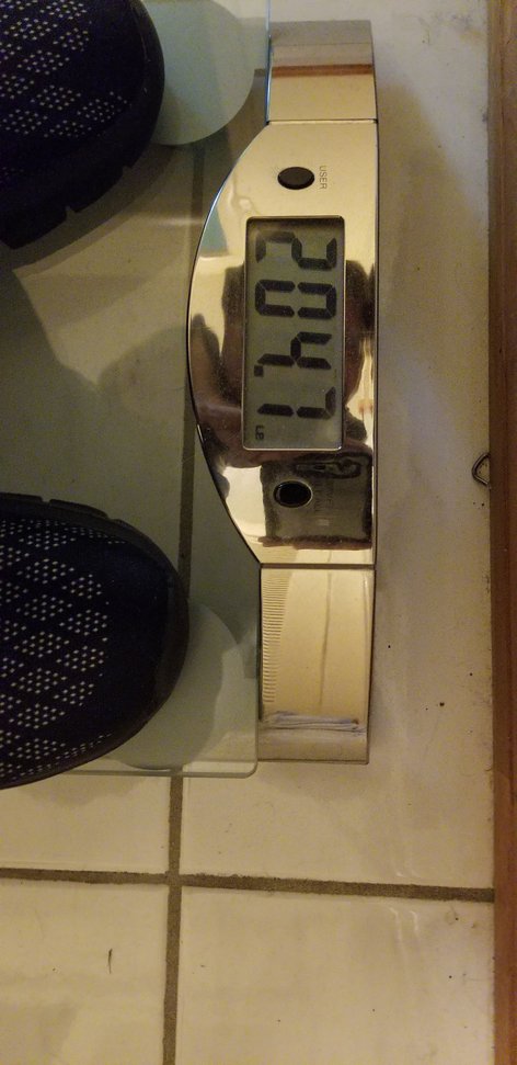

I just tested the downloaded calibration and still have the same issue. Standing on the Reese hitch, the gauge states I am about 300 lbs, and when I step on my bathroom scale, I am 205 lb. Did it twice to make sure. I sent Thomas these results.

Ok, thanks for sending that screenshot and the weight; from those two things we calculated a corrected value for your Excursion and we are in the process of updating the database for your VIN
I'll let you know once that's done (the team said they'd get to it before the end of the day) so you can try it out again
Thank you David!
