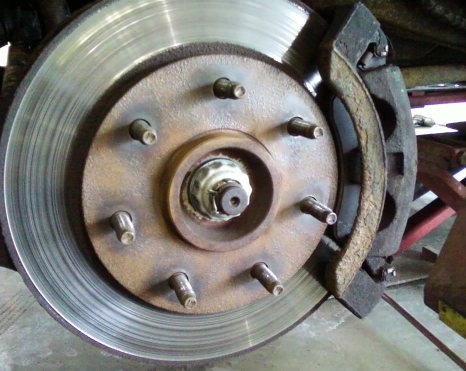

they actually made 7 lug F150 7700(97-08). The 7700 stood for 7700lbs GVW, all the badges on the truck said F150. The 7-lug trucks were basically what you got if you ordered an F150 with the snowplow prep package, 10.25" rear, 4.10 gears
Take a look at the tailgate on an F150 with seven lugs, and it will say 7700 right under the F150 badge
my buds truck, 97 7 lug F150
replacing pads 3 weeks ago
