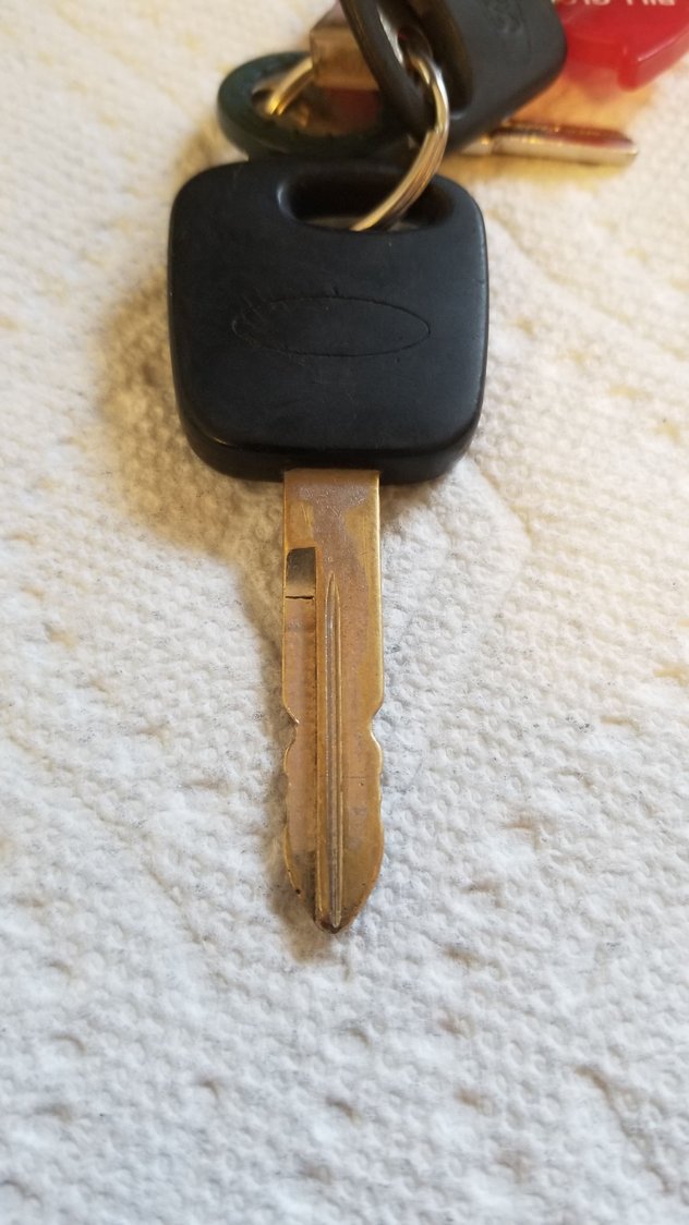

Well once again I got sidetracked and did not get to work on the truck unfortunately. (Took the Torino out for a spin...) but I did make a call to one of the mobile locksmith guys we used when my son needed a new key programmed for his 02 Mustang. He seemed to think that it was unlikely but still possible that it used that type of key. I asked him about trying to start it with a regular key and new ignition tumbler assembly, he said it would be okay to try it once and if it didn't start do not try and start it again. Here are a couple pictures of the key I have...

If it turns out you do need the chip, there is a workaround.
You can remove chip from the old key and attach it inside the steering column as close to the tumbler as you can get it.
Yeah that was my initial plan when I purchased the non chipped Ignition switch/key assembly... just tape chipped key on the steering column under the plastic shrouds/covers...
"I picked up a "Non-Transponder" ignition assembly with two "non" chipped keys.... I haven't swapped it out yet, but I thought if for some reason mine does have the anti theft system I could maybe just tape the original key inside the steering column shrouds close to the base of the ignition tumbler assembly....???"
