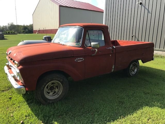

Figured I might as well start a new thread of my build. The plan is to make it where it could be a daily driver. Its going to take a year or two to get it where I want it but well worth it in the end.
Here's the spec on it that 66V8baby decoded for me
F10 Series code, F100
Y = 352 2V for '66
K= Kansas City MO, assembly plant
746328 = Consecutive unit number, built in September 1965
115 = Short wheel base
J = Rangoon red exterior color
E81 = Trim Code for Custom Cab with red crush vinyl and cody weave pattern
C = trans code, Ford 3 speed 3.03 fully synchronized
17 = axle code, 3.25 open 9"
63 = Memphis District Sales Office where it was ordered

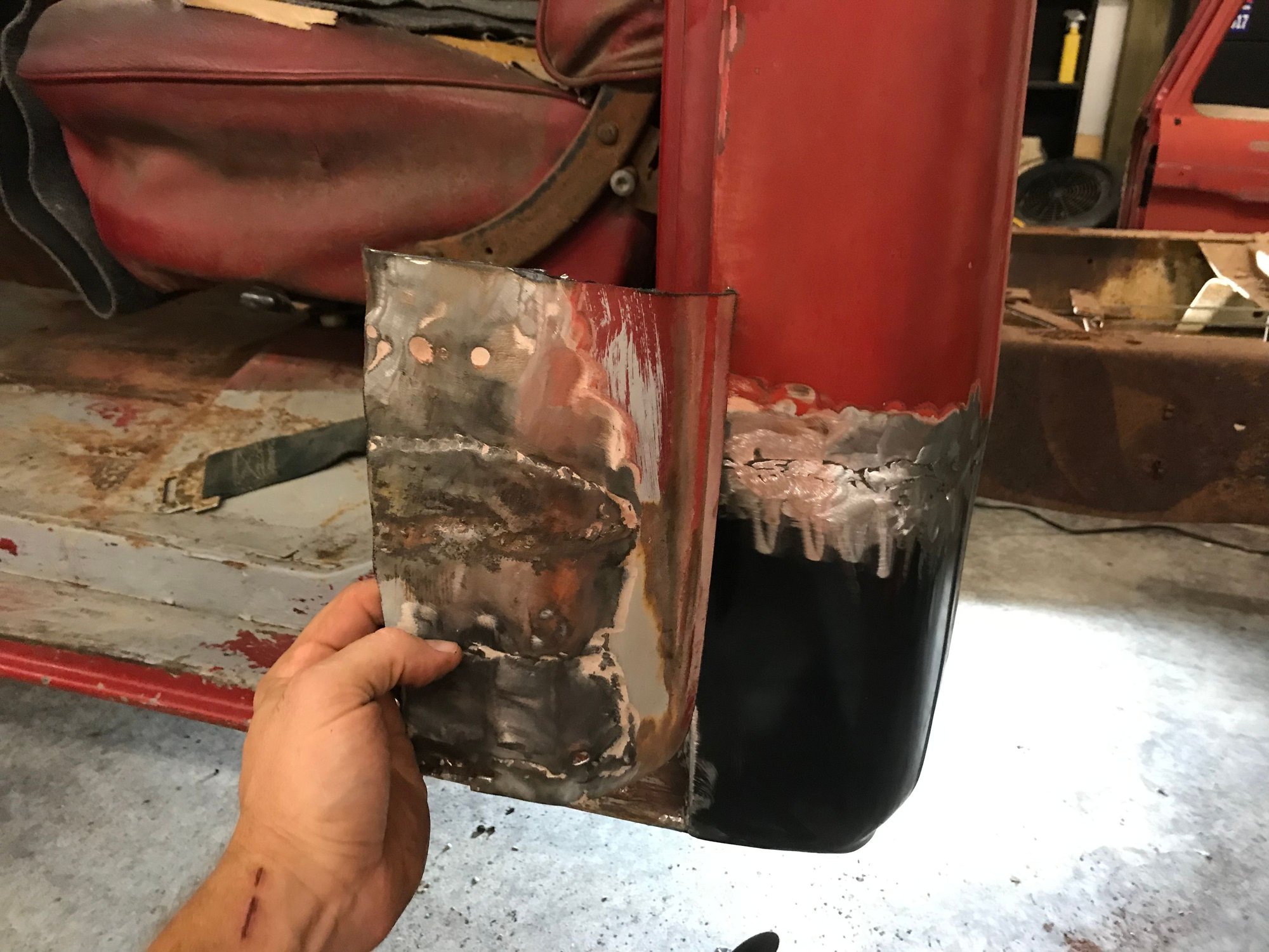

They got a little carried away with the radio cut out, have to patch that up. Both floor pans have had a previous fix, while not the cleanest fix its a floor that will be covered up anyways. So I'll touch it up, weld up extra holes and then cover it up.

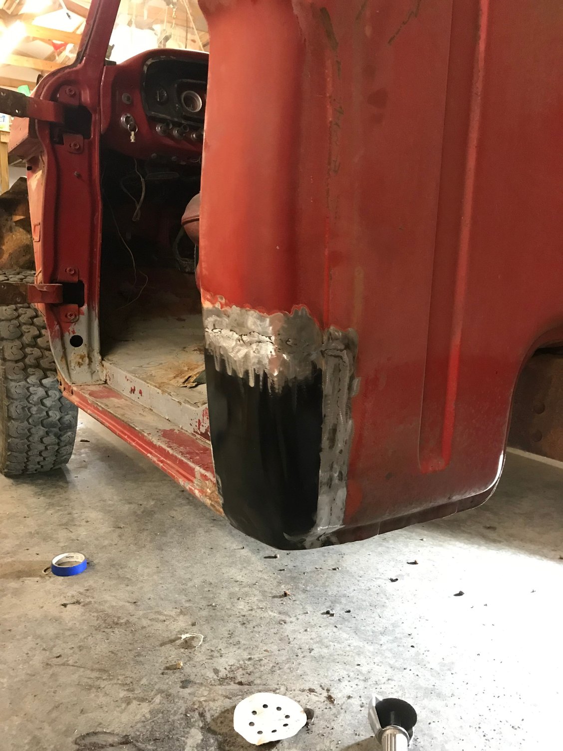

Not a very clean cab corner fix, already ordered a new panel to cut this out and fix it correctly, more pics to come on that progress

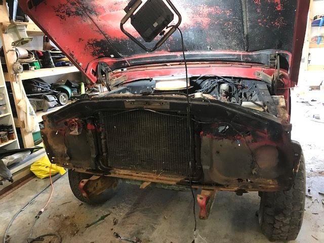

After sanding for a bit decided to pull the majority of the easy parts to have them blasted. Rusted U-Bolts are a major pain, but got the grill out and fenders off. Had to cut a few bolts

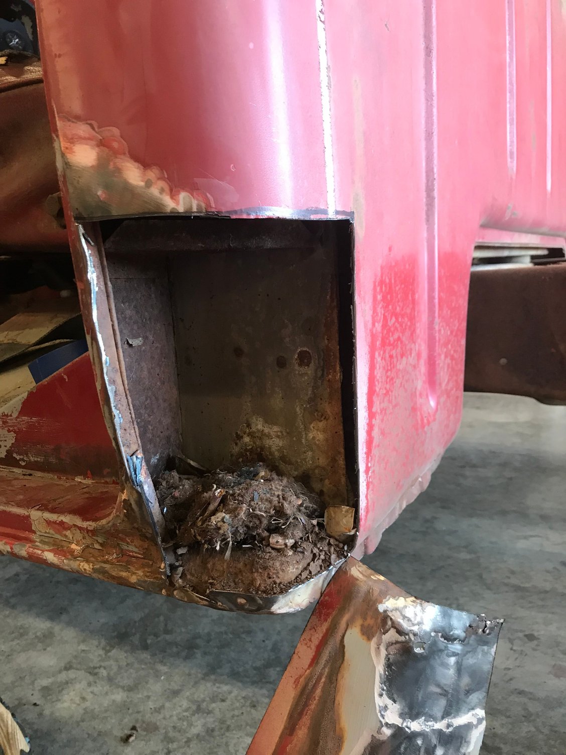

Just a little rust on the cab corner that will be easy to weld up. Cab mounts are in great shape.
Little rust behind both headlights that will need to be fixed so the fender supports actually do something.
Bed came off only had to cut the two rear bolts.
Doors and hood off.
Now to get it back outside for a good power washing to see what all I have to work with. Pretty decent progress working on it by myself. Should get it blasted in the next few weeks. For now I'll focus on the few rust fixes and cab work. Then strip the interior.

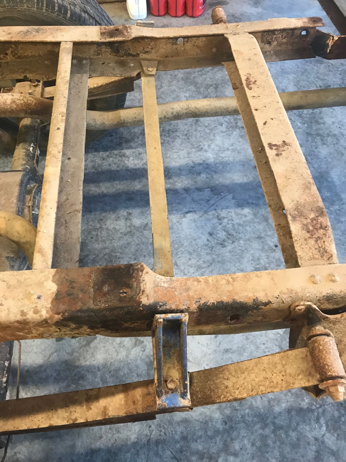

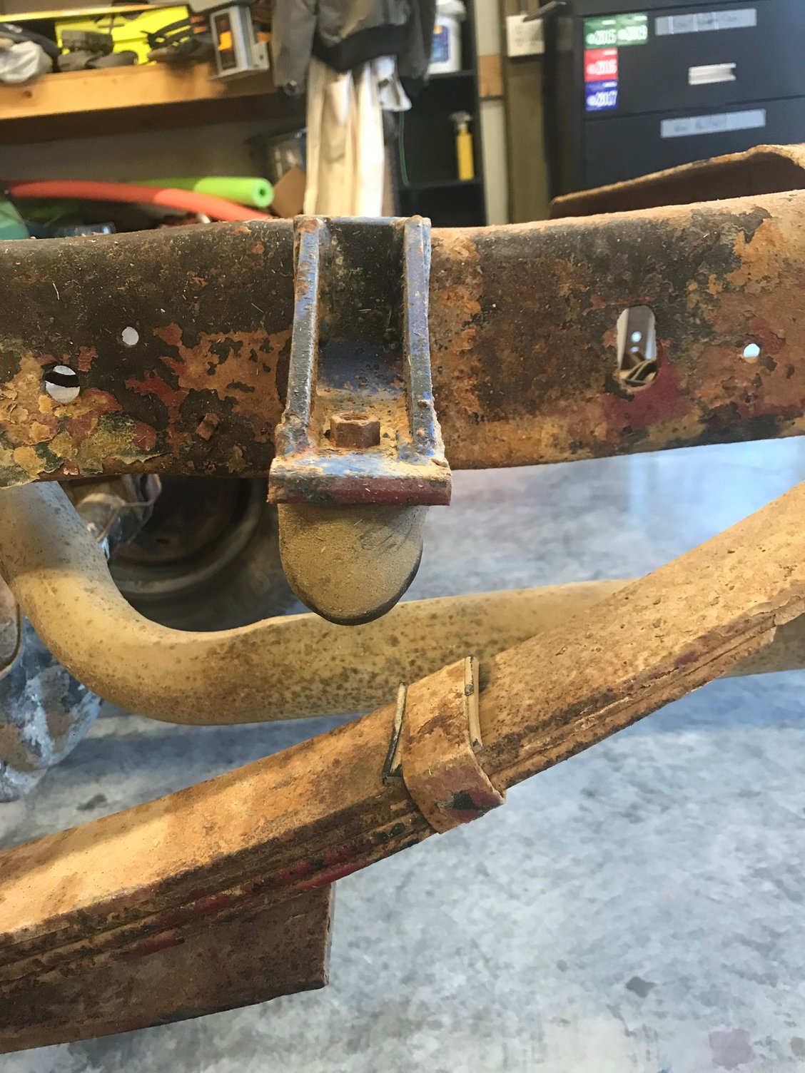

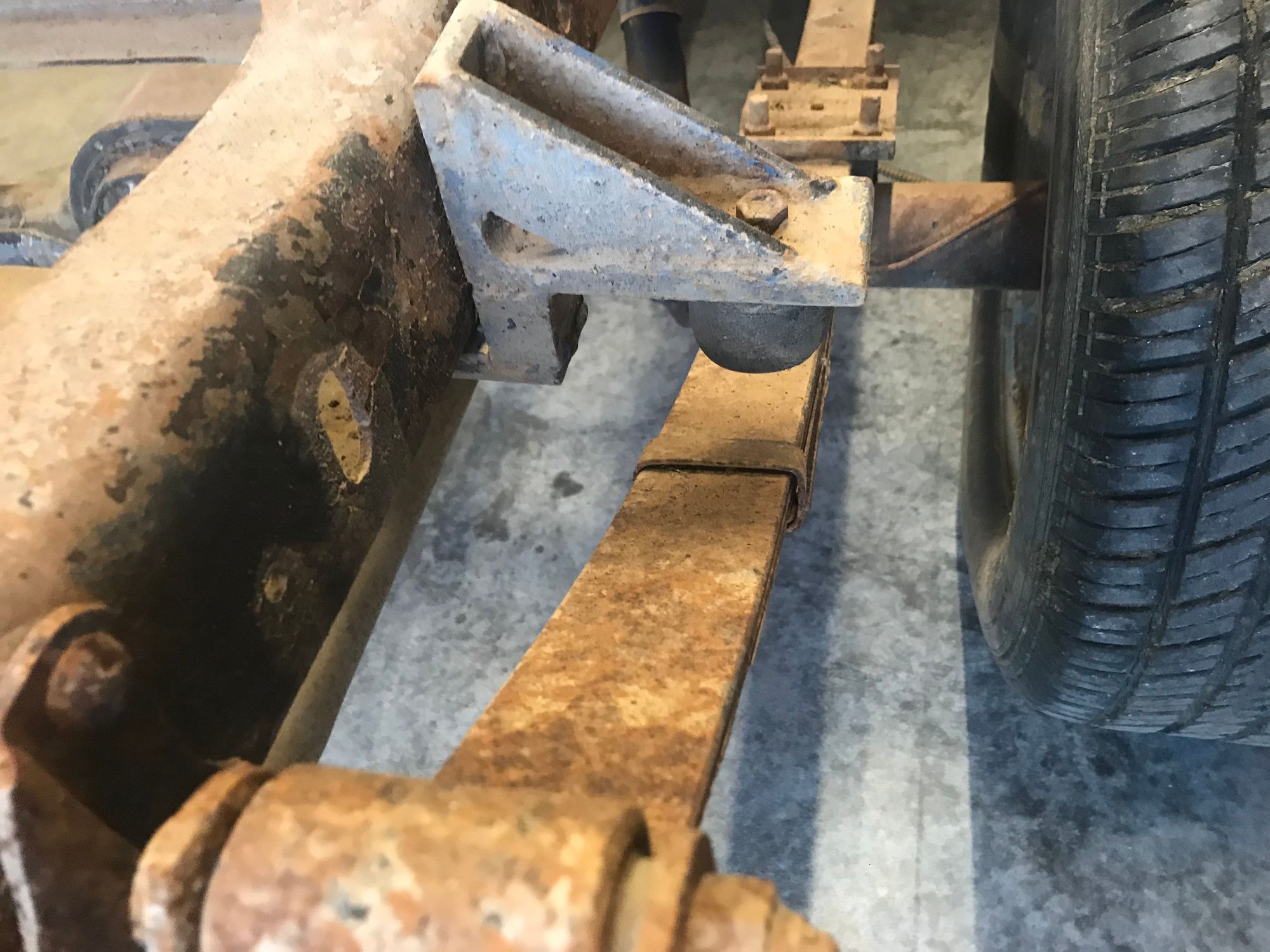

Didnt get anything done tonight but did finally notice this fancy homemade track bar looking thing. Haven’t ever seen one made like that.
That snubber would cause the springs to stiffen considerably when it engaged.
I wonder if whoever made it was trying to replicate the Ford Flex-O-Matic suspension from the late 60's and early 70's.
BTW, keep going! it's looking awesome.

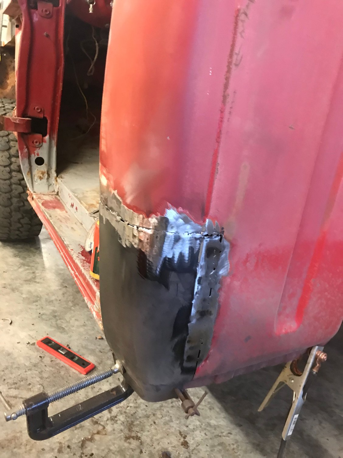

Well got the cab corner fixed. There was a nice collection of stuff behind it. Wire brushed the rust and hit it with some rust primer to help it out a bit. Got my panel fitted up decently and started tacking. The door jam area was bent more than I first thought so it took a lot to fix it. Being no body man as that’s an art I will never master I’m happy with the results. Got it just a touch hotter than I ment to, so it pulled ever so slightly inwards but a little filler and it will be like new. Def night and day from what it was.
Lookin good. Remember the old motto "grind and paint makes me the welder I aint".
With that much collected trash on the drivers side b pillar, I would definitely check the other side and the a pillar as well. Ford didn't design those areas to drain moisture well, so rot is pretty common there and a few other places.
Check the inside cavity that is formed where the roll pan curves up to meet the a and b pillars. Those areas are bad about collecting things. I drilled a big drain hole in each of the four corners to help and sprayed a high phosphate paint into every nook and cranny.
