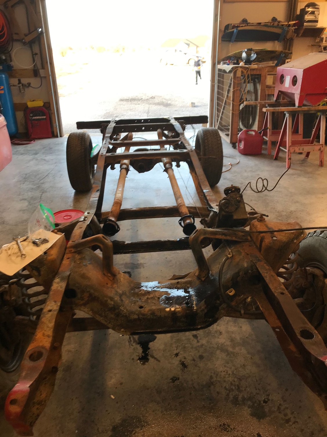

Well at this point I think I might as well go down to a bare frame and start from the ground up. Wasn't planning on going that far but might as well do it right. So I'll build me a stand/cart and pull the cab off, finish up a few things on it and go ahead and get primer on it to keep it from developing any rust. Then I'll focus on the frame tear down. So be a while before the rest of the body get stripped. Leaving it painted as long as I can so it can stay outside. Going to have to get my small loft cleaned up to get some of these parts off the floor and stored a little better.

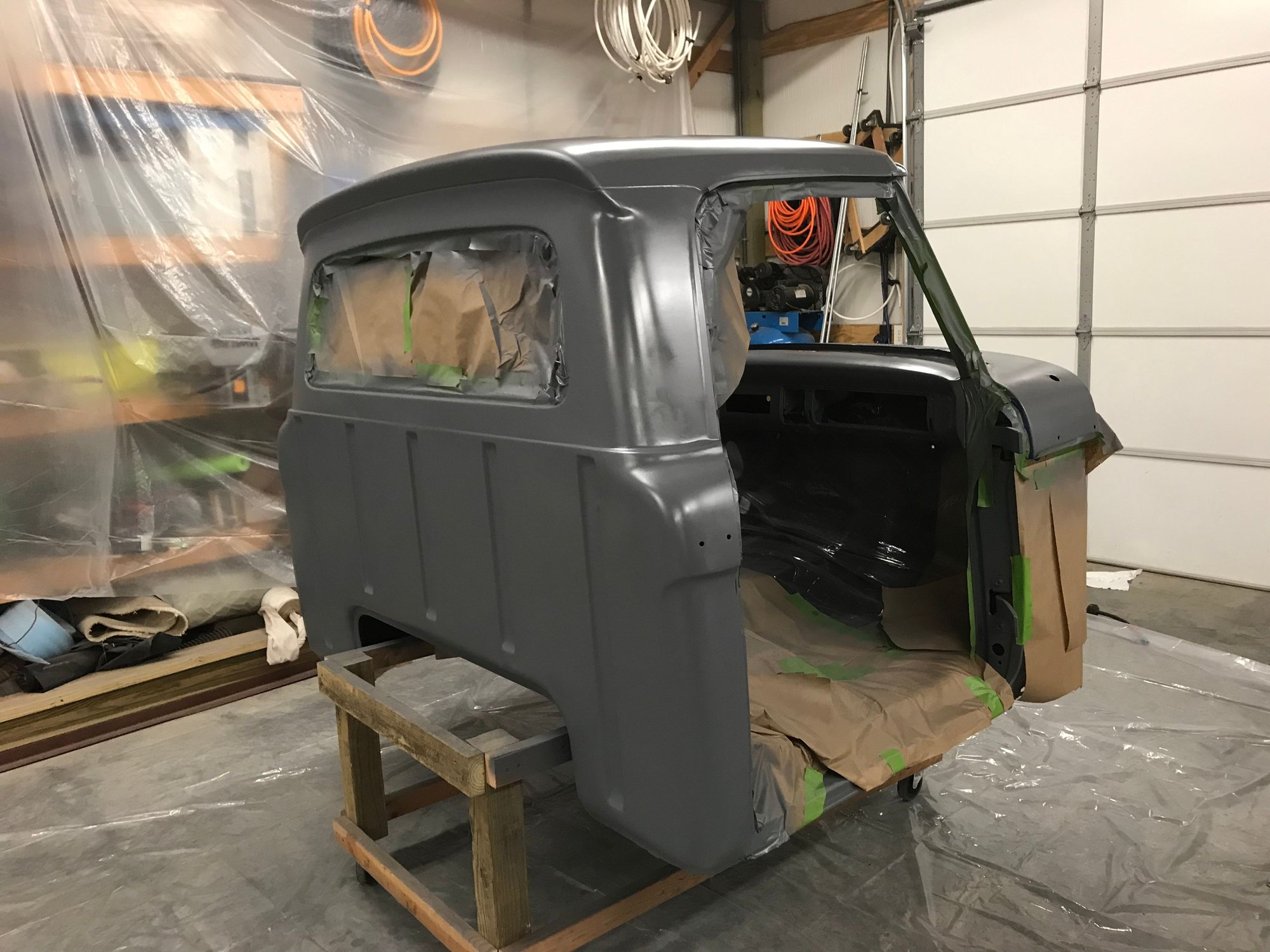

Got the cab bolts pulled and the last ground wire unhooked. Then built a cab stand on some casters so it’s easy to move. Should have help here Saturday to get it lifted up. I’d use my tractor but rather not mess anything up at this point so I’ll wait for him to help me.

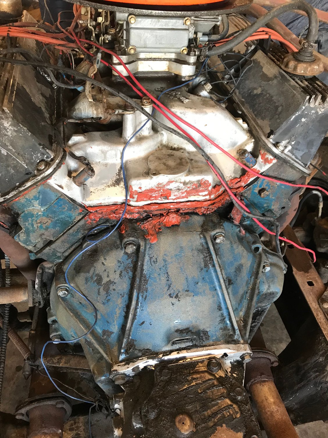

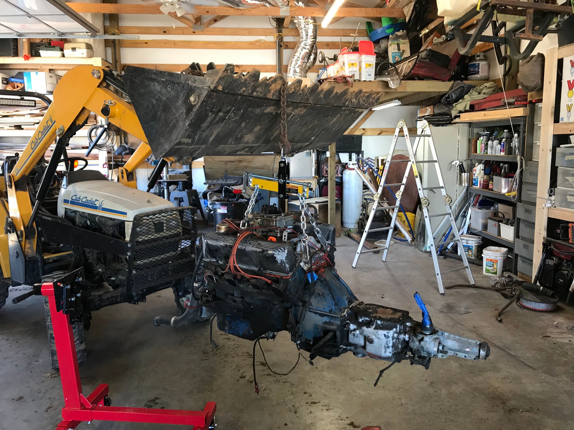

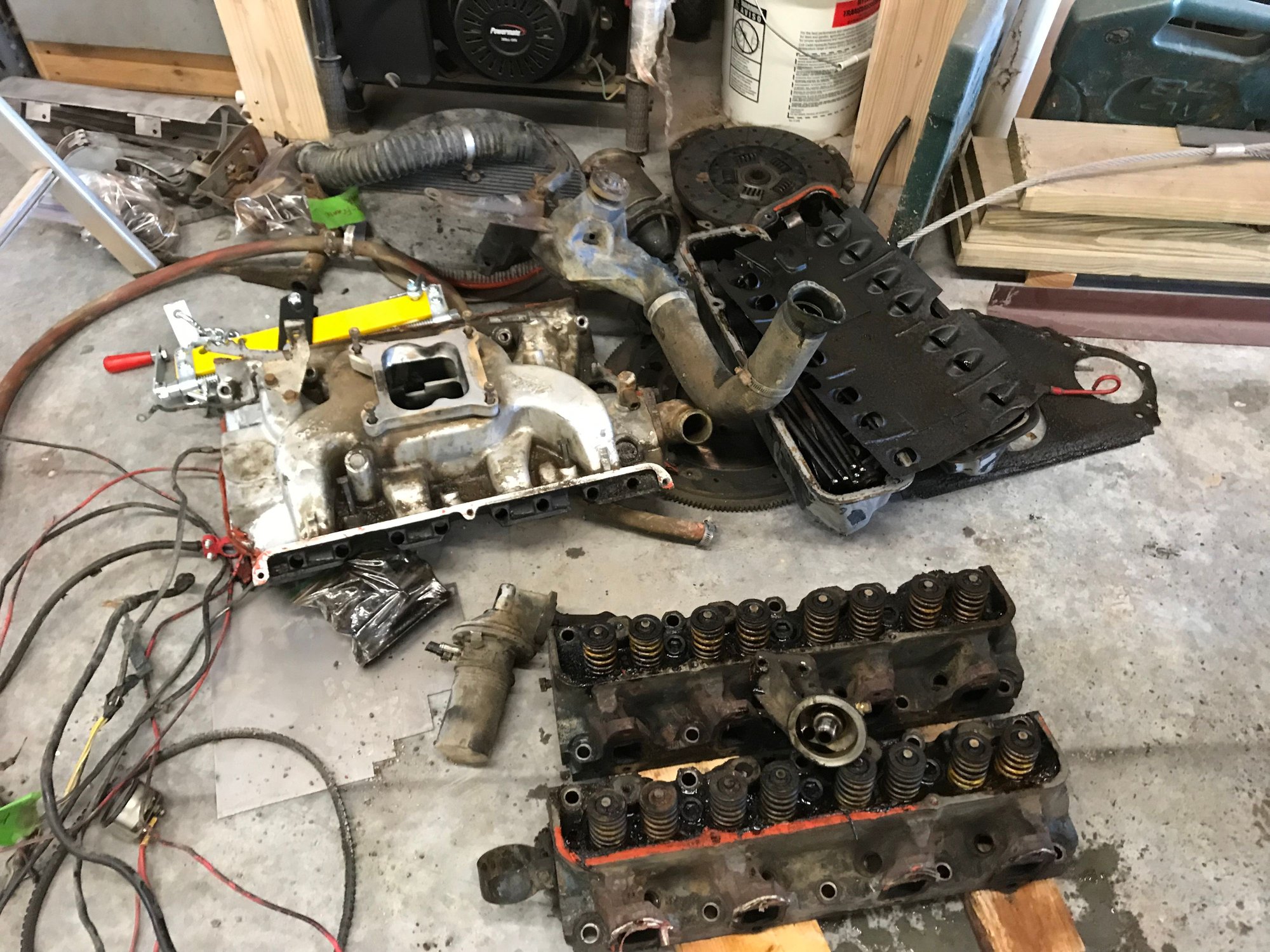

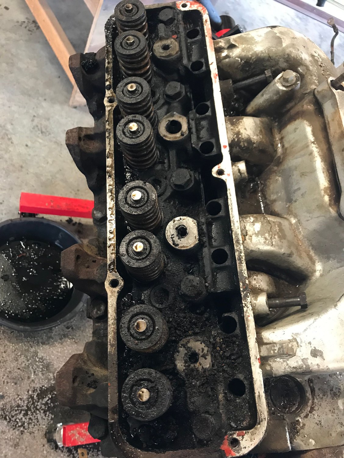

Lot more tear down today. Pulled the cab. Then rolled it back out for some more power washing. Finally found the motor is blue. And the previous owner loved RTV, lot of good it did. Pulled the heads off. It turns out it’s a 390 not a 352 per my measurements and need a full rebuild. Cylinders have a little wear and a few grooves that .020” should take care of. Had as much crud inside the motor as the outside did. Surprised it ran as well as it did.

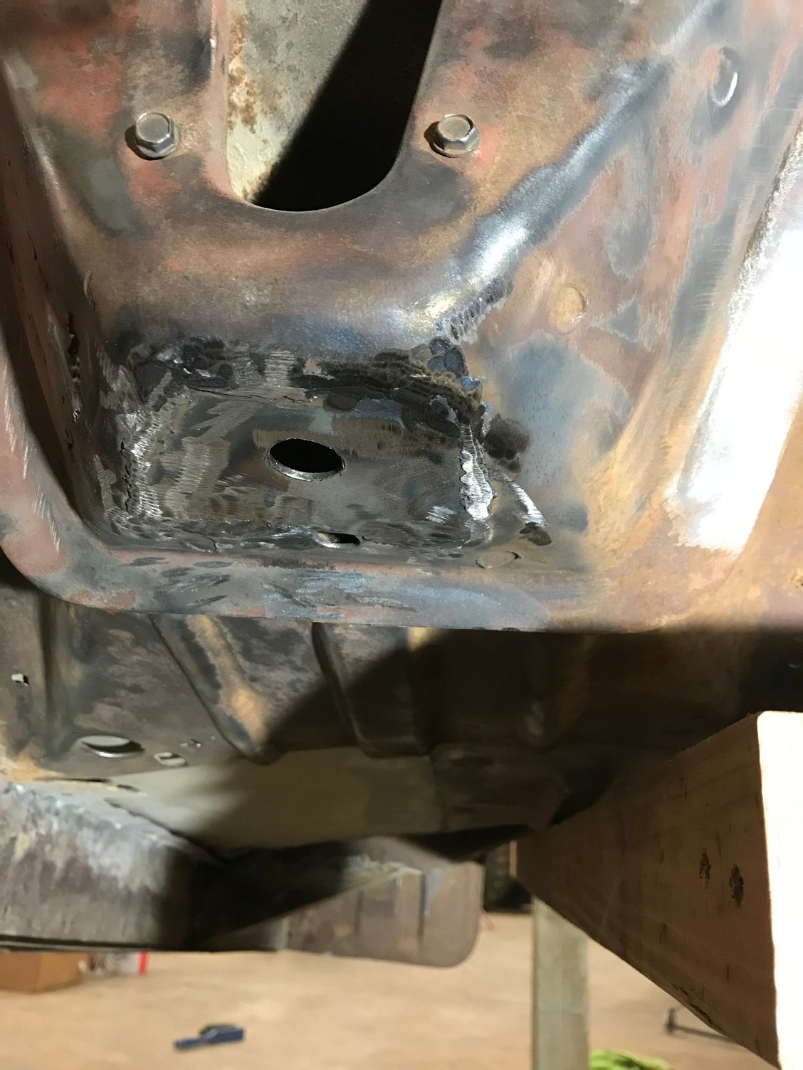

Well I’m glad I pulled the cab. The drivers side cab mount was already replace and from the outside the pass side looked good but it was hiding this
So broke out the cutting wheel, welder and grinder. Almost like new again.

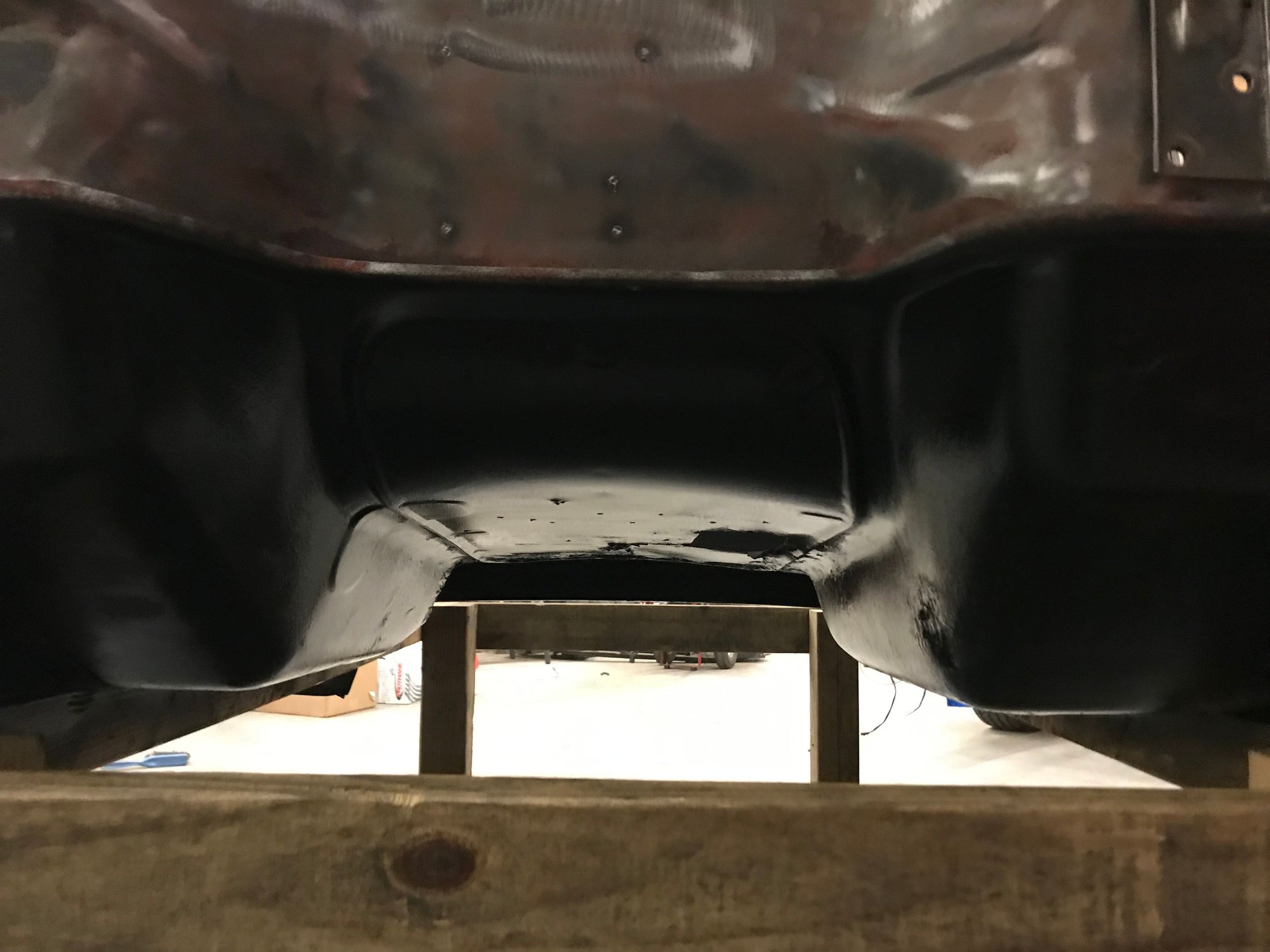

Then more cleaning underneath prepping for undercoating.
Got the first coat of undercoating on finally. I’ll have to move it around to get the spots under the stand but looking like progress.

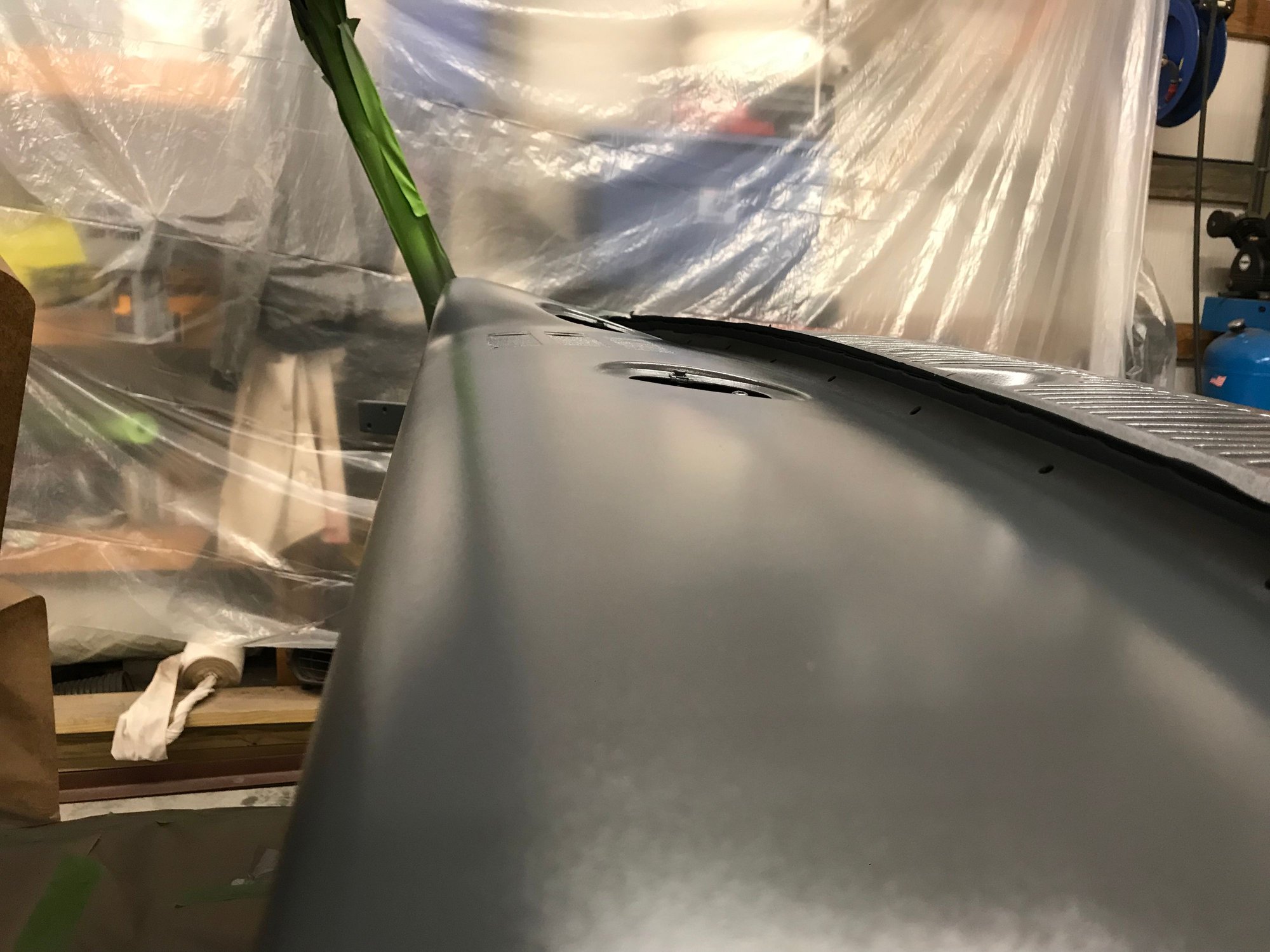

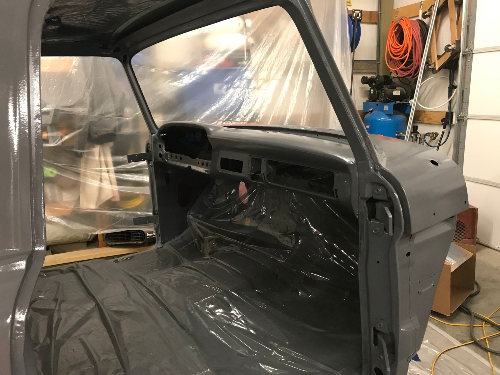

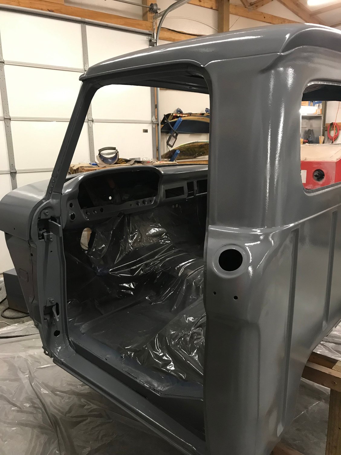

Well finally got the cab primed. Swapped tips out on my gun as instructed by the primer but that was a mistake. Have a few runs to take care of now Second coat shot a lot smoother with the correct tip. Ah well at least it’s coated now vs bare metal. Let it cure out and I’ll get it smoothed out.

The runs looked worse once it dried, so bit the bullet and sanded down the runs and reshot it with the proper gun tip and settings. I’m happy now. Lot more added work but well worth the results.
