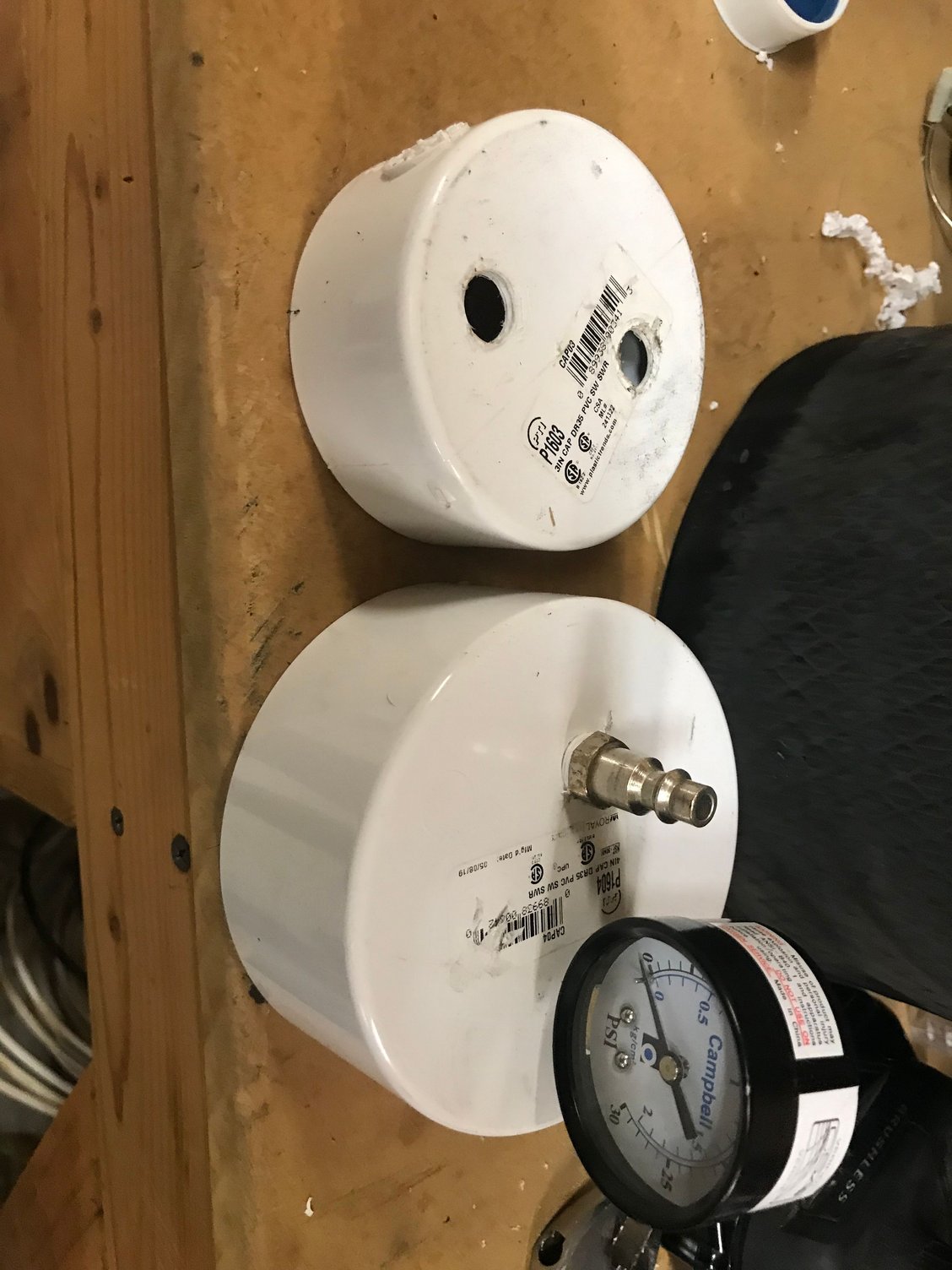

Well. I made a boost leak detector in those 3 inch as instructed in video and 4 inch and neither one of them are correct. I’m not sure I’ve ever seen 3 1/2.

Can you take a picture and show us the issue?
I went and got mine to compare. The cap itself measures about 4" OD, 3.5" ID. It's made to go on a 3" ID PVC schedule 40 pipe.

Well. Mine are three and 4 inch schedule 40 caps but they’re white .
Somehow must be different

Well, if you can’t duck it... 😂

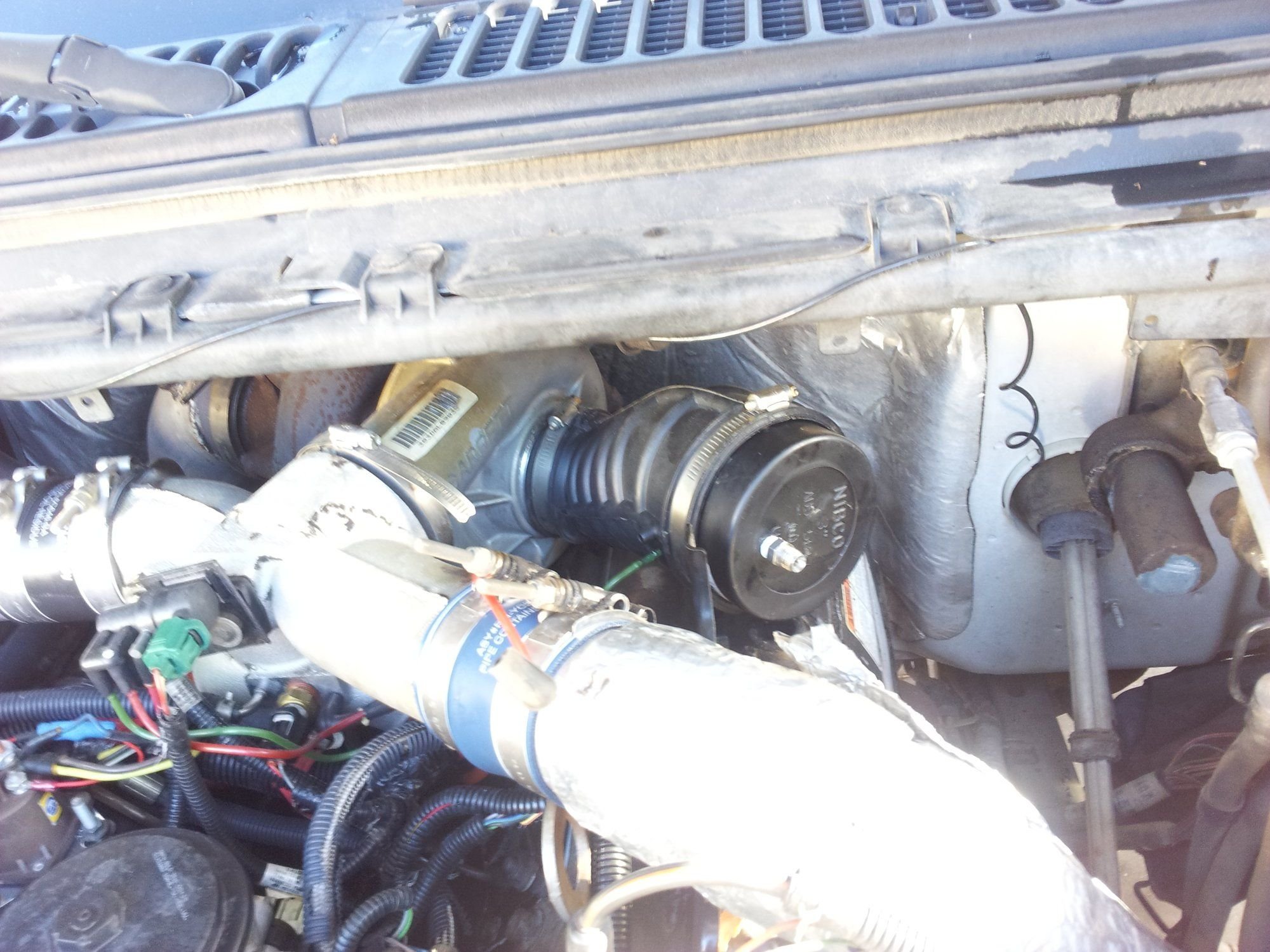

Did find one leaky boot but immediately stopped on tightening. Other spot is front of y piece. Not sure if coming from the bad o ring there or not. What is best way to stop in that area?

For future readers fyi, the above photo in post #36 is shown doing the boost leak test incorrectly. The cap should go in the section connected to the turbo as shown in post #34, not the section connected to the CCV mounted on the valve cover.
As for stopping the leak coming from that section of the Y mated to the turbo compressor, worst case you may have to loosen the clamps of the Y going to plenums, and the worm clamp vband at the oring and rock the spider to mate to compressor better then re tighten the 3 clamps. Might get away with just wiggling and adjusting the worm clamp vband at the oring

Well that’s good to know. Hopefully I didn’t mess anything up... Ironically I got it from the video that was posted above on how to build one. Look at video starting about 320 in. Ugh.

It'll work at either spot. There's several videos besides this one that show connecting at the airbox. It just adds more places to leak air that can make it tougher to locate the actual leaks, but not impossible. Looks like you found some. That's good.
In front of the "Y piece" (spider)? I don't suppose you have the ability to circle the leak on your picture. Irfanview is a safe, free, and easy photo editor - I've been using it since the 90's.

Yeah. The spider. I suspect it is from the plenum boots but need to get some soapy water to find out. I’ve already ordered the plenum boots and inserts anyway so even if it is there this will be fixed. Thanks for al your help.
