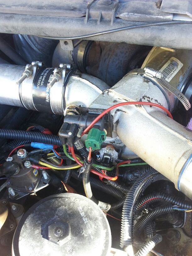

I did that test today, You have to put a bit of duck tape inside the boot to seal the port for the green line, and you also have to attach the red line. My sensor foamed up, the orange boots foamed up and the right side connection to the inter cooler leaked a bit. You need it silent so you can hear the snakes singing to you.

I see you are leaking at y inlet sensor as well

I used the compressor to fill a air tank and used the tank 4 the test.
The compressor would have made way too much noise to hear the leaks.
The sensor and that other fitting as well.

It is the larger tank, but your leak should not be that bad, if you test rig is installed as in the pic with the port for the green line sealed and the red line installed. You should be just leaking past the rings, and leaks in the boost system. Pump the tank to 100 psi and run it down to 20. I was getting about 4 min to look for leaks. U get a lot less time if your hose leaks and the red tube is not installed, just saying. I refilled the tank three times before I got everything right.
