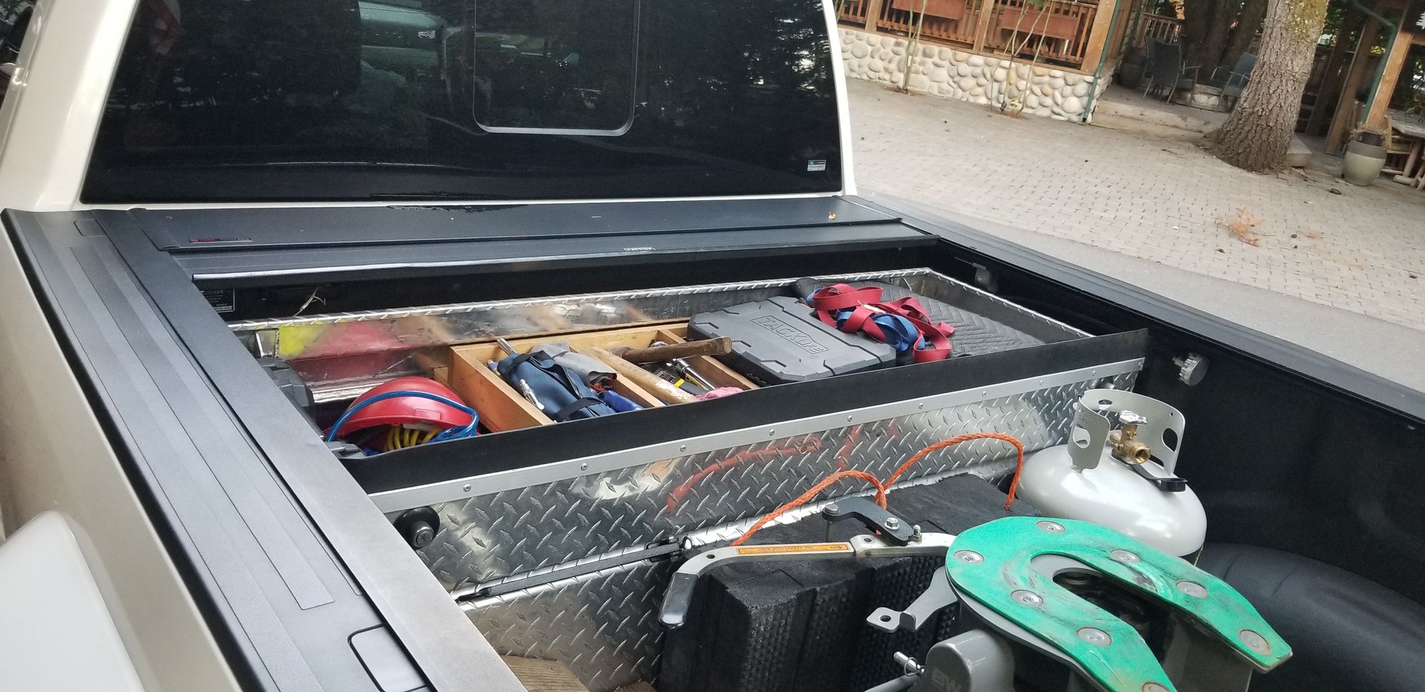

I did both. I did a Bedlocker electric cover and a large tractor supply toolbox, I removed the lid of the toolbox and installed a 3" rubber seal across the top.

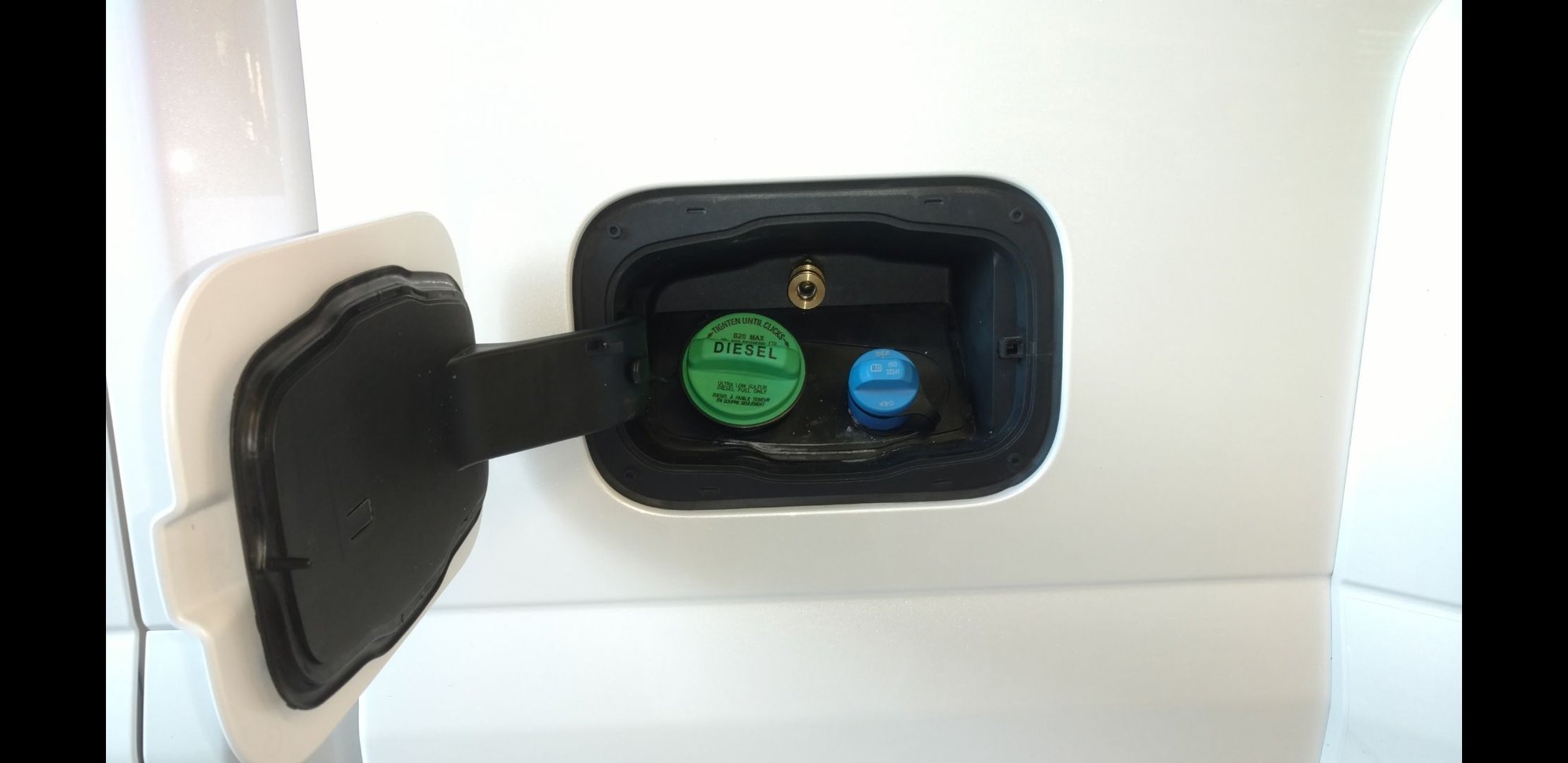

I also did a 200psi Viair compressor in the dead space under the bet cover box. It worked out really nicely. I ran a quick connect to the fuel fill compartment. It works great for adjusting the air in my Trailair pinbox on the RV.

Very nice setup.
My last truck was a Reg cab and I had a tool box with a roll up cover behind it. It worked great but the boxes are hard to seal up(the new ones look worse)and if you drive a lot of gravel with the cover closed everything will have a layer of dust on it. My new truck is a CCSB and I just put a tool box on it since anything I need to keep dry will go in the back seat.

Nicely done. I had rust issues in my GMC bed where the Extang soft cover sealed around the stake pocket. Salty winters up here and sometimes trying to seal out ends up sealing in. I have been leaning towards the tool box rather than cover. Only real concern is damage where it mounts to the bedrail. The aluminium seems pretty thin.
