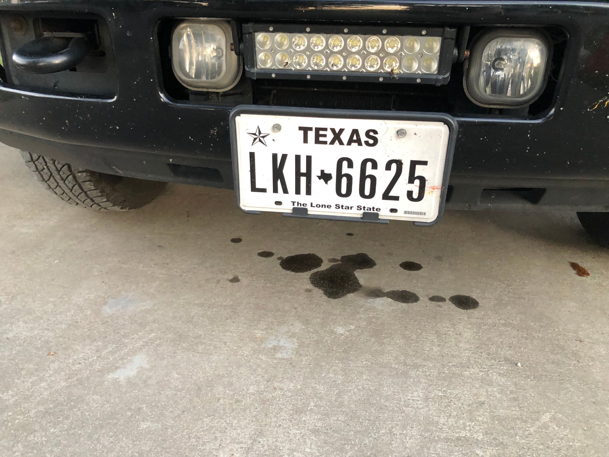

This was what leaked out overnight the night I found the “problem”.

The spray pattern looks more like the top of the radiator. When G05 dries, it drys while. While not a great coolant for a 6.0, it’s heat for tracking leaks in any Ford product that uses it.

Glad to hear you made it home. I hope you do find something other than headgaskets. The fan spraying coolant that hits it sounds plausible. Don't trust the temp gauge on the dash though. Its nothing more than an idiot light and if it goes up its too late. Get yourself that edge insight and monitor your deltas.

Looking at the more recent pictures, I agree it doesn't look like that stomach-churning milkshake. I can only hope on your behalf that it won't be nearly as drastic as I first predicted.
