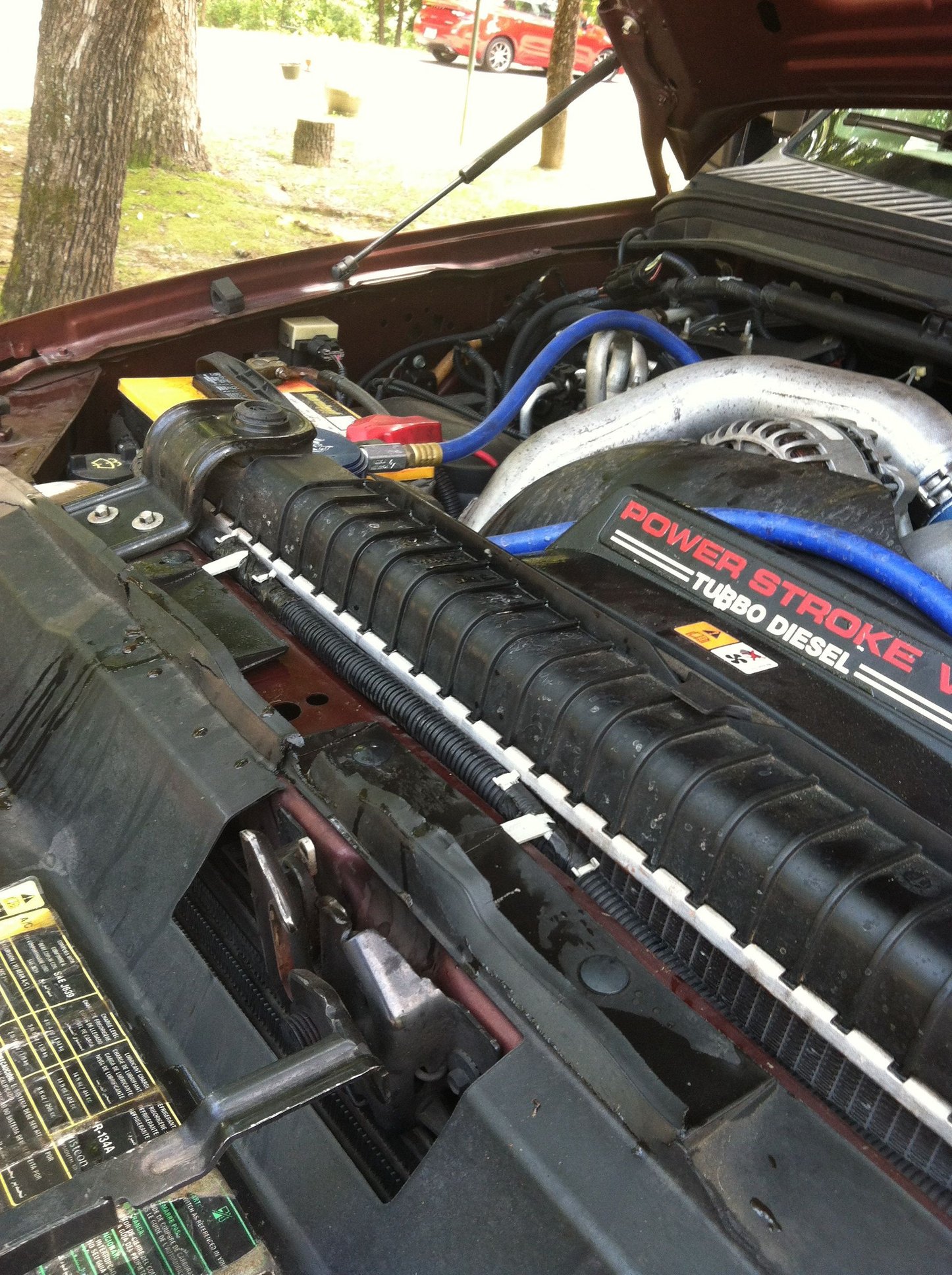

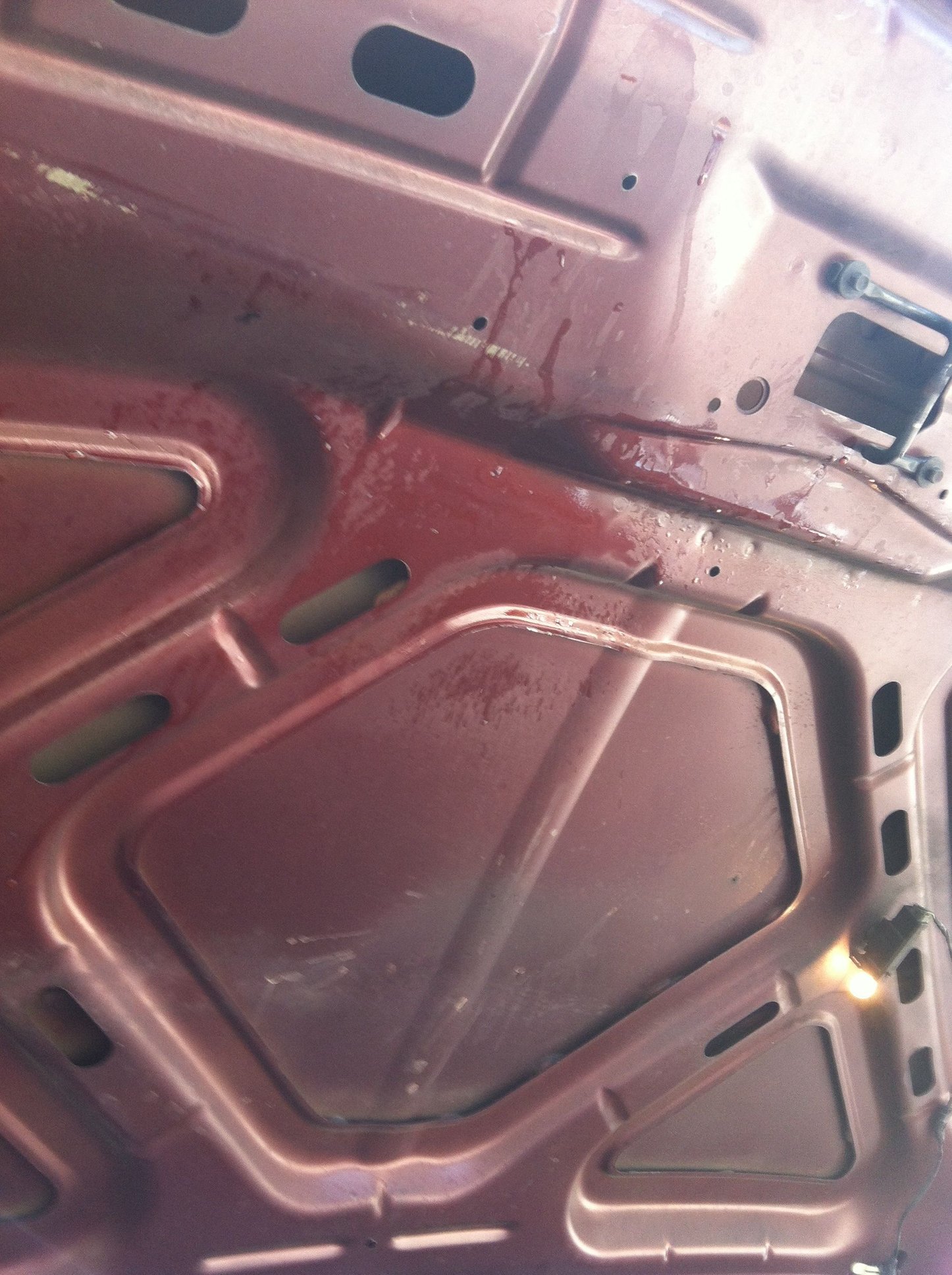

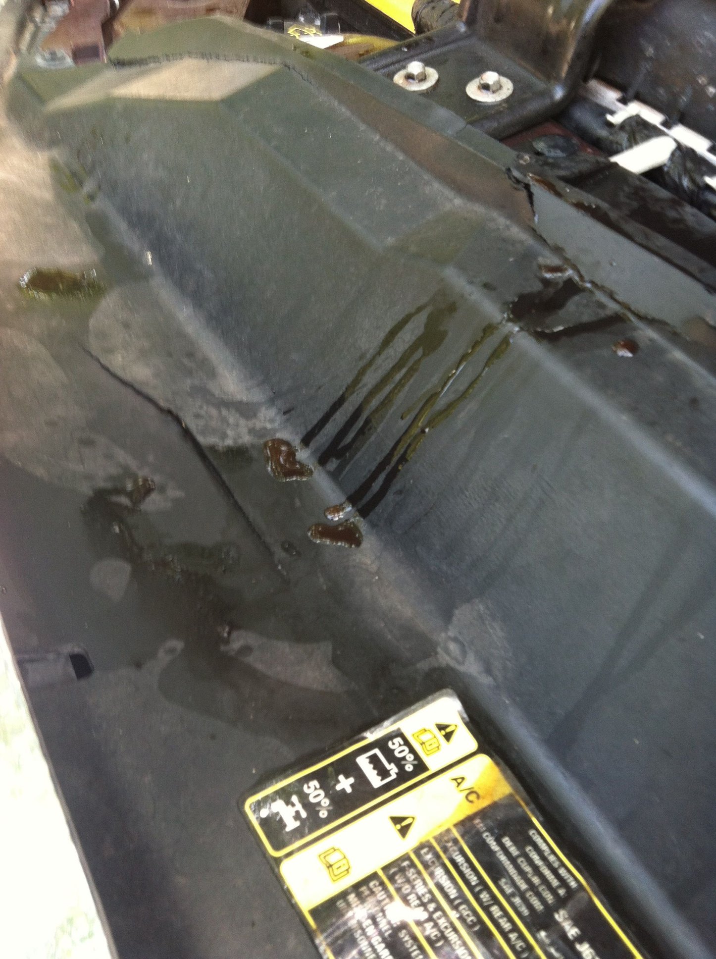

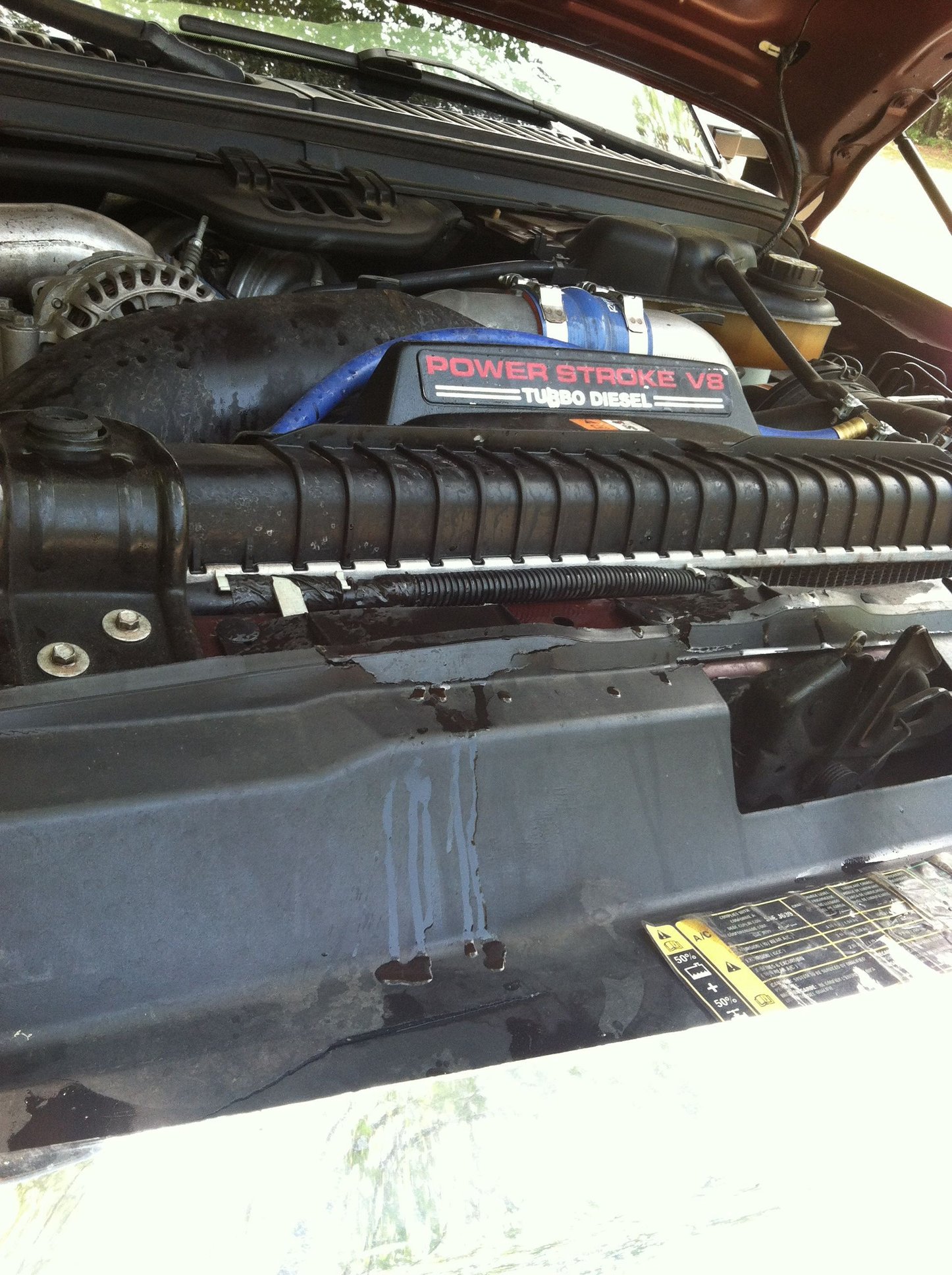

Well, on a short camping trip just one and half hour drive. Temps were warm but fan was working well. Got out of the truck to register at the camp grounds and smelled antifreeze. Popped the hood and:
My first though was radiator being it seem to be on the passenger side of center but I can't see any problem at all. Coolant filter lines look good also. A pressure check will show the problem I guess. Not really lookin to wrench on the truck at the camp. Coolant level is just visible in the bottom of the degas bottle so I'm thinking I can top it off and get home ok. Anybody seen one fail like this? Other considerations or possibilities I'm missing? I'm thinking I'm about to do business with Mr. Mishimoto...

That sucks Rusty. Due to the location ( I just opened my hood to compare where the coolant was on the underneath side of your hood with mine ) I would think it would have to be the radiator, or perhaps one of the lines from your coolant filter are leaking. You could start it with the hood open and get it hot and see where it is coming from.

Radiator tank upper seal. You might try tapping on the crimps AFTER you get back home OR it could be a tank crack that's opening and closing.

Thanks guys. The pics were taken shortly after a 45min pull at 65-70mph. It was pretty hot still and the only clue was the puddles. Common ECT/EOT was 214/218 and climbing a little from there on the hills but the fan would ramp up to 2500-2900 for a few seconds and temps would come right down. So I was feeling pretty good about how things were going.
I'm thinking like you guys, the plastic tank or it's seal has failed. It only lost a quart or two and nothing lower on the radiator looked wet. No puddle on the ground. I did notice another advantage to the red ELC is it has a strong smell, no ignoring there was an issue .

I suggest after you get home because the aluminum crimps can be flaky anyway. They can and do repair those radiators as the tanks are available but I wouldn't personally do it. I've seen new radiators with the tabs around the tank fractured from manufacturing and radiators aren't that expensive. I would only do it on the road in an emergency.
FWIW--my tank cracked for absolutely no good reason at all. I just came home from work one day and it puked in the driveway. It hadn't been touched in months.
