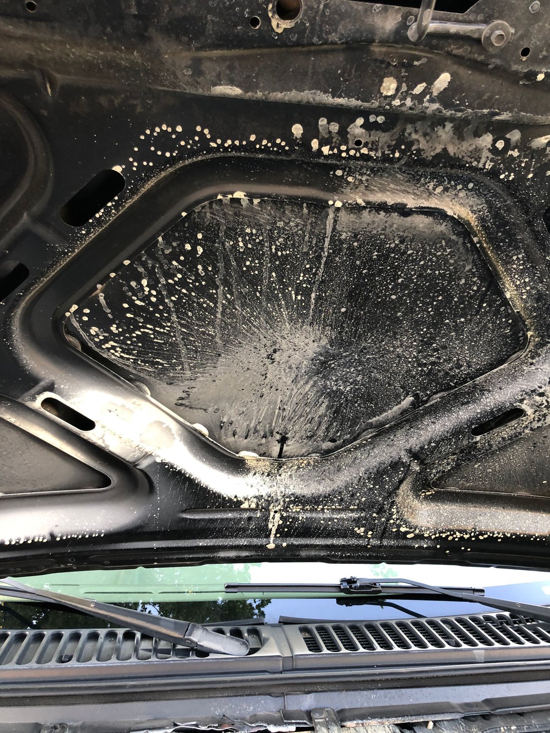

Also, if my head gaskets are toast, I’m unsure of how to move forward. I’m 5 hours from home and am with the family and my camper. Oh boy...starting to question my Excursion buying decision now

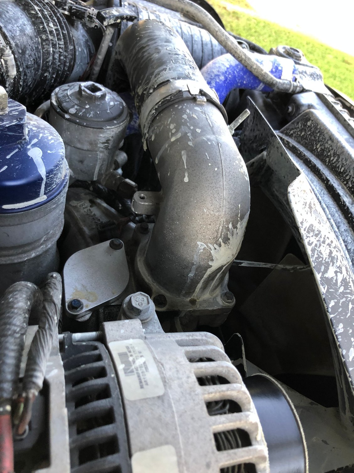

So, if my head gaskets are toast, where would the “stuff” be coming from? The head gaskets were actually replaced by a ford dealership by the previous owner.
Thanks for the advice on the Edge Juice. I hadn’t completed my research yet so was unsure of the right monitoring choice. I have a SCT tune by Mad Matt’s Diesel in Aledo Texas. Have been using PSP Diesel out of Houston for oil bypass and general maintenance.
To me I don't see a 'milkshake' in that picture. If you had coolant/oil mix it would look like chocolate milkshake. Only white residue is dried coolant. It vented out of the degas bottle cap once the pressure exceeded 16psi. If you have that chocolately stuff then you have an oil cooler failure as well.
I'm not familiar with that tuner, but haven't researched tuners lately. Are you running this tune while towing? Is it a performance or towing tune? Is the truck studded? I know a lot of dealers will just re-do the gaskets with new TTY bolts. I think sometimes the bulletproof term is thrown around too often, as having a dealer replace gaskets without decking the heads or doing studs is far from what I'd call bulletproof and a sure bet you'll be doing the head gaskets again in short order.
Just to clear things up what is the oil bypass you speak of? I see PSP is a BPD preferred installed so if you have the BPD remote oil cooler than that's a really really good thing, if you can get the gaskets worked out then you'll be doing really well.
If there's a Ford dealer nearby you can pick up a new degas cap just to be sure yours isn't venting prematurely. Most people aren't that lucky but it's cheap to try.
That's a tough one, I'm not real sure where to go with that one.

Bottom line is your coolant system should never have enough pressure to blow coolant out that violently. Coolant pressure should be 8–10psi tops in a healthy system and that is just from thermal expansion. If your oil cooler ruptured you sure don’t want to run it. Take a sample out of your oil pan. Coolant will fall to the bottom and you should be able to catch half a clear water bottle to see what’s in your oil.

Looks like some oil splatter too. Find out where that’s coming from.

Kind of does but kind of hard to tell, but after looking closer I can see the stock oil filter cap so he doesn't have the BPD remoted oil cooler so yeah oil cooler failure is still on the table.

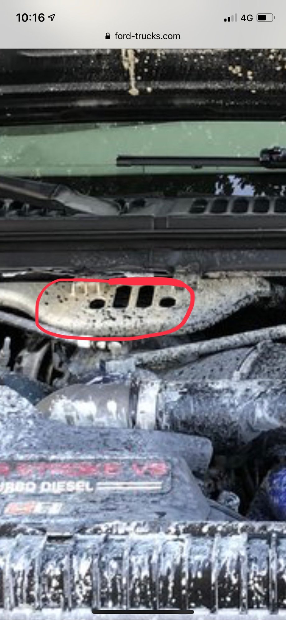

look at the splatter pattern.....
Okay, I’m stumped for the moment. Just pulled into our campsite and saw some white residue that was coming from under the hood. Opened the hood and this is what I found. No hot temp while running, no indication of anything wrong. Just this stuff all over the inside of the engine bay. Engine coolant is low (or non existent). Is that what’s going on...coolant leak?
I think you have an issue somewhere in the middle of the engine. Look at the pattern. It is lighter on the degas and heavier in the middle. If there is a harbor freight near by pick up a cooling system pressure tester, or try to rent one from a parts store nearby. Top off the cooling system and pressurize it. Check the area on the radiator that you suspect, all hose clamps, hoses etc. I had a front main seal go bad on my truck and it tossed oil all over the place. It looked like it was coming from one area, and was the opposite end. You can also build a pressure tester and road test the truck.
