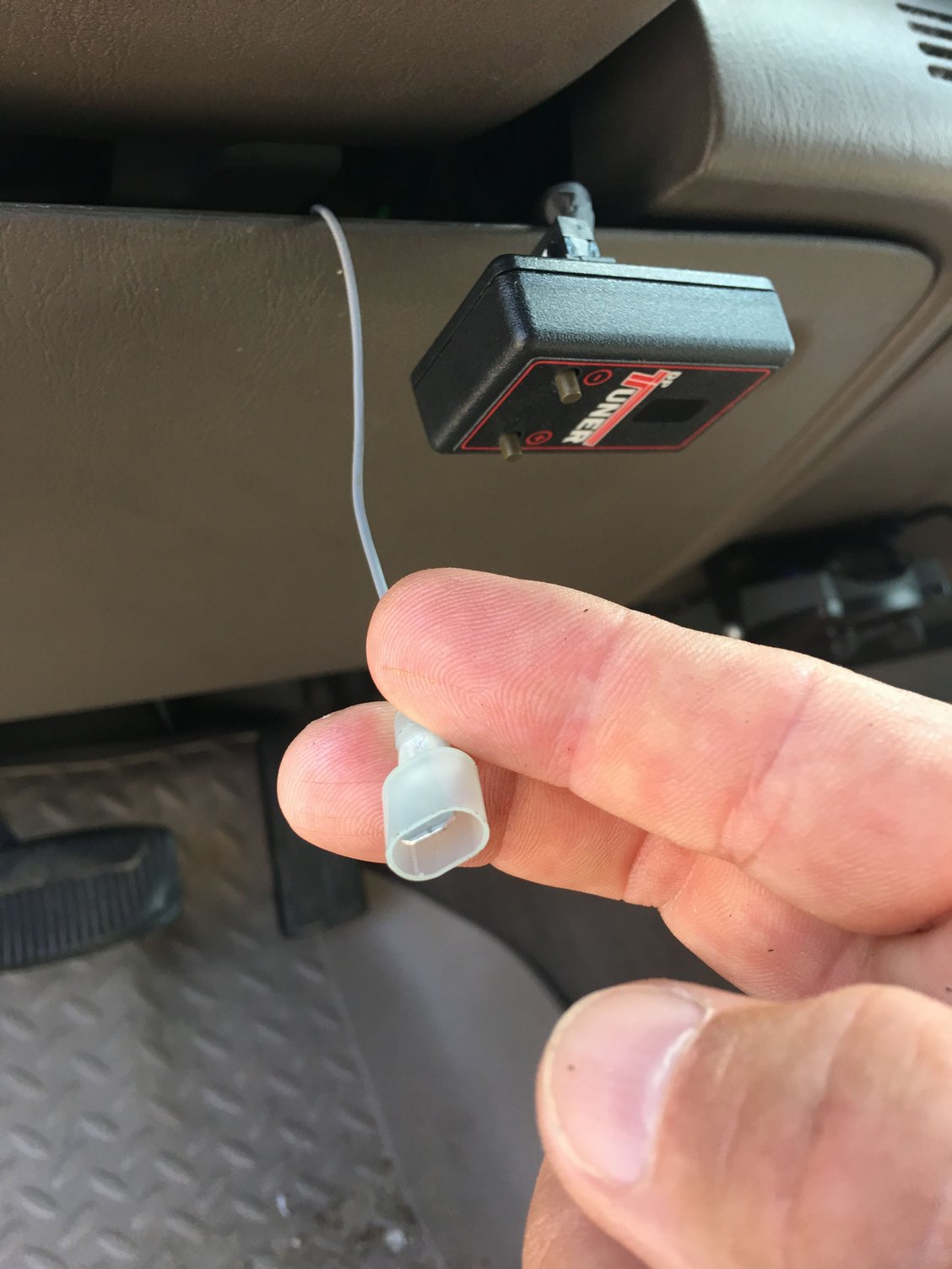

This is the grey wire I mentioned in the original post. I am not sure if it is important or if it was even plugged in. Also, I'm not sure if it was maybe plugged into the fuse block area and possibly became unplugged when that was moved forward.

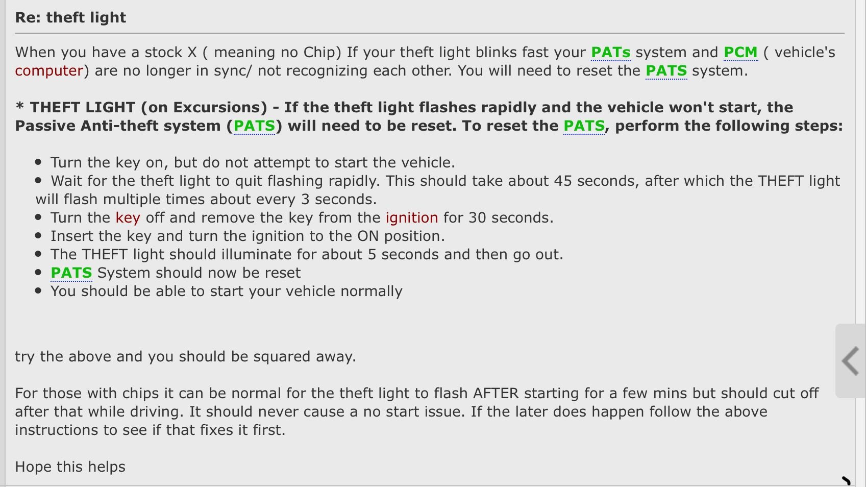

Editing to add the following info that I had saved from my previous troubleshooting of the PATS system: When you have a stock X ( meaning no Chip) If your theft light blinks fast your PATs system and PCM ( vehicle's computer) are no longer in sync/ not recognizing each other. You will need to reset the PATS system.
* THEFT LIGHT (on Excursions) - If the theft light flashes rapidly and the vehicle won't start, the Passive Anti-theft system (PATS) will need to be reset. To reset the PATS, perform the following steps:
  • Turn the key on, but do not attempt to start the vehicle.
  • Wait for the theft light to quit flashing rapidly. This should take about 45 seconds, after which the THEFT light will flash multiple times about every 3 seconds.
  • Turn the key off and remove the key from the ignition for 30 seconds.
  • Insert the key and turn the ignition to the ON position.
  • The THEFT light should illuminate for about 5 seconds and then go out.
  • PATS System should now be reset
  • You should be able to start your vehicle normally

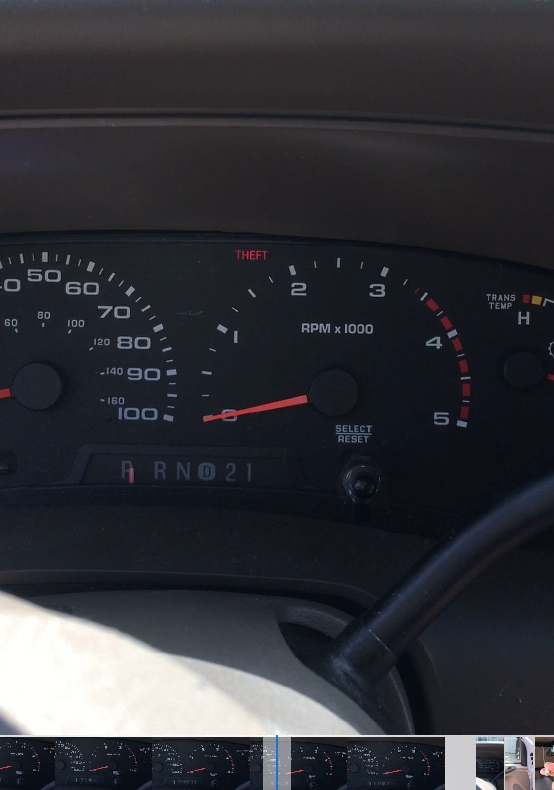

Theft

1st attempt using procedure
OK, so I attempted to use the directions to cancel the Pats system. I waited over 45 seconds and the theft light never blinked rapidly. When I went to put the key in a second time the theft light blinked once every 1 to 2 seconds. I would upload a video showing this but it will not allow me to do that .

OK, so I attempted to use the directions to cancel the Pats system. I waited over 45 seconds and the theft light never blinked rapidly. When I went to put the key in a second time the theft light blinked once every 1 to 2 seconds. I would upload a video showing this but it will not allow me to do that . Has anyone seen or knows anything about the gray wire in the photo at the top?

Did you try to start after disconnecting the tuner? That grey wire seems to be aftermarket used for something else.

Tuner
I thought the gray wire also looked like something that went to an aftermarket device. I just wasn't sure. We purchased this vehicle recently so I'm not real familiar with the tuner and I'm still trying to work the kinks out of the vehicle. This problem occurred yesterday and my first reaction was to take the top cover and bottom cover off of the column to see if I could observe any cables or anything else that might have gotten loose. When I finally figured out the problem and put everything back together the vehicle wouldn't start and I noticed the theft light.

The gray wire is some add-on.
When the key is in the on position does the theft light flash rapidly or does it turn off? If it turns off the PATS is working and isn't your starting problem. If it's blinking rapidly try a spare programmed key if you have one. Also, if it's flashing and you leave the key on for about 30 seconds or so it'll flash the fault code. It'll be one flash followed by 3-6 flashes to give the 2 digit fault code.
Once we know if the light is flashing or off when the key is turned on we can go from there with the no-start.

I’m Not sure if this was what was posted earlier or not but maybe it’ll help
