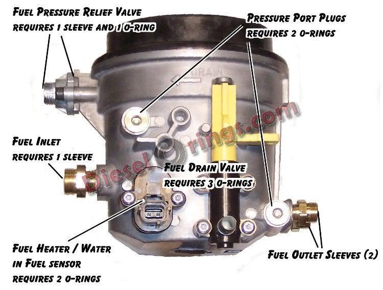

- Fuel pressure in the bowl - turn the yellow **** behind the bowl and Diesel should pour out from behind the engine to the ground.

Here are some reference diagrams.
This is the back of the Fuel Bowl.
This should give you an idea of the Sensor locations.

- Fuel pressure in the bowl - turn the yellow **** behind the bowl and Diesel should pour out from behind the engine to the ground. I heard a trickle noise but not much pressure, did CD so on the ground and can smell it
