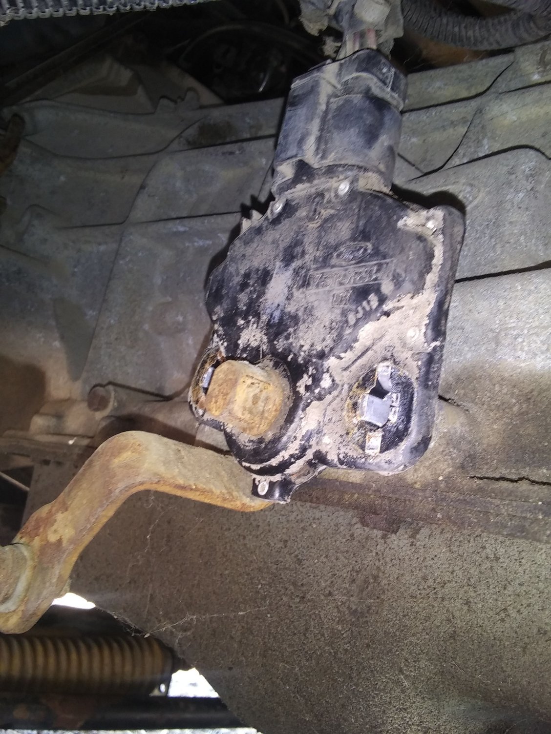

Question, when replacing the NSS, does the center bolt come off, or does it slide over the attachment? Looks like this:

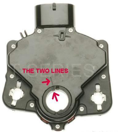

If I recall right it just slips off after the nut ans bracket are removed.
With the gear selector in "N" line up the lines and bolt it in place.
Attachment 282936

Ok thank you
