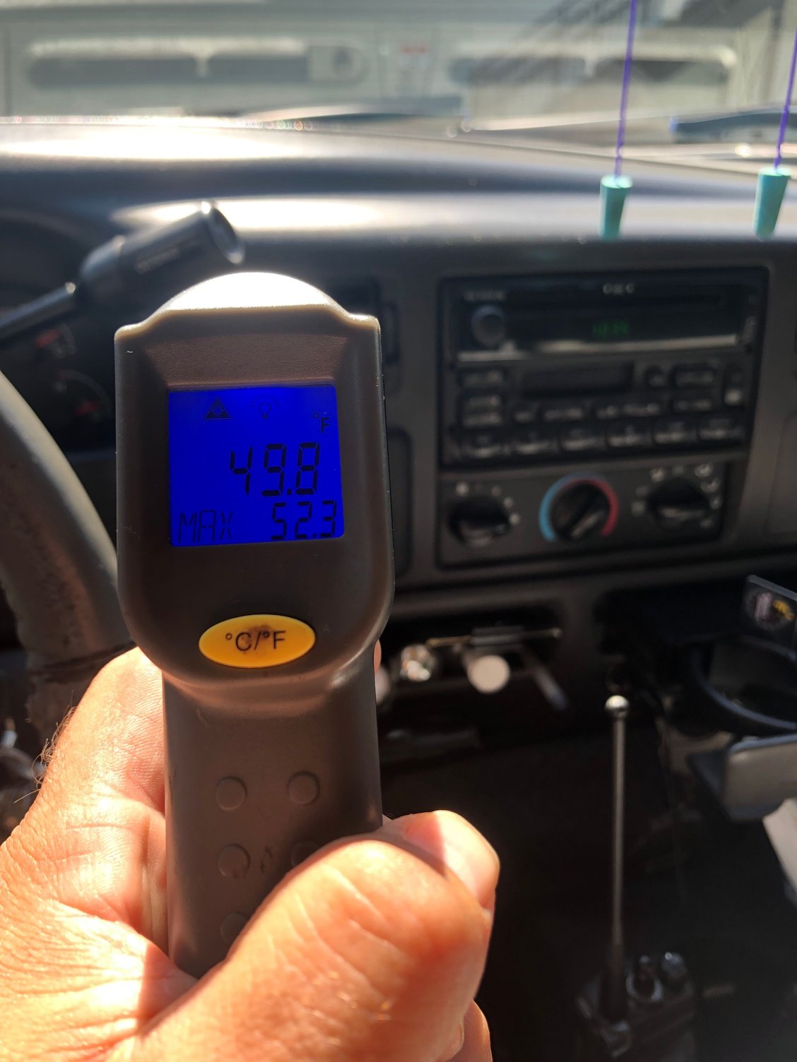

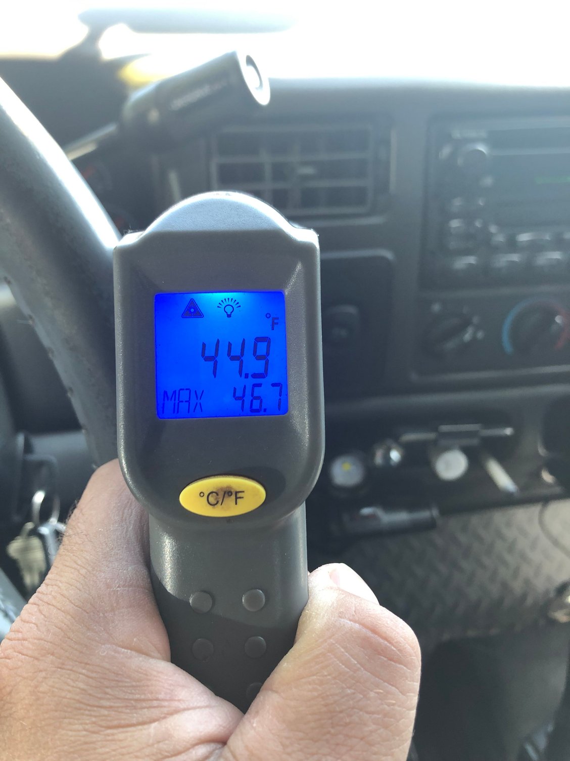

Before coolshot at 1030ish in the morning outside temp was about 75 degrees
This photo was after cool shot and a 30 min drive to work outside temp was 88 degrees at 3pm
I was sent a sample off this cool shot by the author of this thread so here are the results

What do you think? Snake oil or legit?

The numbers are there u decide for yourself.

Leonard- Just curious if you were driving it for a while with the first temp. reading, or sitting in the driveway.

Drove for about 20 minutes then took reading on first pic. Drove for 30 min then took second pic
