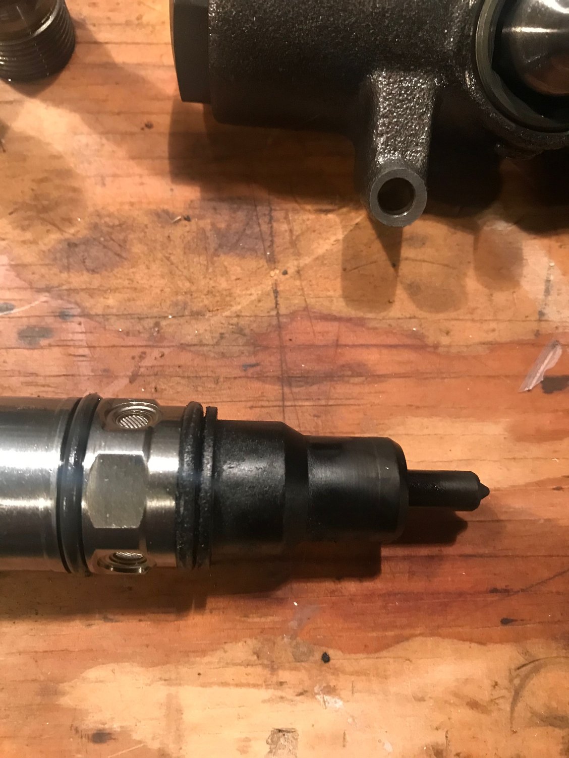

Here are a couple pics of the injector. The bottom oring is pretty crusty but doesn’t look damaged to me. What do y’all think

Your copper washer was not sealing. It should not look like that at all.

As Pete said, you’ve got combustion gases and carbon on the bottom section, a tell that the injector was loose. That would be the cause of the other injectors not getting proper fuel.
You are going to need injector bore brushes to clean out the bore sides and bottom. If you didn’t do that on the last injector install, that could have been the cause of this.
And replace the o-rings and of course the copper washer.
I got my injector bore brushes from XDP at a reasonable price.
Did you get the copper crush gasket out yet?
To me it doesn't look like it had one on it. Seems like there would be scratch marks on the tips if the gaskets are stuck in the cup. If I remember correctly the copper gaskets have 3 tabs that grip the tips.
