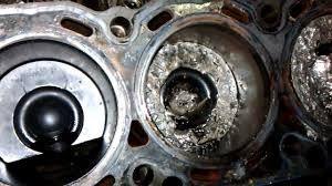

I had cylinder 2 show a slightly lower contribution when cold using IDS relative compression but was fine when it warmed. When I pulled the motor down this is what the injector hole looked like.
And this is what it looked like when I was done the cleaning. You want it as clean as you can.

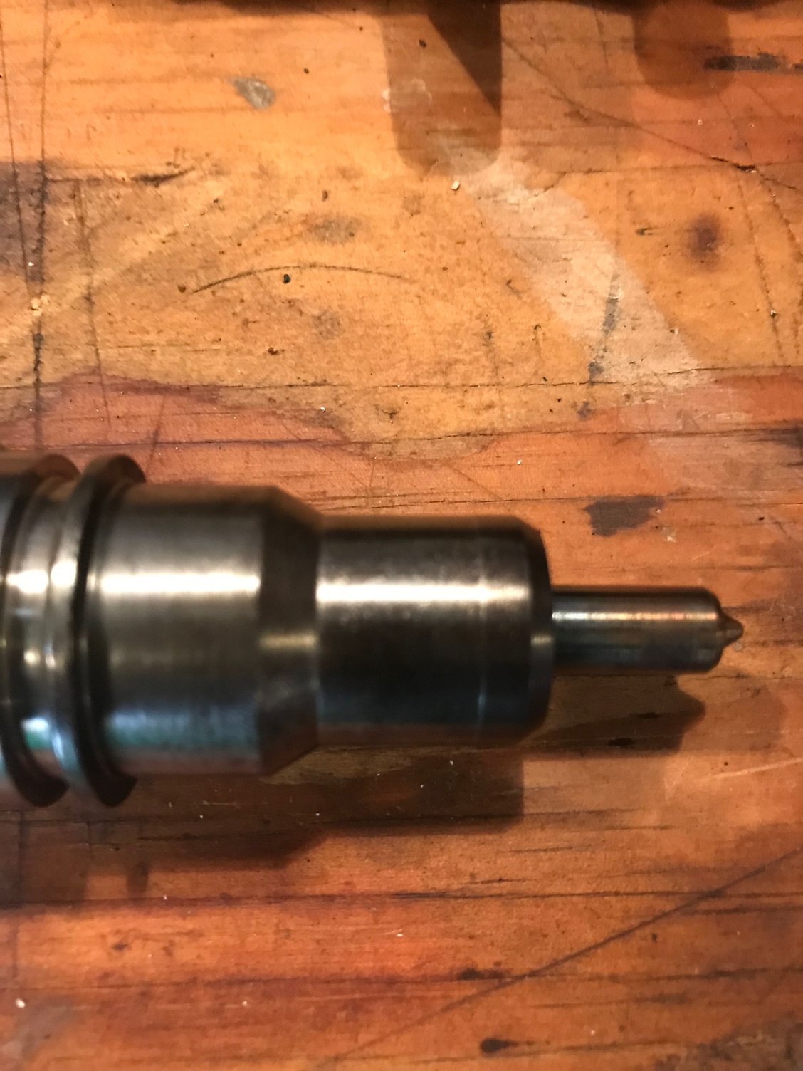

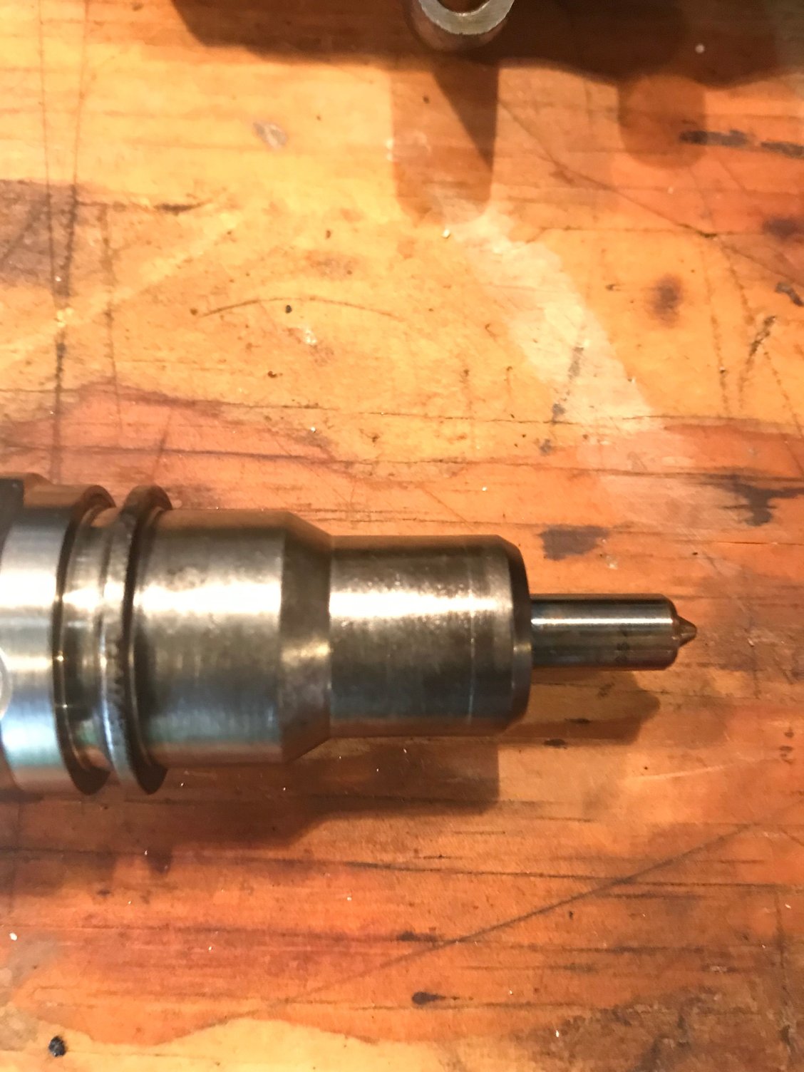

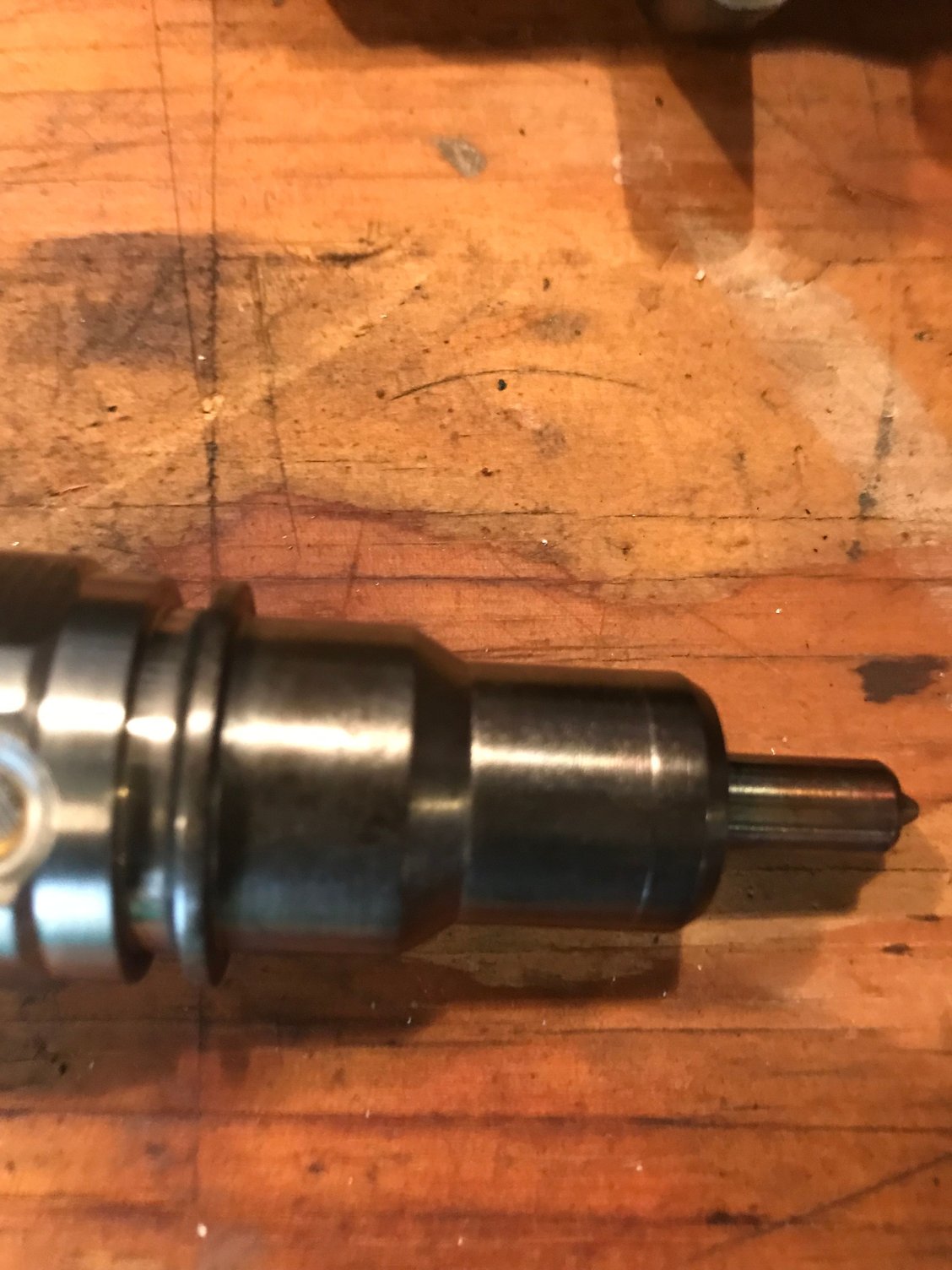

Here’s
a few pics after I cleaned the bottom of the injector. What do you think?

If that is a Ford reman and as you say only a few months old I think I would be using the warrantee.

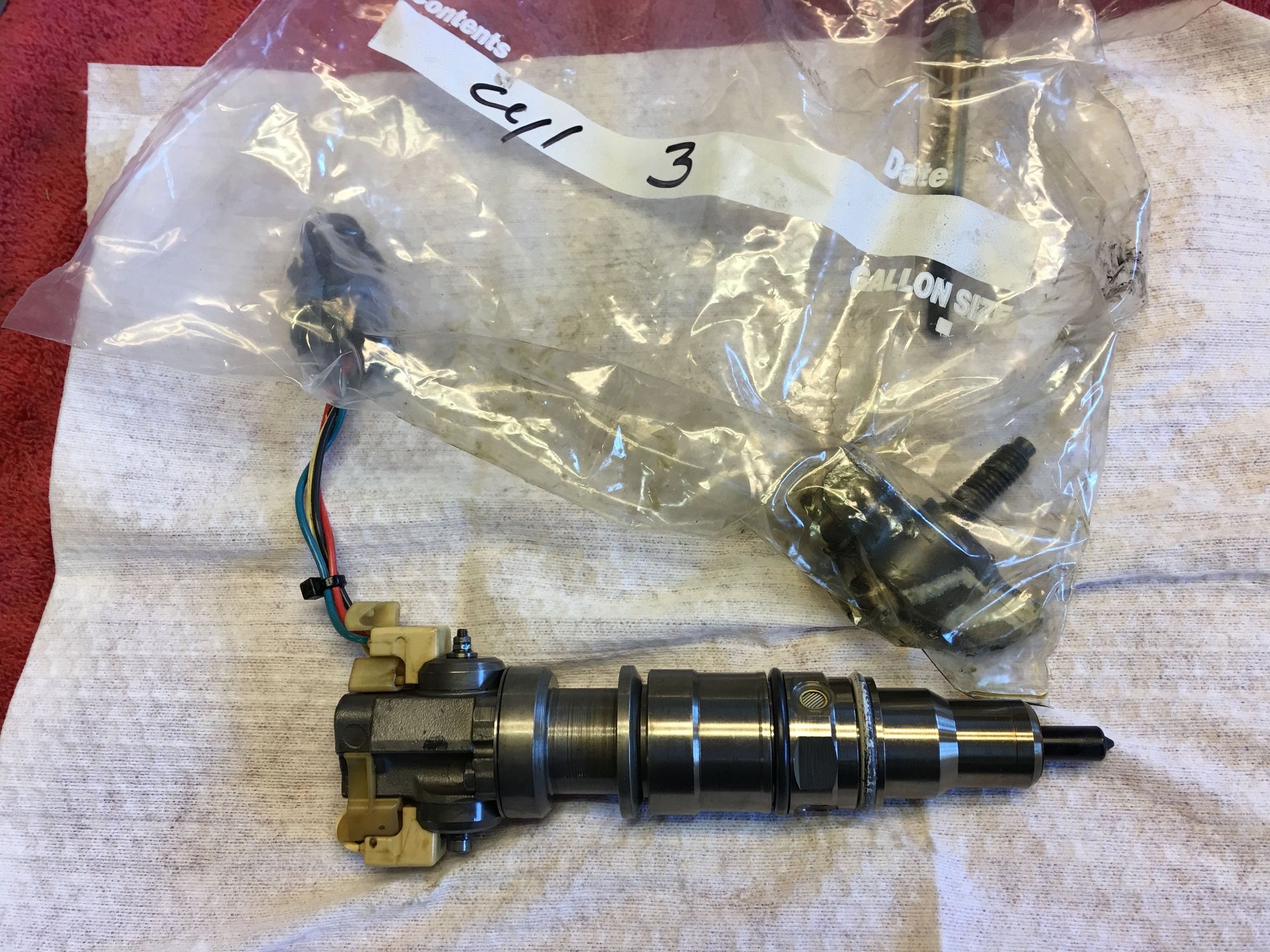

I just pulled this from the parts box. Here is how mine came out of the head after 75k miles.
If I need to do anything with the o-ring groove it will be with a soft brass brush.
What the sealing surface of the injector looked like protected by the copper washer.
My cleaning that surface with a soft 96 ScotchBrite pad lightly.

I just don't like the bluing in the nozzle area I am seeing in that last photo.
