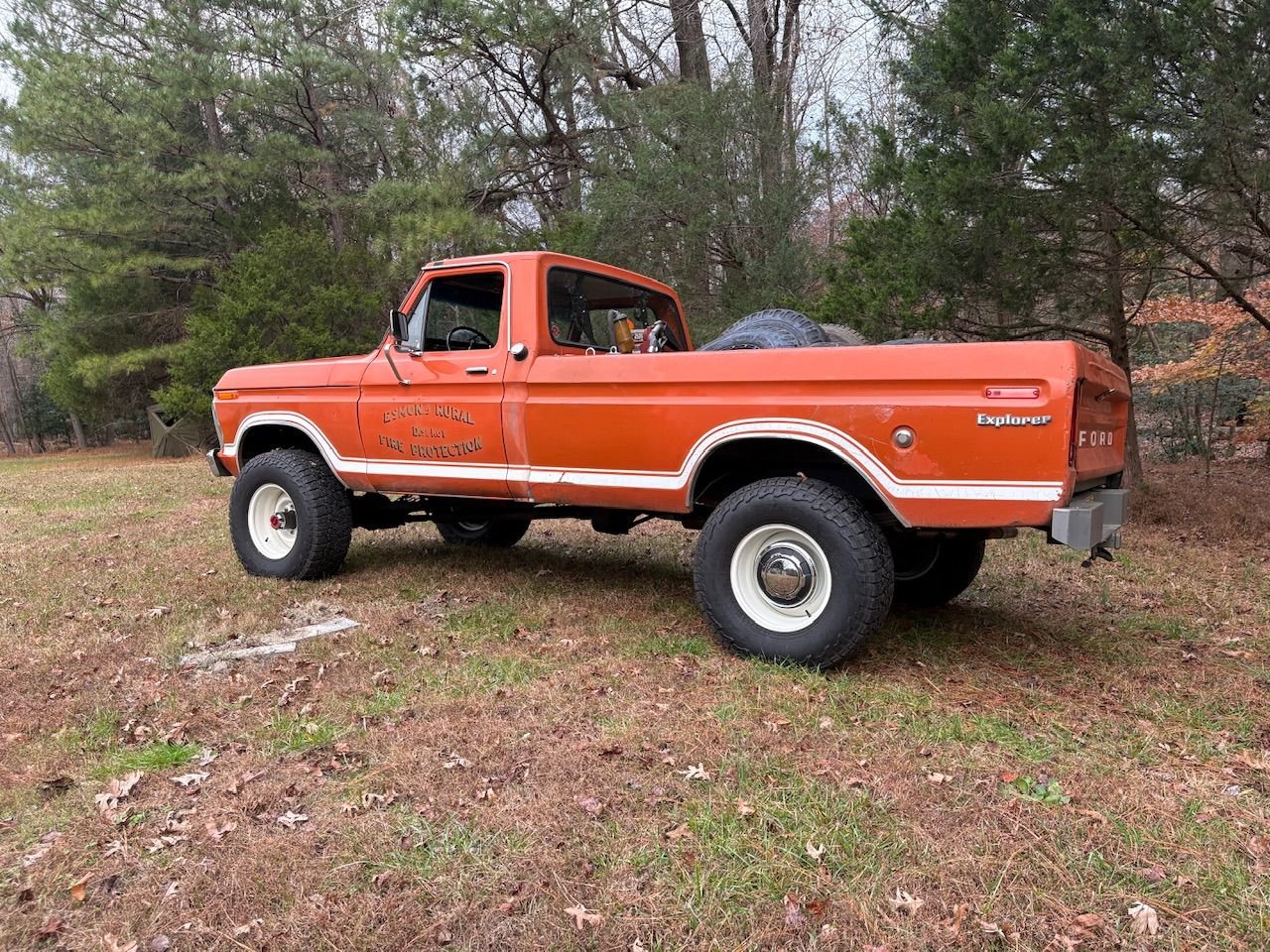

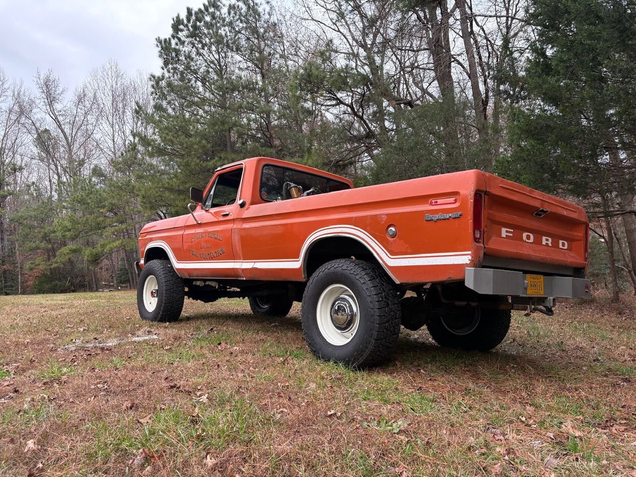

Swapping wheels and tires around again. I finally installed disc brakes and power steering on my 68. I dig this setup so far, picked up some kick on chrome from summit. Still need to cut hole in front caps for the lockouts. I also installed a pair of or spicer hubs I picked up a while back.

Looks good, how do you like the tires?
They are used Falkens off of my dad's raptor, they ride good but made some noise. Not really a problem on this truck.

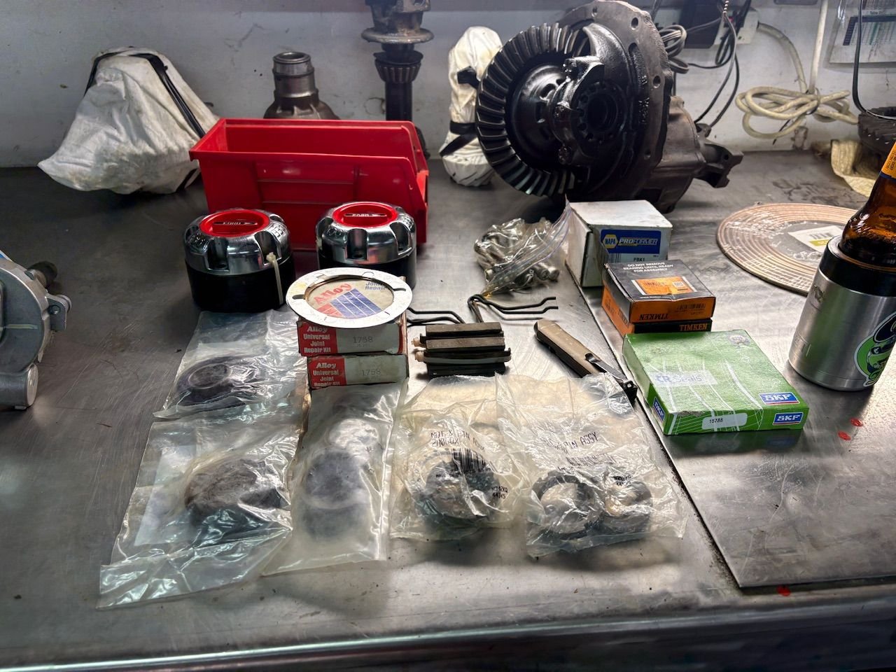

Found local guy with lots of high boy parts that he collected over the years. Was able to pickup two axles and lots of parts.

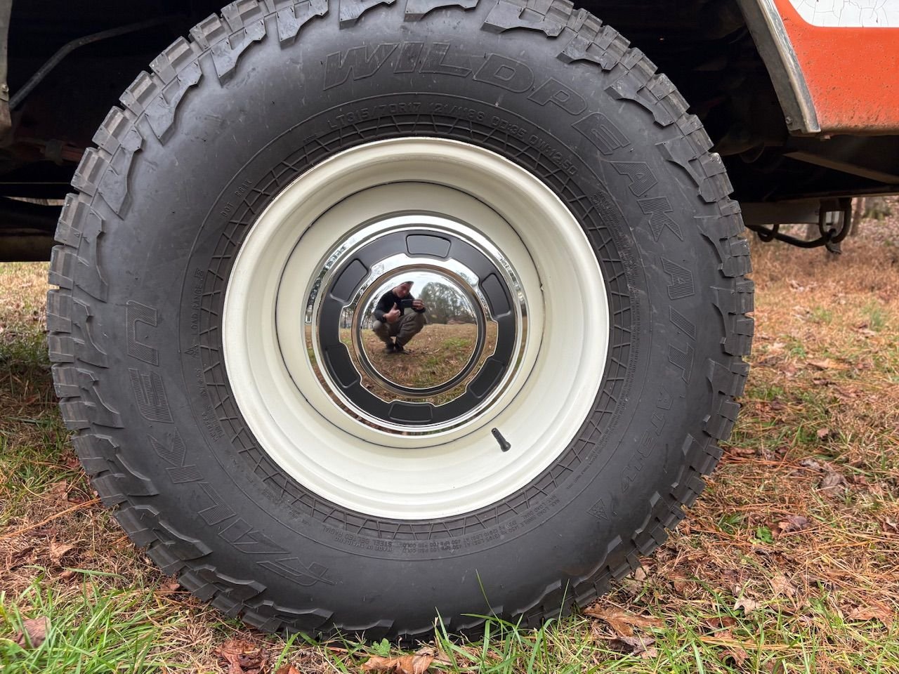

Cut holes in caps for the front, 4 1/2 hole saw

You did an awesome job cutting the caps from far away. Can we get a close up pic?

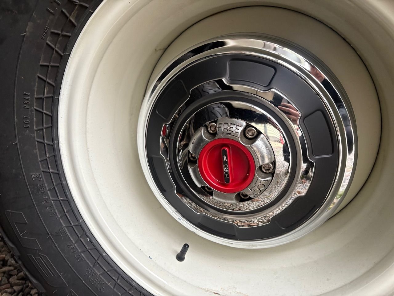

I installed caps on rear axle and ran the truck on jack stands to find center of cap with marker. Drilled a small pilot hole and used hole saw in drill press and a 6x6 block of wood.

It looks awesome. Good job.

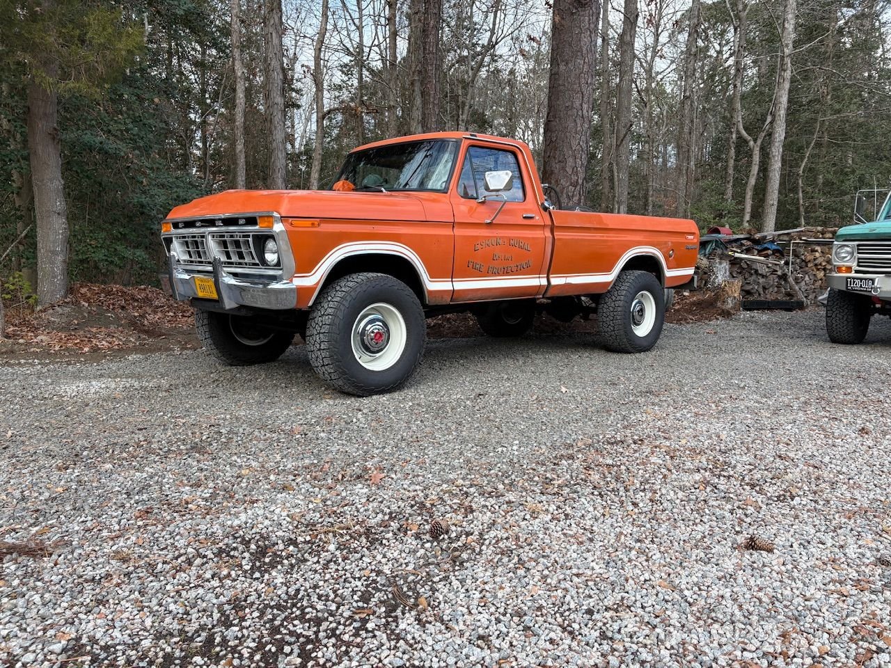

I might have an addiction, I try to stay off market place. My latest market place find.
