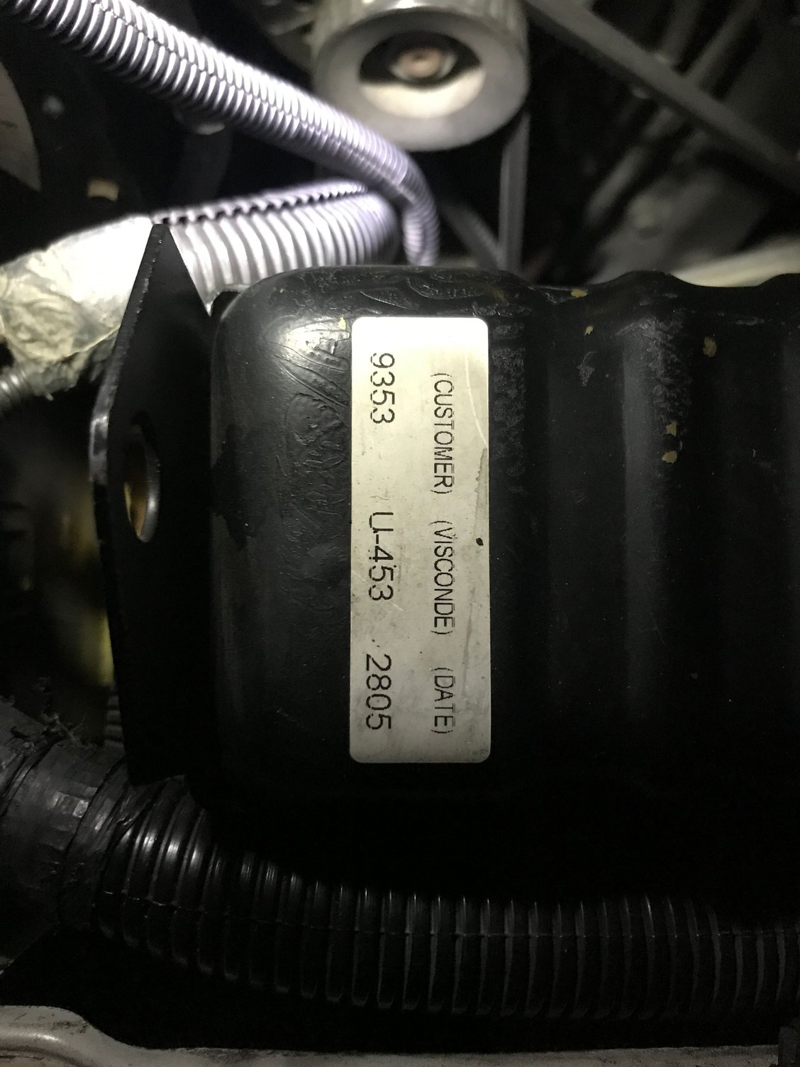

i think its not the original Radiator. Date on it 2005
