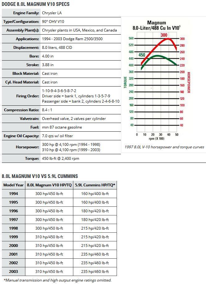

I hoped for more, but the curve does look real nice. Here is the competition for comparison, also a lot of grunt starting at relatively low RPM.

IMO that's a poor graph. It uses two scales, and the lines don't cross at 5252 RPM so you have a little work to do making a straight comparison. It exaggerates the HP graph. HP never exceeds torque for that engine (under 5252 rpm) yet they make it look like HP is soaring. It's not.
