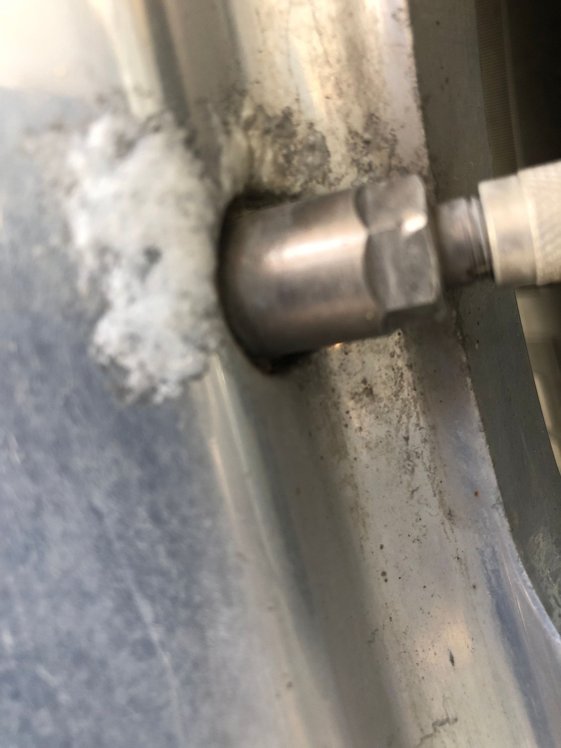

Same here. Wheels corrode from valves. Eventually you will see the white looking corrosion under the clear coat around the hole for the valve stem.

My aluminum outer wheels all look like this at the valve stems on my 18 350 DRW. And they all leak.
