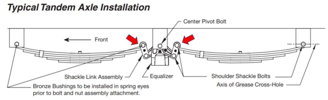

So far, the problem is with the bolts in the shackles. The bolts that hold the spring to the hanger bracket at each end are taking grease OK., as are the two fittings in the top of the equalizer (where it attaches to the trailer bracket). As I recall, the problem shackle bolts are going through the leaf spring eye, not the equalizer. I suspect that this points to my bushings being out of round and blocking the output hole. However, I think that one of shackles is blocked on the bottom bolt, not the top.
Dexter's reasoning for aligning the bolts such that the grease outlet is not at the top is a bit puzzling to me. On the one hand, horizontal alignment should ensure that the hole isn't blocked due to pressure. On the other hand, don't you want grease at the top where all the weight and friction is?
For clarity, I put red arrows in the picture to show where the bolts are that aren't taking grease. This is on the curb side of the trailer. The street side I'm not sure about because I broke a zerk fitting off.
